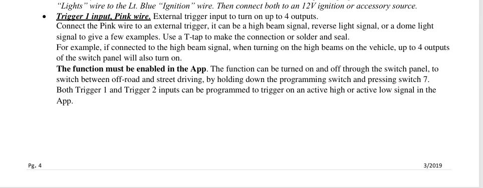

Can you use this feature to do what you need? Hook up the pink to the OEM low beam wire and then use the brights on or off function to switch your bumper, A-pillar, and light bar off when you toggle from high beam to low beam to not blind oncoming traffic? Or reverse it. When the high beams are on, it triggers 3 switch outputs in the SP. Or am I missing that it won't turn them off? (didn't read that far yet)

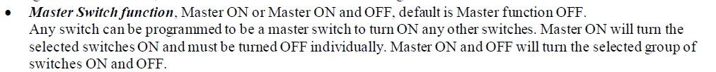

It works as I've described. Here's the blurb from the manual:
So, if I set a switch up to be a master for three light switches, my options are:
  1. Master ON - pressing it will turn all three on, and I have to turn them off individually. This defeats the purpose of having a single switch to quickly turn them off so as not to blind the oncoming vehicle.
  2. Master ON and OFF - pressing it once will turn all three on, and pressing it again will turn all three off. If I'm driving with two of the three on, and I want to quickly turn them off, pressing the master once will turn the third on, and then I have to press it a second time to turn them all off. That means I really blind oncoming traffic in the interim between the first and second button presses. That's probably quicker than individually turning the two off, but I could foresee accidentally pressing the master one too many times on a rough road, and by then, the oncoming driver is pissed off...
As I read it, the trigger input option has the same restriction - all on and all off, rather than any two of my choosing. Really, the problem only occurs because I have more than two sets of forward-facing lights. I haven't figured a way to do it with their current scheme. Granted, the scenario I'm describing is very unique and I really don't know how often I'll use it. It's the only downside I've found with replacing my switches/relays with the SwitchPro. I'm mainly venting that it seems a simple programming update, and they were not very interested in adding that functionality when I discussed it with them.
