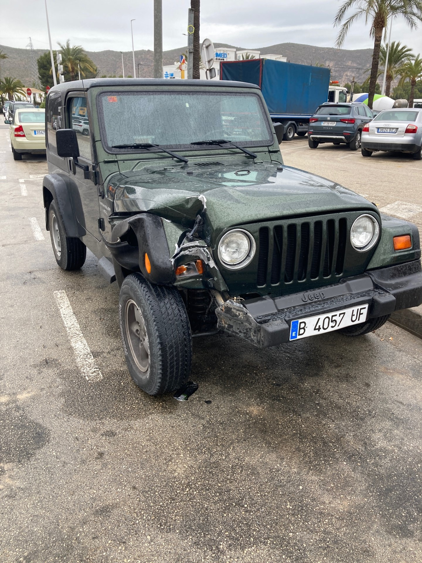

Was driving up to my parents, and coming off a slip road from the motorway onto a roundabout which was clear so didn't slow as much as usual when the steering completely locked up and the brakes didn't seem to work as well expected either.
Went straight into a lamppost which luckily stopped me going down a verge and back onto the motorway! Brain didn't process going to the handbrake sadly, but must've all happened in only around 5 seconds from no steering to hitting lamppost.

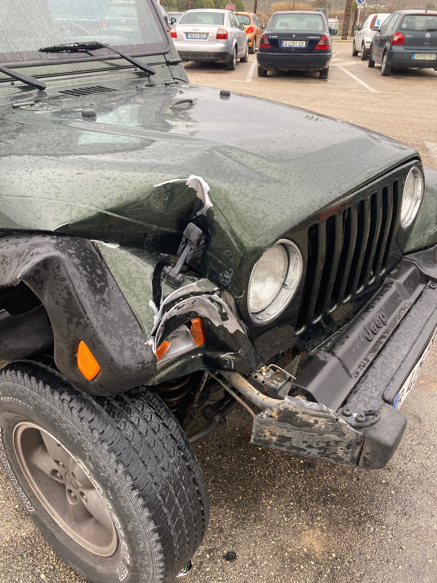

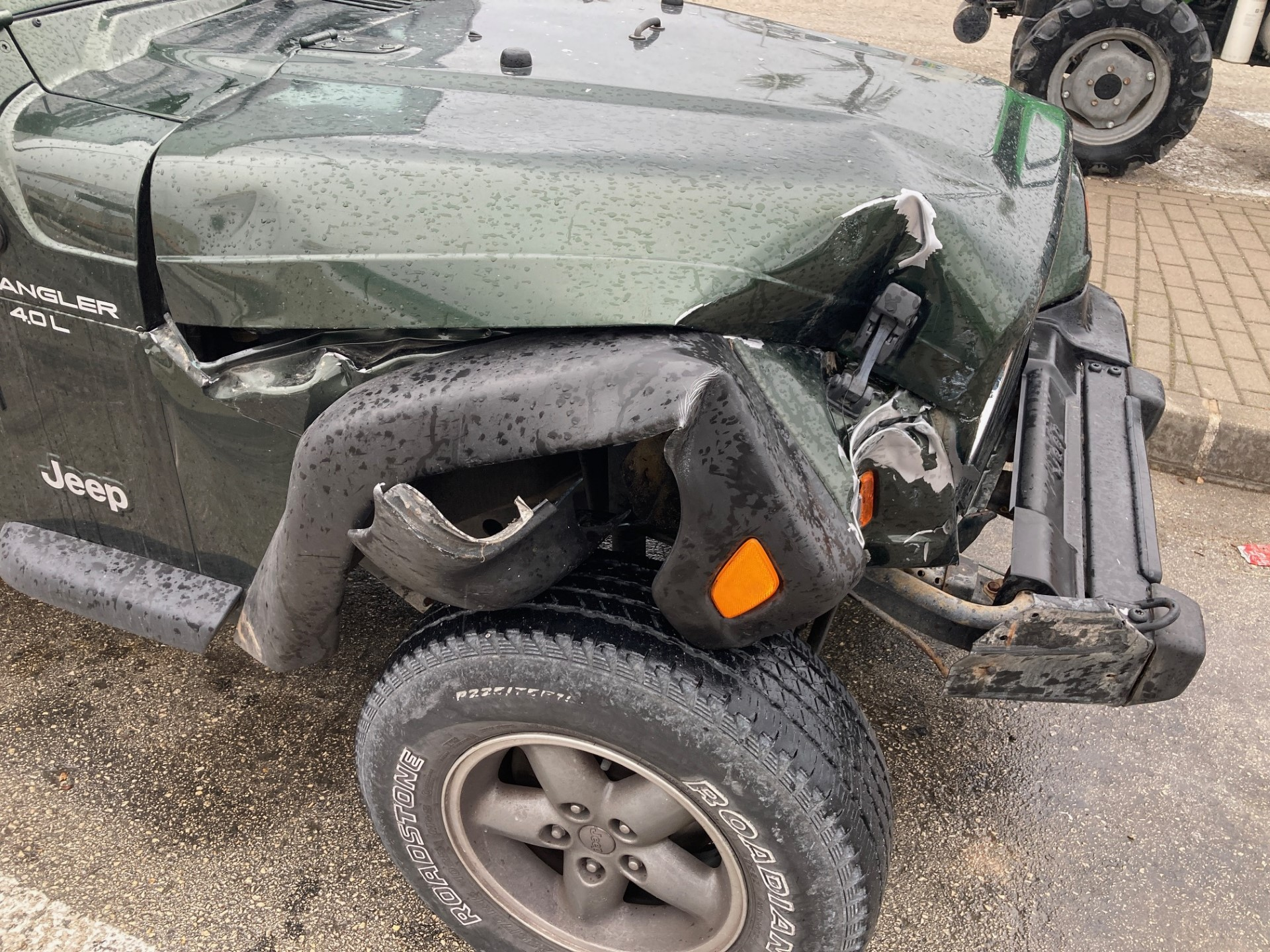

Front of the Jeep is a bit of a mess, but luckily the axle seems ok, so am hoping it's just a new bonnet/fender. The grill *might* be ok and straighten out. Radiator probably needs replacing and then whatever else needs putting back.
Luckily my wife was following behind so wasn't in the car with me, and my only injury is from jarring my leg as it was slamming onto the brake pedal during the impact. Think she was more shook up than me because must be horrible to watch that happening!
Also luckily it was only a few miles from a local industrial estate with multiple garages and a Jeep supplies distribution depot.
Shame about timing really as we're in the process of building a house and so funds are limited. I'll get it repaired, but it would've been a good opportunity to throw in some upgrades/repaint in normal circumstances.

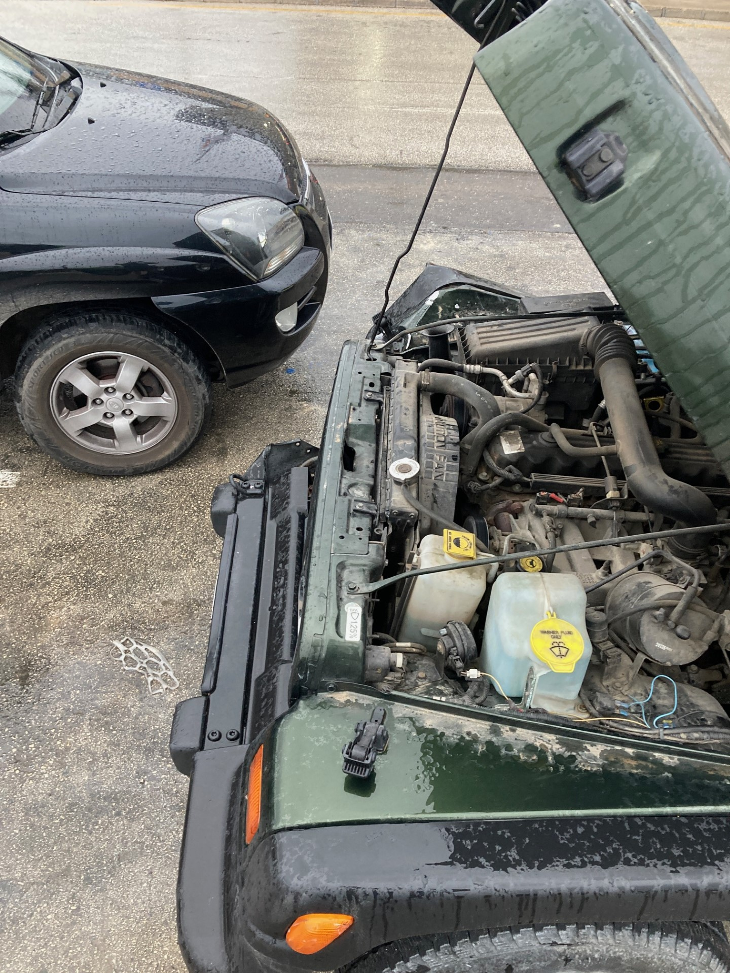

Sorry to hear that and I'm glad you're ok. Did the engine stall and cause the steering and brake issues?
I didn't think so, but it did happen pretty quickly. It's a 3sp automatic so chances of it stalling are virtually impossible i'd have thought. It restarted fine though and then steering and everything worked fine for me to drive it the later few miles.

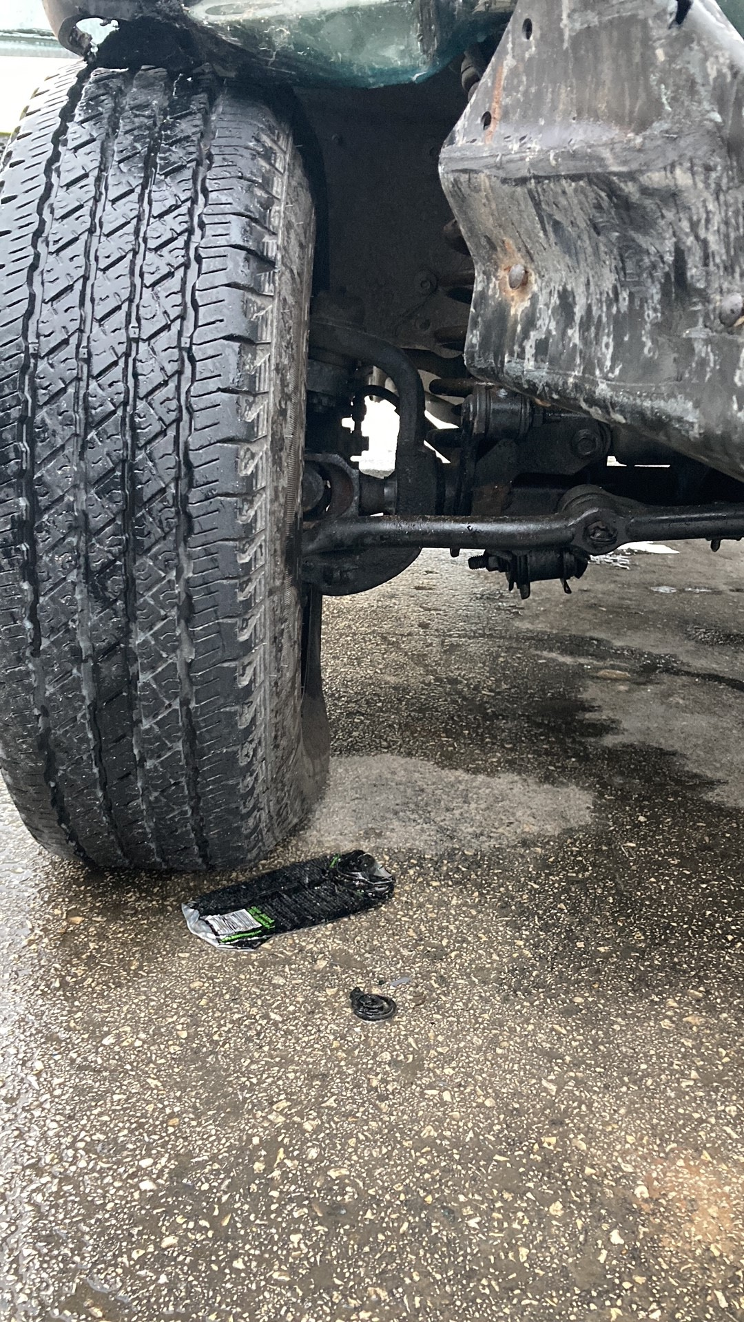

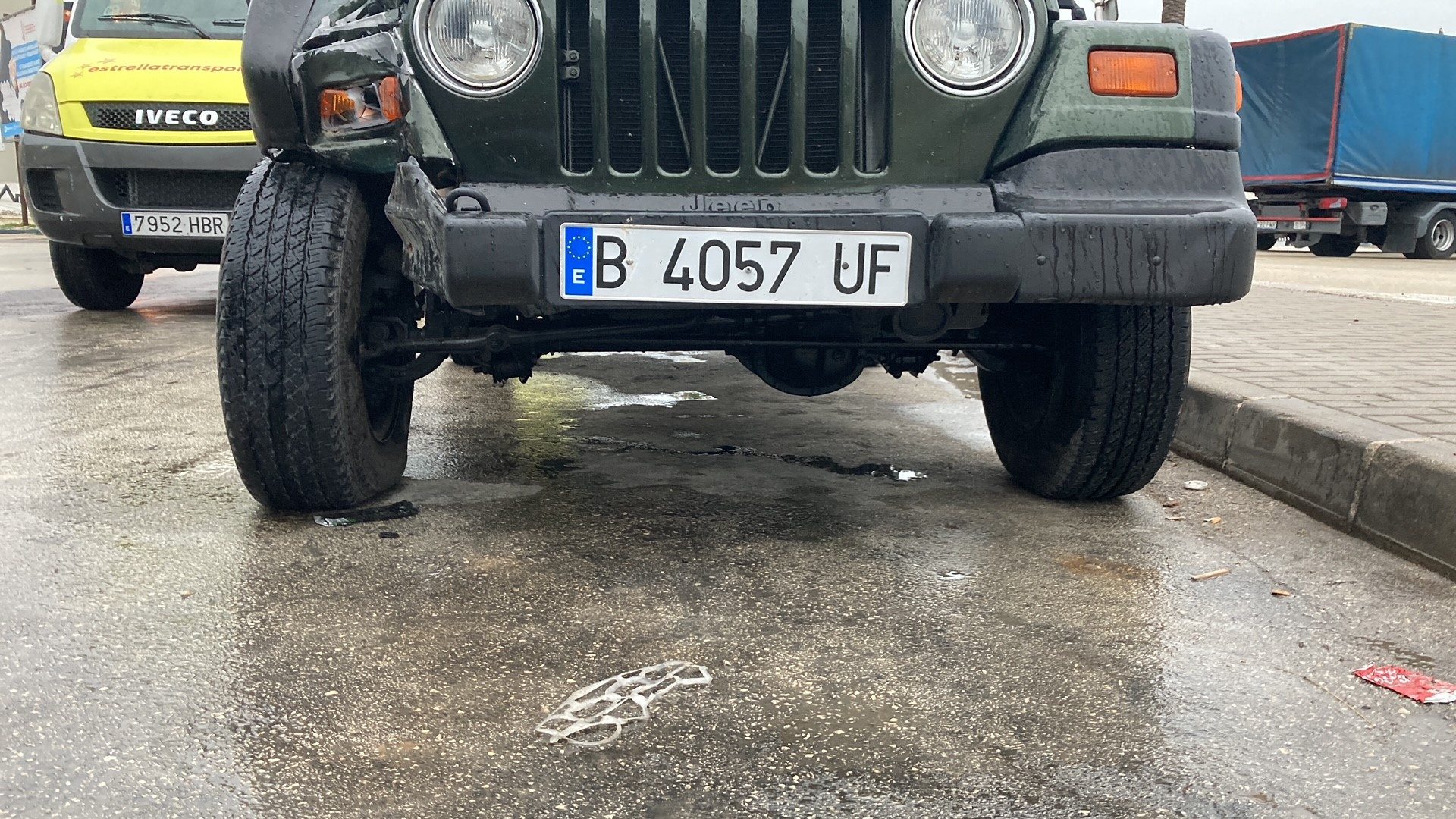

What an odd TJ. It has the charcoal canister that in the US was a 97 only thing but the frame says it is a 98. You'll likely need some new control arms. The impact bent the control arm mount for the lower on the right side so the arm may be compromised as well. I would also give the ball joints, trackbar, and steering links some very intent scrutiny. It would be odd in that sort of an impact for them to not suffer some ill effect.
If you find someone who works on axles and does welding, IRO makes some of the best lower control arm mounts. They don't have slots for cam bolts so they may not be the best option in that regard.
Reactions: macleanflood
Tub looks good. Frame is in question. All fixable.
Yes on the frame but given that it just clipped the end of the front bumper and slid between there and the tire, I "think" the frame missed being highly damaged. The lack of wrinkles where the fender bolts to the tub is very surprising since most any front end collision tends to ruin the tub right there.

I think the control arm was always bent, the left one certainly was before it was fixed around December. Although whether the garage only "bent" it back could potentially account for the failure.
