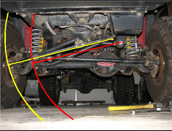

It's not that you want anything level with the ground, you want the operating planes of the drag link and track bar parallel. And due to bends in the track bar, it can confuse people on whether it's parallel to the drag link or not.
What needs to be parallel are the imaginary lines between the mounting points of the track bar and the mounting points of the drag link. Like if you tied a pair of red and yellow strings between their mounting points, would those strings be parallel? Bends in the track bar don't affect it.
Like this...
