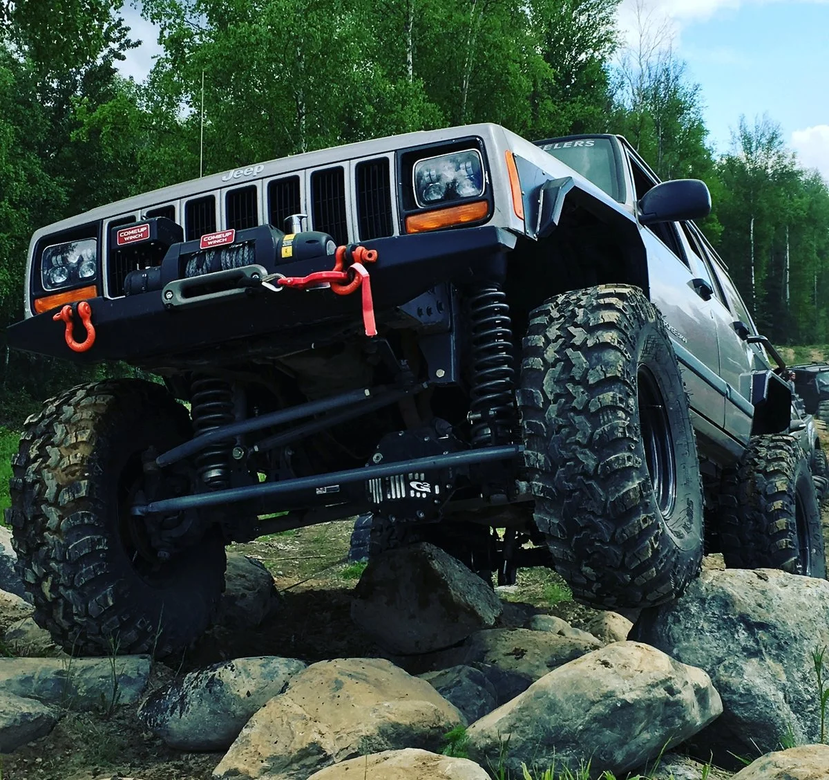

If you are trying to stretch the wheelbase is much easier to stretch the rear. My arms are adjusted to allow clearance with the Currie steering and a standard trackbar. I’m on 37” tires and no contact with the rear of my Genright fenders. I can post a few pics tomorrow. I will be stretching my wheelbase up front but that is requiring a kit similar to TNT off-roads kit. It won’t be for a few months and it will be 3 linked at that time also. I am 4 linked and stretched 5” in the rear already. Not sure why you are insisting on pushing the front out that far if you are making it all contact. Move it back just a little and all is well with what you currently have.
What steering are you using on that xj? Wj knuckles?
Actually, I just put this axle back where the factory one was before I started this whole project. I assumed it would be fine in the factory position. Used a level and plumb bob to find center on the factory one, and put this one in the same spot. Never had that give me issue on other projects. But, hey, learn something new every day. The XJ was running a Teraflex passenger and ended up with a Reid driver. GM 1 ton TREs, 1.5" DOM tie rod/drag link/track bar. Used a TNT frame side bracket, and welded on a Ruff Stuff axle side bracket for the track bar mounts. Threw a couple bends into the mix to clear things. Mainly an off road rig, so no sway bar end link mounts. Was on a 5.5" RE long arm kit, and Ruff Stuff body stiffeners too. Ford 8.8 rear.

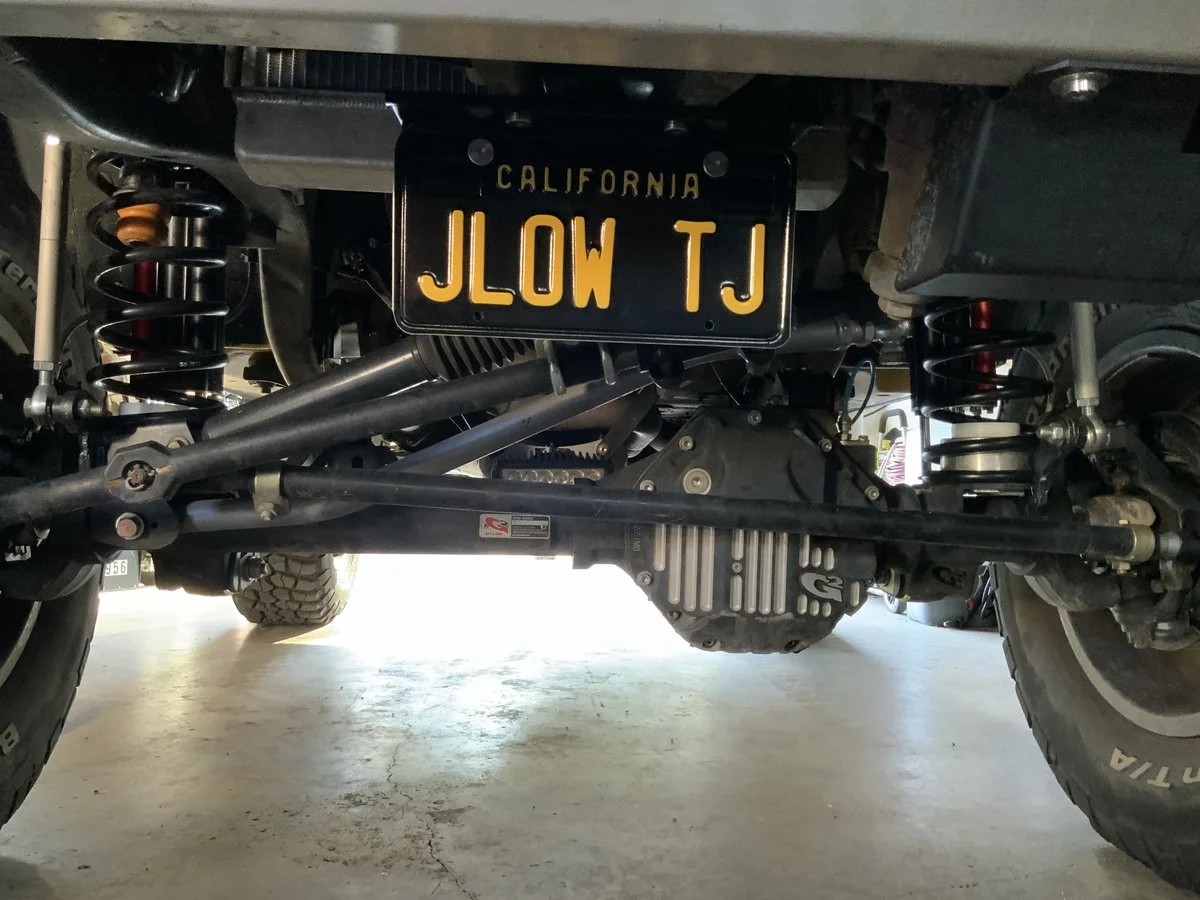

Yeah I replaced a factory rubicon 44 housing with this axle and had to do a small amount of adjusting to my arms for everything to work correctly but over a year later and all is well. I’m currently running Currie/Savvy y link steering but had ORO on it at first.

I believe this is what I’m running up front with my trackbar upper mount. It’s been on there for the last ten years or so. Since I originally put on the long arm kit. I still have that up front. I’m running Genright 4 link stretch in the rear. I used the ORO steering with no problems with bump steer and no stabilizer for at least six years. I liked how I could get new tie rod ends at the local parts stores. I pulled it off recently to put on the Currie steering so I could get my hydro assist fit up.

Similarly, I run a Core 44 assembly with an RE 1600 track bar, Currie Currect-Link steering, 4.5” MC springs, and MC DA Short Arms with no issues. I did have the same issue with the passenger side sway bar mount conflicting at full right but it was minor and I just used a die grinder to clearance it a little.

I did the same with the die grinder. But with the Savvy aluminum tierod and jam nuts vs. the standard Currie clamps I’m not sure it would not have been needed. Very nice set up.

Now that is the info I was looking for. Tell me, does the tie rod ever contact your diff?? How much room is there between them, with the tires straight? If you do not mind measuring, I would be really appreciative
It does not make contact, I’ll get a measurement for you tomorrow. I cycled the suspension to determine the arm lengths. That gave me maximum forward without contact.
