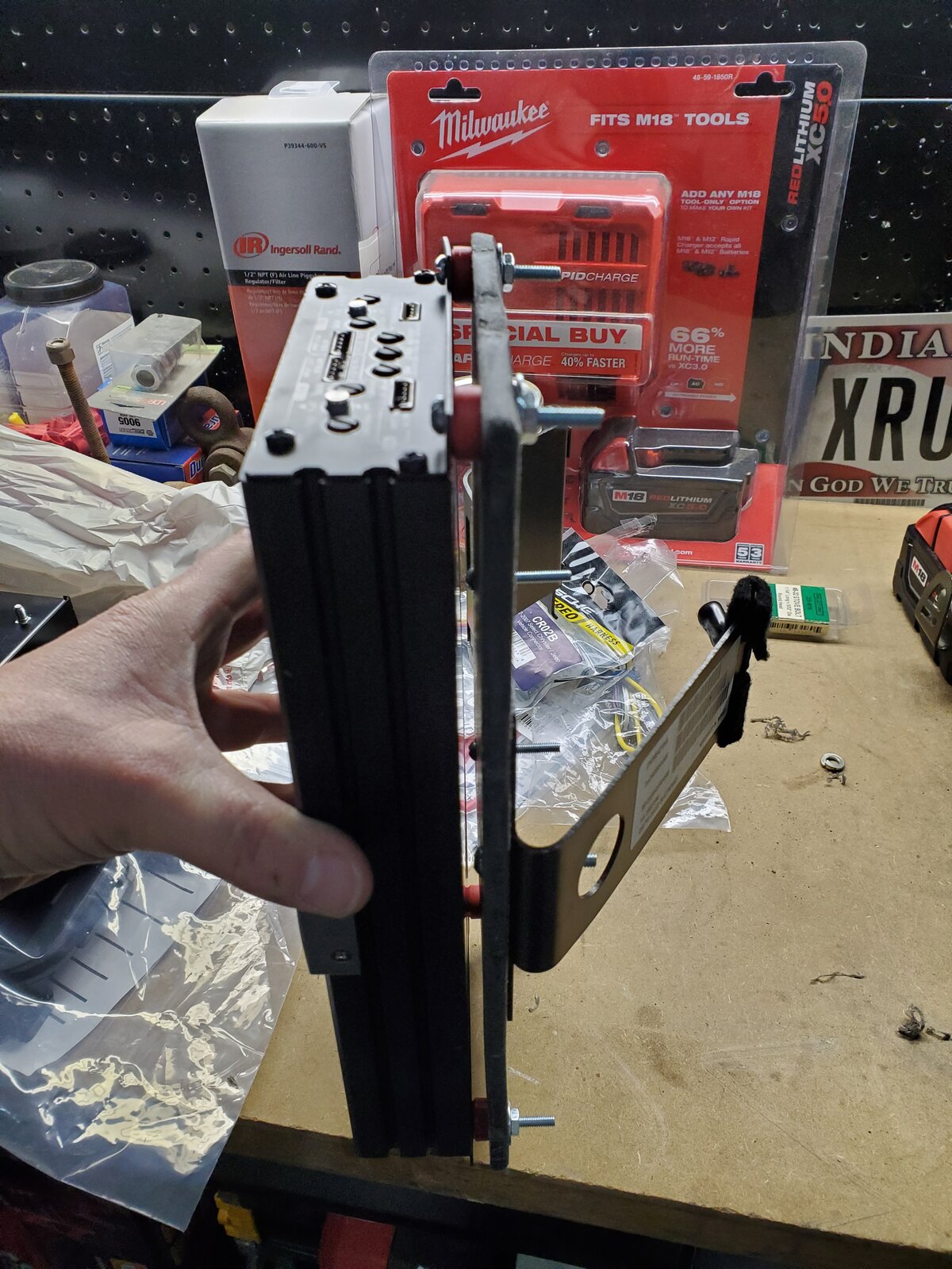

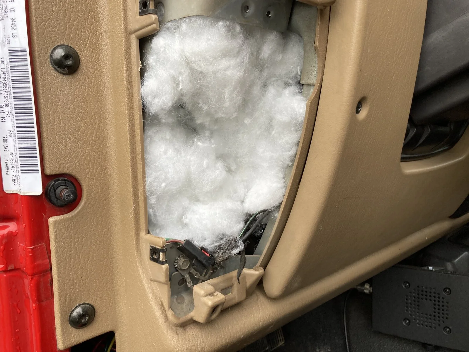

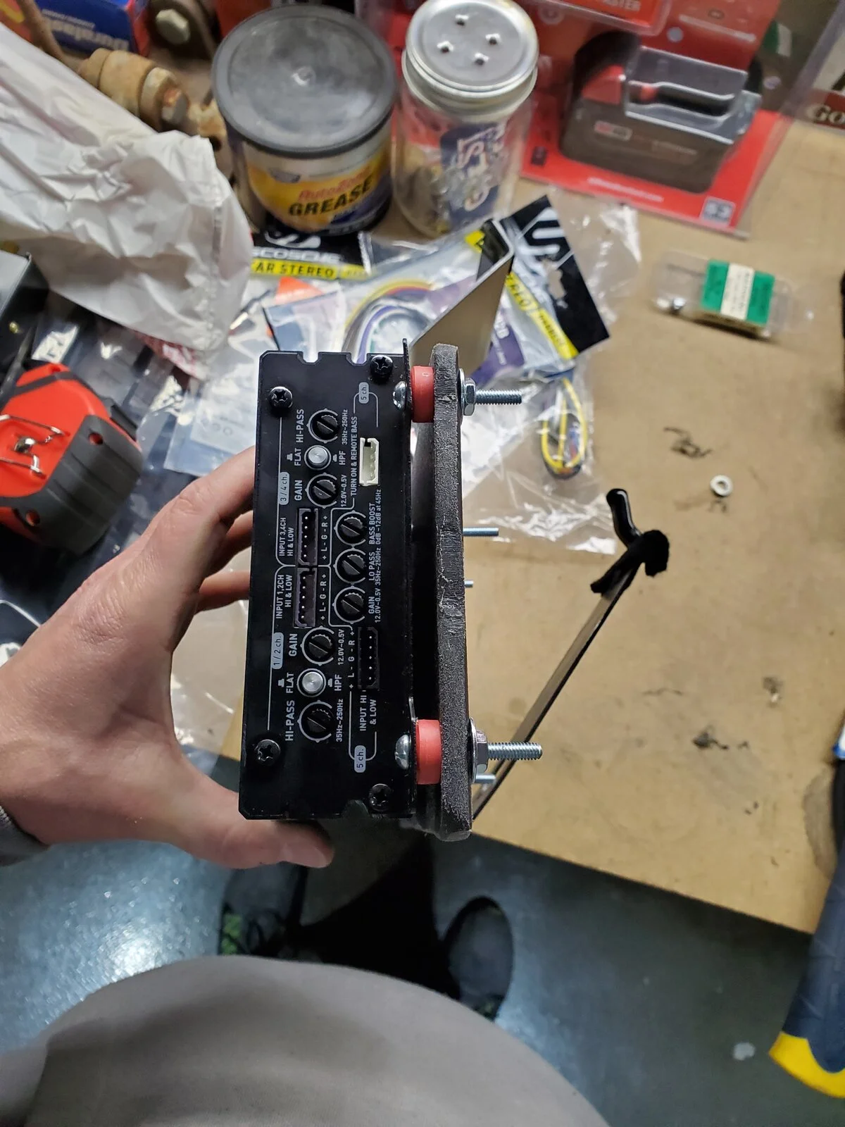

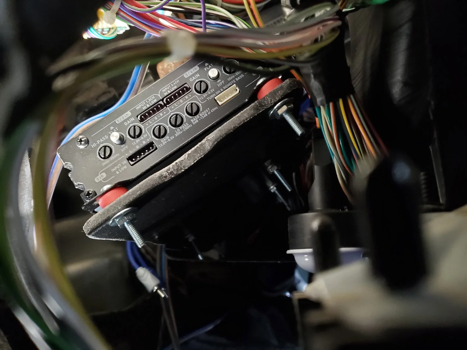

First thing I tackled was where to put the amp! Some on this board suggested under the steering column, so that’s where I started. I ran into an issue where it looked like there was already a small “box” installed on a bracket in that location. I discovered this was a factory installed satellite radio module. I decided to remove the old module and attempt to use the mounting bracket from it for a nice clean install spot. I did use a cutting board with some spacers to allow the amp to “breathe” on all sides.
View attachment 233694 View attachment 233695 View attachment 233696 View attachment 233697
Next I mounted the amp in the factory bracket location under the steering column.
View attachment 233698 View attachment 233699

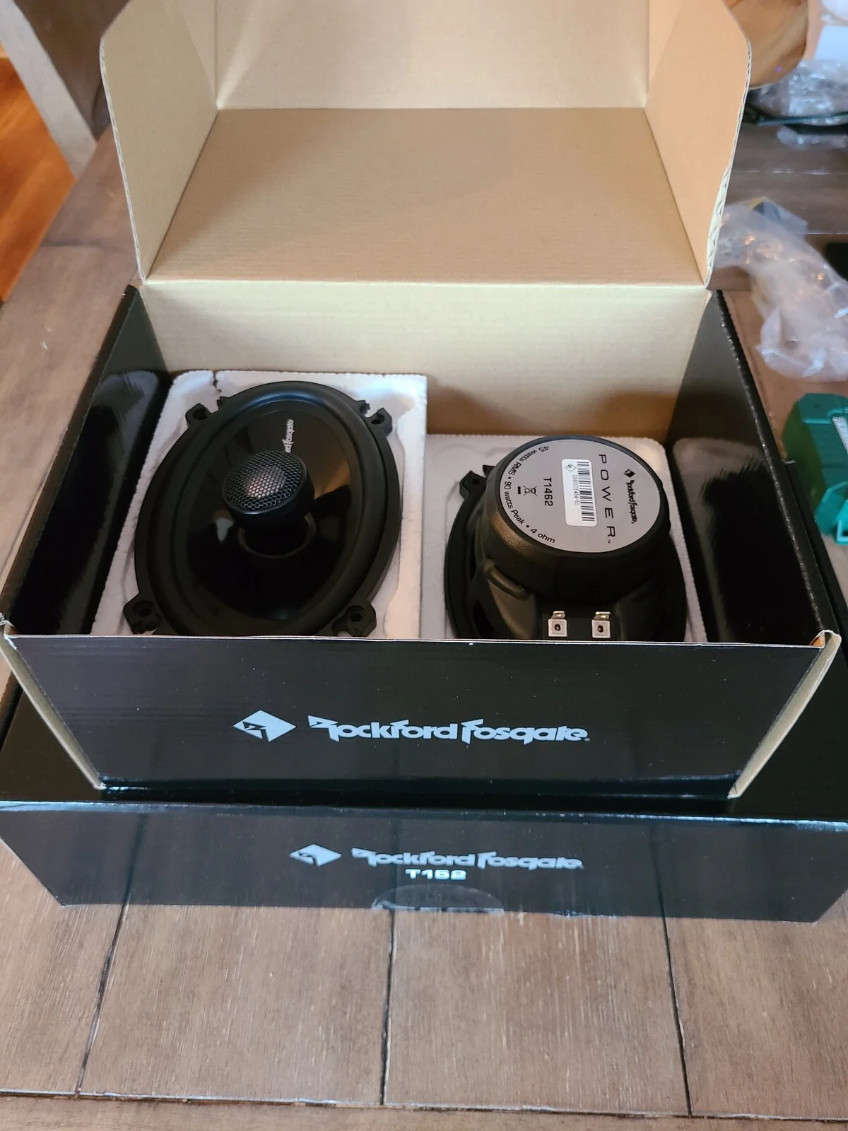

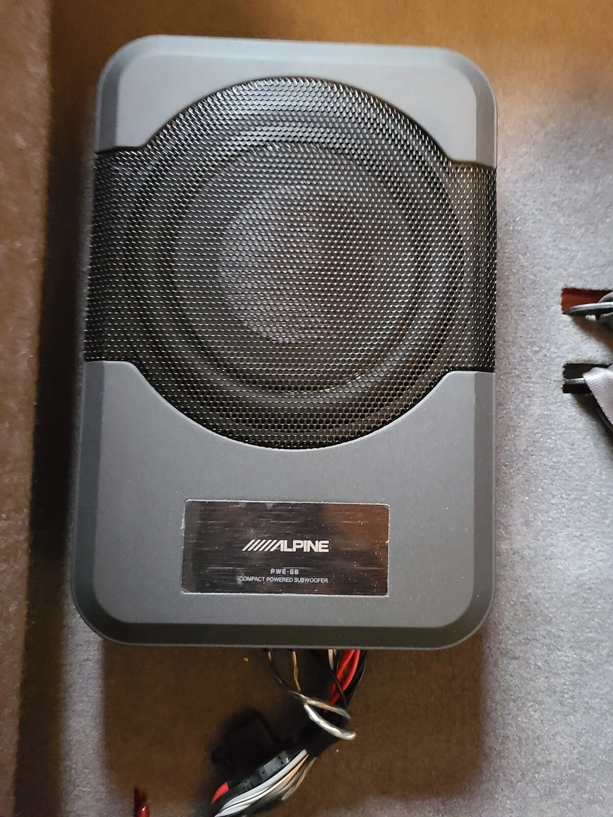

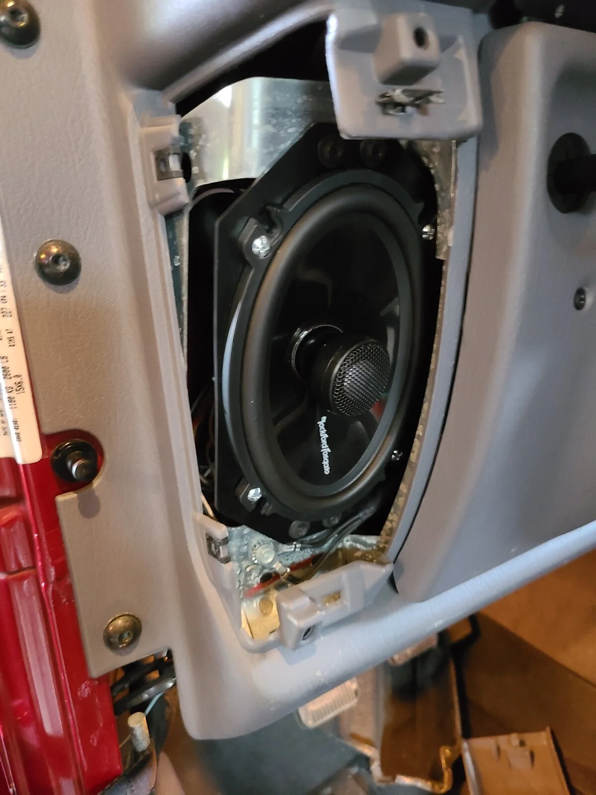

Very nice set up and great pictures. PO installed a Pioneer head unit and a Alpine compact powered sub. He unfortunately stopped there and left the factory speakers in? Just finished this morning adding Rockford Fosgate speakers. What a huge difference, now if it will just warm up here I can go share my Playlist with others.

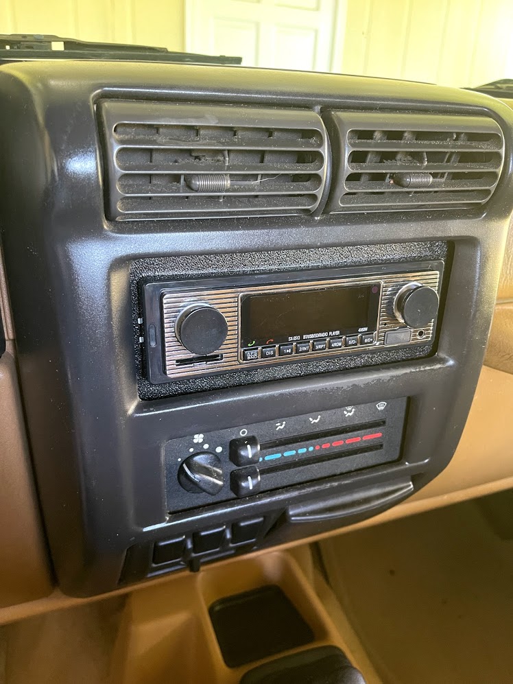

I bought this bad boy for $20 off Amazon 😂
All jokes aside, what's the specs on that? It seems like even cheap crappy radios nowadays have decent output capability. I bought a Dual from walmart for $17 the other day for my wife's car and it claims to have a 50w x4 output. Which totally blows the stock radio out of the water. I figure it will blow the stock 20 year old speakers in very short order. I'd put one in the Jeep, but I don't like that the radio doesn't have a dimmer feature.
It claims 60w x 4.
When I bought the Jeep last week, the aftermarket stereo that was installed stayed on constantly. PO would just remove the faceplate after stopping to turn it off. I assumed he'd accidentally switched the constant hot with the ignition wire. So I knew I was going to need to rewire it, but I also wanted Bluetooth since I don't listen to CDs much these days. Since I was going to have to pull it out anyway, I figured I'd just swap it at the same time for something with BT built in.
Wasn't looking for anything too fancy. I also hate that almost every aftermarket stereo looks like a Winamp Skin from 1999. Tiny buttons, wild faux-futuristic designs. At $20 with a simpler aesthetic, this was hard to pass up. It probably won't last long. It feels cheap and the minimal instructions were in broken English. But at $20 if I only get like a year out of it I don't care too much.
Oh and it also doesn't have a dimmer. Only driven at night once with it installed, but it wasn't too bright.
