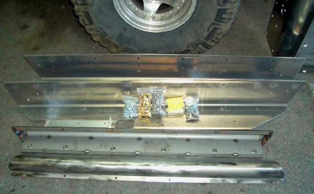

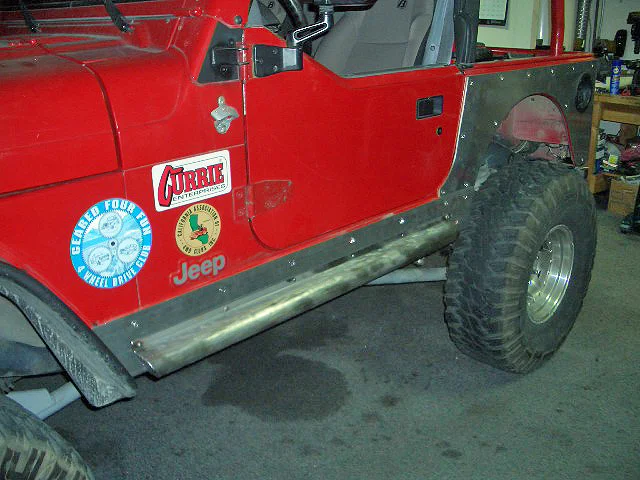

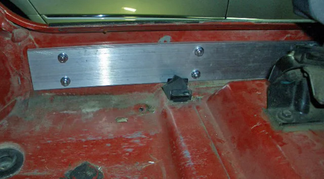

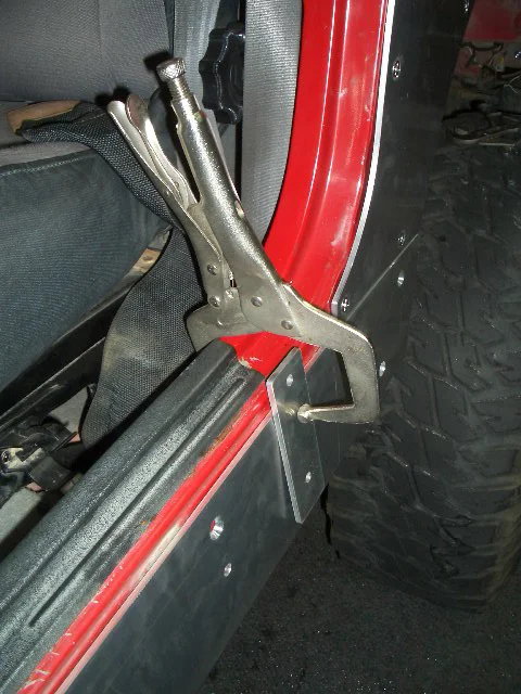

Having severely damaged two different sliders, one of which actually allowed the body to get wrinkled underneath, the only slider I have found that gives absolute protection is Savvy's 3-part design. It uses two heavy aluminum pieces to sandwich the tub to which a heavy steel slider is bolted to. Too bad they're currently on backorder but you can see them at https://savvyoffroad.com/product/rkr-kit/
And as above, tub-mounted is by far the strongest possible way to go. Frame mounted may sound stronger but it's definitely not even close.
Here are a few pics of their install on my first TJ and I'm still running them on my current TJ...
Having severely damaged two different sliders, one of which actually allowed the body to get wrinkled underneath, the only slider I have found that gives absolute protection s Savvy's 3-part design. It uses two heavy aluminum pieces to sandwich the tub to which a heavy steel slider is bolted to. Too bad they're currently on backorder but you can see them at https://savvyoffroad.com/product/rkr-kit/
