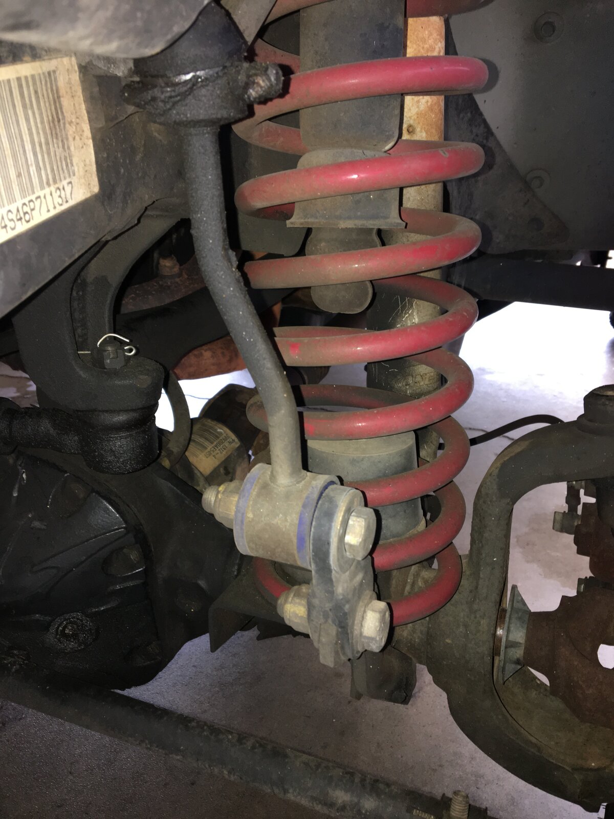

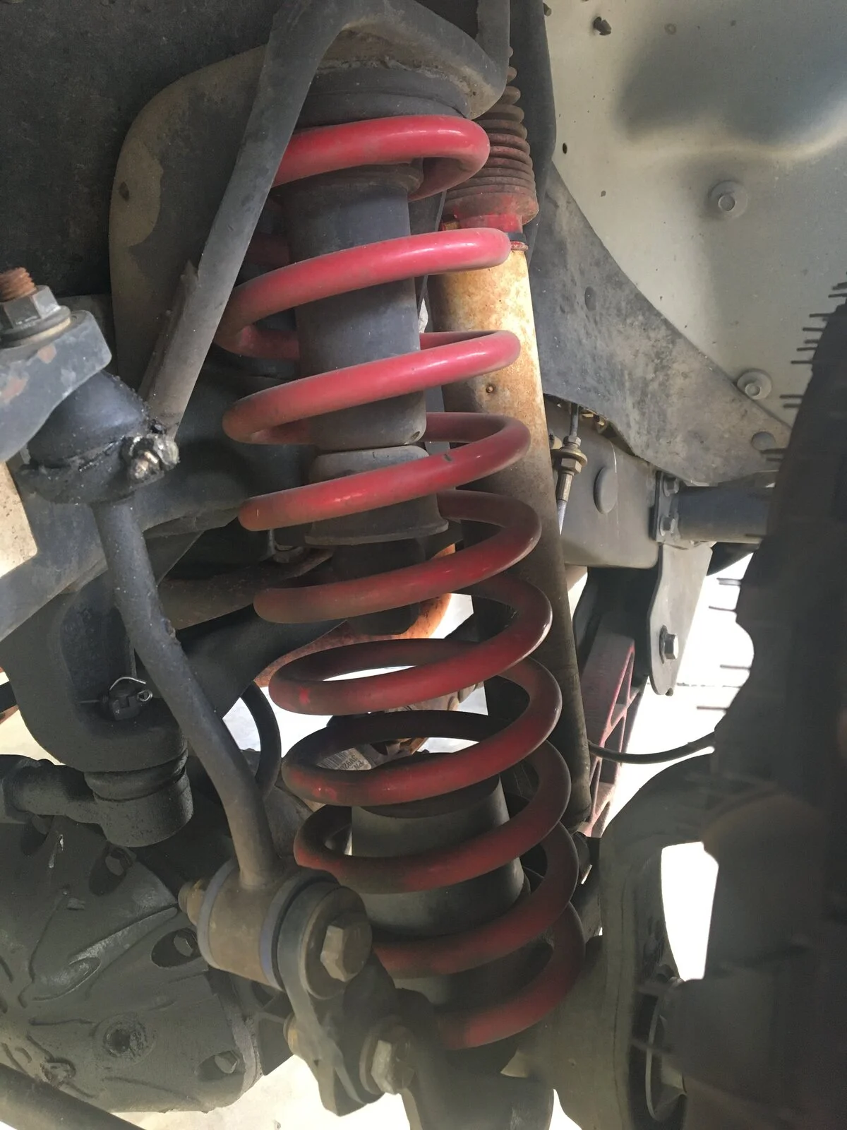

Thinking about getting quick disconnects. Looking at what I have currently, I wonder what this set up is? Some kind of complete aftermarket kit or did the PO install the extra link to compensate for the lift? Or is this stock? With a lift I think it isn’t stock, but I really don’t know. Next, any preferences on brand of disconnects to replace whatever it is I have?
That looks like a poor man's sway bar link extension..I use the rubicon express adjustible links but honestly they all do the same thing until you step up to a sway loc or anti rock
Unbolt the bar a few times at the trail head and zip tie it up. If you think it's worth the effort then get disconnects. If not then leave it connected. Most disconnects wear out pretty fast, faster than stock links. I know people that have worn out disconnects and never even used them. Disconnects are there to save you time but if you only use them once or twice it's hardly worth it. They have way less value than airing down tires in my opinion and if you spend money on deflators you'll have plenty of time to disconnect while they work. The anti-rock isn't doing it right, that's a dual rate bar which it isn't.
That bottom link would need to come off too if I installed disconnects, right?
Your sway bar should angle slightly up towards the back of the Jeep. If you get something like JKS for 2.5" and up you should be fine with a 3" lift. If for some reason you end up with disconnects for a stock height Jeep there's nothing really wrong with leaving those extensions and using disconnects if everything clears.

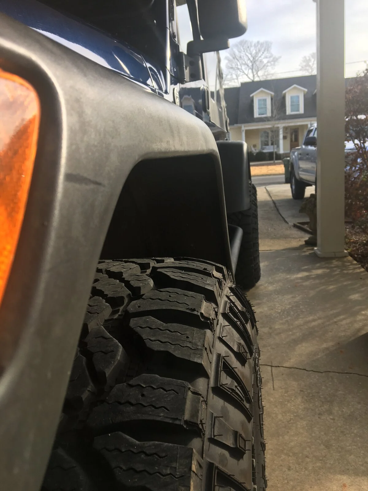

Sorry for the follow up questions, but I’m just trying to understand what I have. Talking about the disconnects got me to looking at my bump stops. See pics please.
So, even if the sway bar is disconnected, the up travel (and I’m assuming this directly limits the down travel on the other side), is limited by the bump stops. In the pic, that doesn’t look like a lot of travel. Maybe it is, I don’t know. And as mentioned, the shock comes into play somehow.
Now looking at the pic of the tire/fender flare…are the bump stops set so the tire doesn’t rub the flare when flexed? It looks like the bump stops will engage and leave about 1-2 inches of clearance between the tire and fender. Am I understanding this correctly?
If so, even with the sway bar disconnected, I’m limited by the bump stops. If that is due to the flares, to gain more travel I would need to swap flares, correct? Then reduce the length of the bump stops to allow the extra travel.
Everything was done by the PO. Again, just trying to learn so I can make informed decisions.
