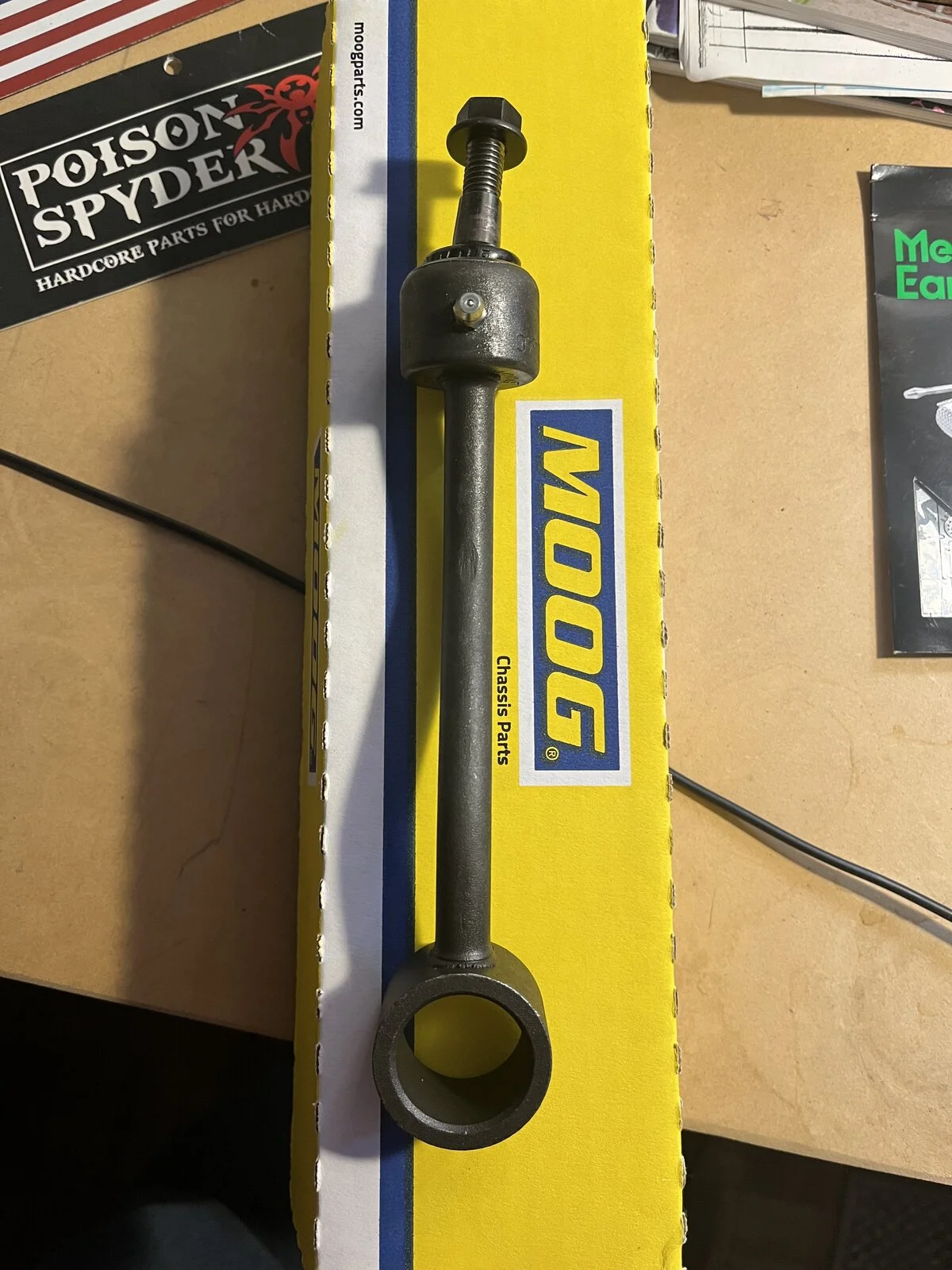

Pulling a holy thread revival. Anyone else order these MOOG parts and have them not fit? 2006 LJ. Taper is way to big.
Never had that issue..can you post a pic of the taper on the link and another of the taper on the sway bar please?
They fit my 06 fine. P/N K3197
Dear friends of TJ forum:
You Are Dumb Patrick Star GIF by SpongeBob SquarePants
They fit perfectly fine if you aren't a complete dial tone and are installing them from the correct side of the sway bar.
I had the bar pointed downward to beat the old links out with a pickle fork. From there I didn't bother moving the bar back up to its normal position and was attempting to stab them in from the top side of the bar. A real beans above the frank situation.
Me dumb. I'll go delete my account now and have a large helping of crow.
