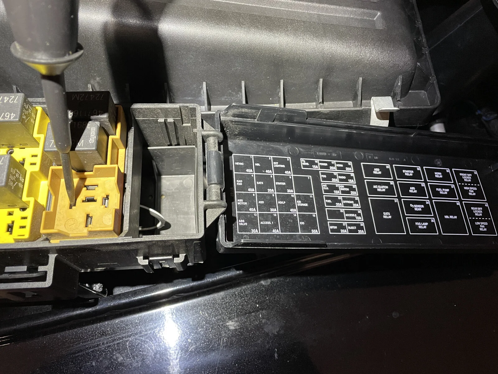

Looking for a convenient switched power source to run a relay (on/off with ignition switch) located in the engine compartment. My initial look at the PDC schematics only turns up the obvious direct battery connections - before I dig in, I figured I'd ask.
I don't run a hard top, so I picked up switched 12v power from the HBL relay location in the PDC.
