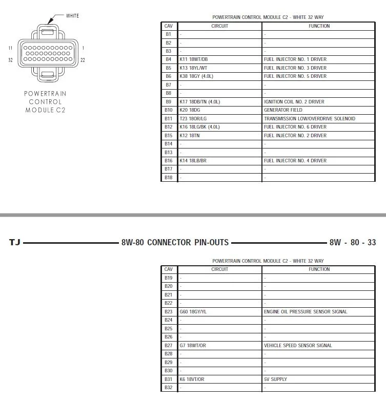

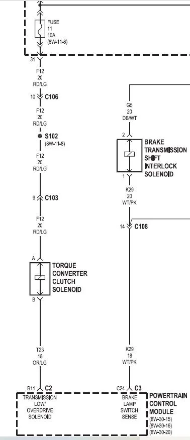

This should be what you need... and pay no attention to where it says Overdrive, it's correct for your 2002.
