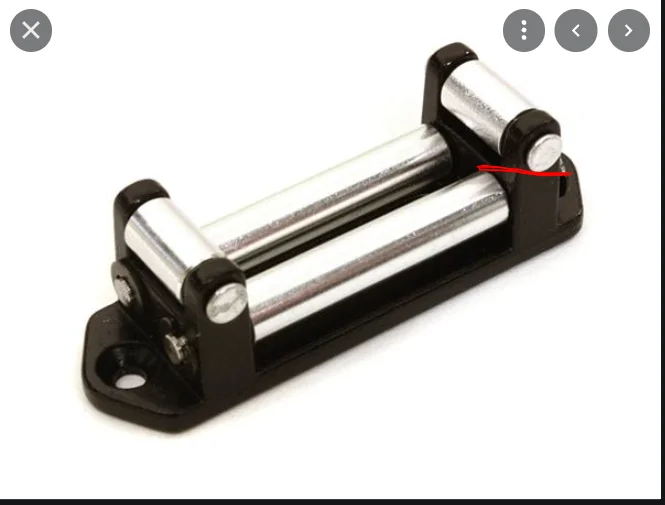

I thought you had to make sure you have a roller fairlead that didn’t let the synthetic rope get pinched in the corners? (And not all rollers were like that.)
Nope, only a poorly designed roller has that issue. Another of those "not all are the same" things. There are some rollers that have the sides too far out which leaves the support tabs more easily gotten into. That came up in a discussion on Jeep Forum many years ago due to some guy who kept cutting his steel cable when it got up in the corners. When it showed a pic, it was pretty obvious that it would do it easily.
Also it isn't pinching. On high angle pulls, the line gets into the corner against the sharp edge of the support tab and that cuts it.
Scale model but shows the problem. There is a lot of exposed tab area that will shred steel or synthetic under load.
This is better where the potential for dragging the line across the edges is reduced.

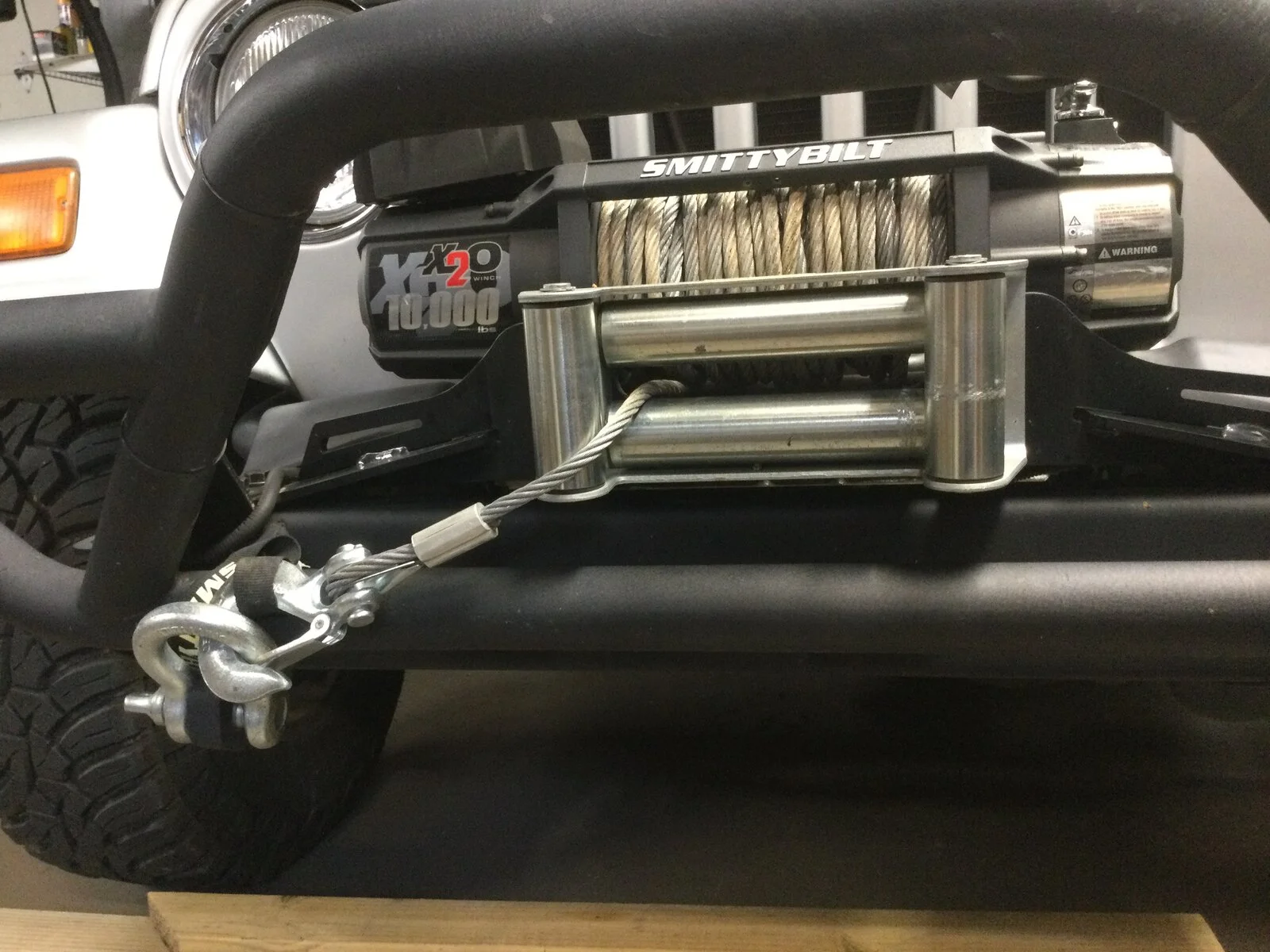

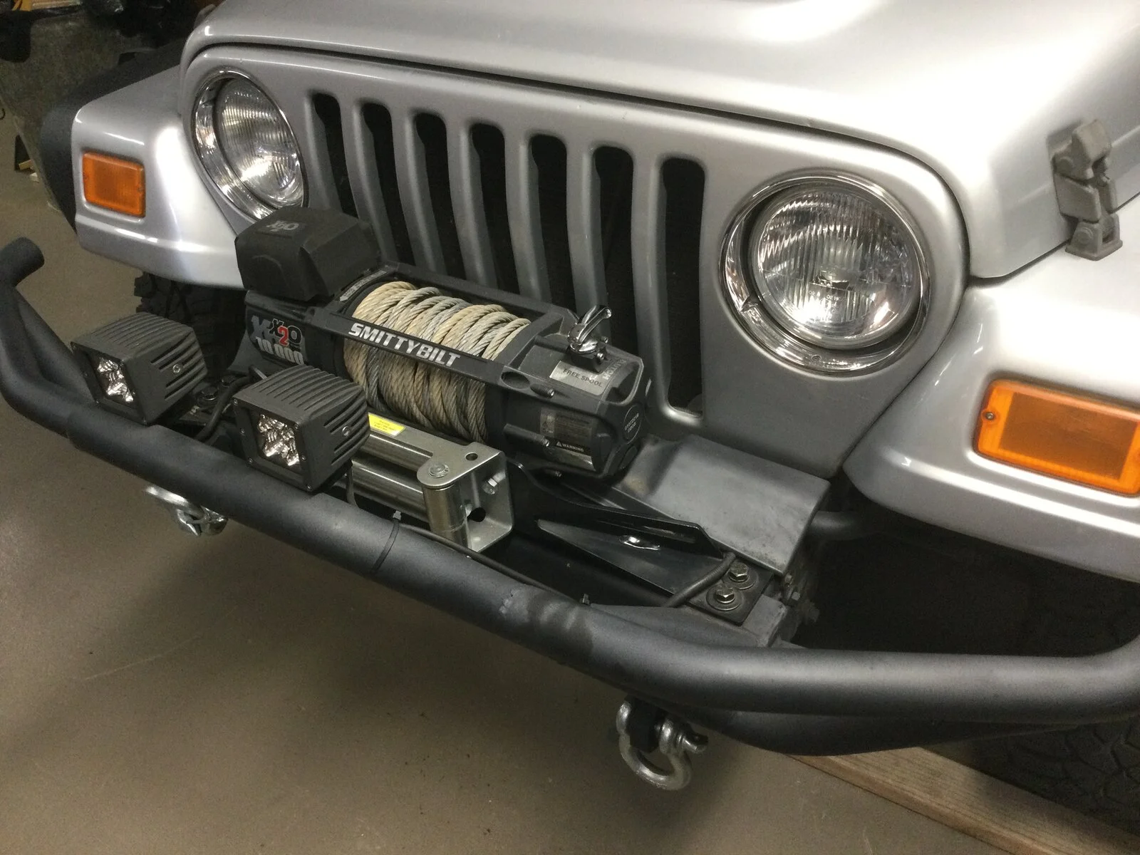

So I’ve got the silver fairlead that’s in mrblaine’s last photo. Currently have. 9500 Smittybilt winch with steel cable. 1) do I put cheap o Amazon rope on it??… 2) 85’ or 100‘ of rope….3) change to a different fair lead?
3) No expert here, but I would not use that since the drivers side is chewed up. That looks like it will damage a synthetic line.
Here’s what it looks like. Picture worth at least 100 words
Since your skin is far more fragile than the synthetic line, simply push against the roller with your hand and roll it with a lot of force. Did you cut yourself on the roller? If the answer is no, synthetic will be fine. If the answer is yes, smooth down the rough bits that did the damage or replace the roller/fairlead.

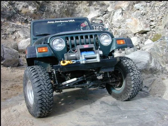

In case it matters- my rig in JV, Oct. of 2000. Or put another way, I've been fucking with this stuff 21 years. How long has Big Foot been in business?
http://www.justaddrocks.com/Johnson_Valley_OHV/images_sh/dscn1691.jpg
