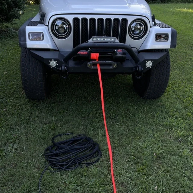

Wow these Jeep shops have gotten expensive in the last 10 years!! $125 to install a $350 rope. I can get ropes online much cheaper and do it myself. I just don't know what size and length for a Smittybuilt 9.500. And I assume you put it on with a good tension like the cable? Thanks, ST
So I have a RC pro series 9500 and I bought a synthetic line from Big Foot Winch Ropes. They recommended 85 feet. In their instructions they recommended you wrap about 4 to 5 wraps around the drum then connect the end to another vehicle or sometime stable and on a slight incline. The street I live on has a slight incline so i just parked my truck at one end and had my wife set in the cab of the Jeep while I reeled in all the line. There are several videos on YouTube about installing your winch line also.
