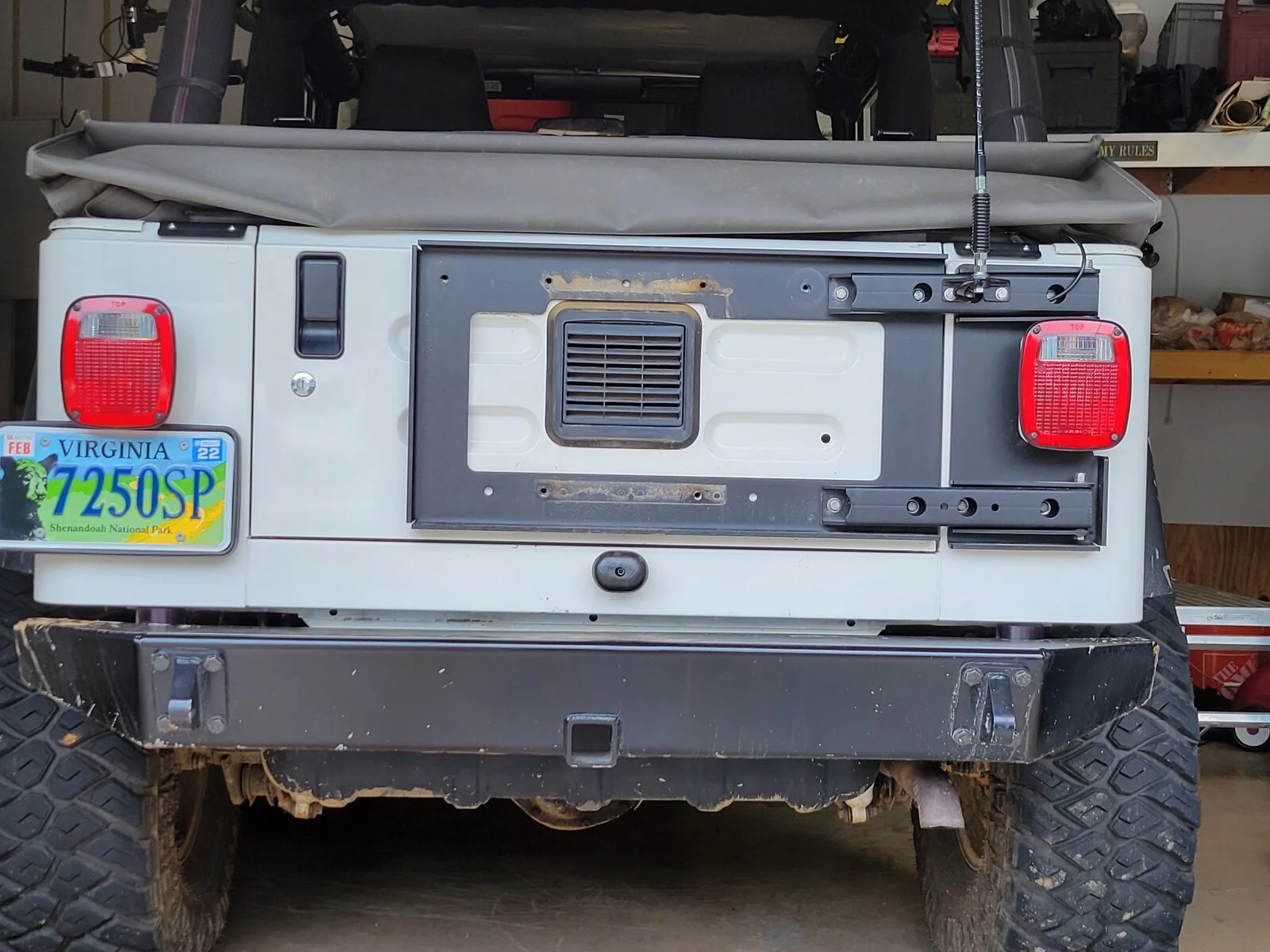

Tailgate loose even with Exogate

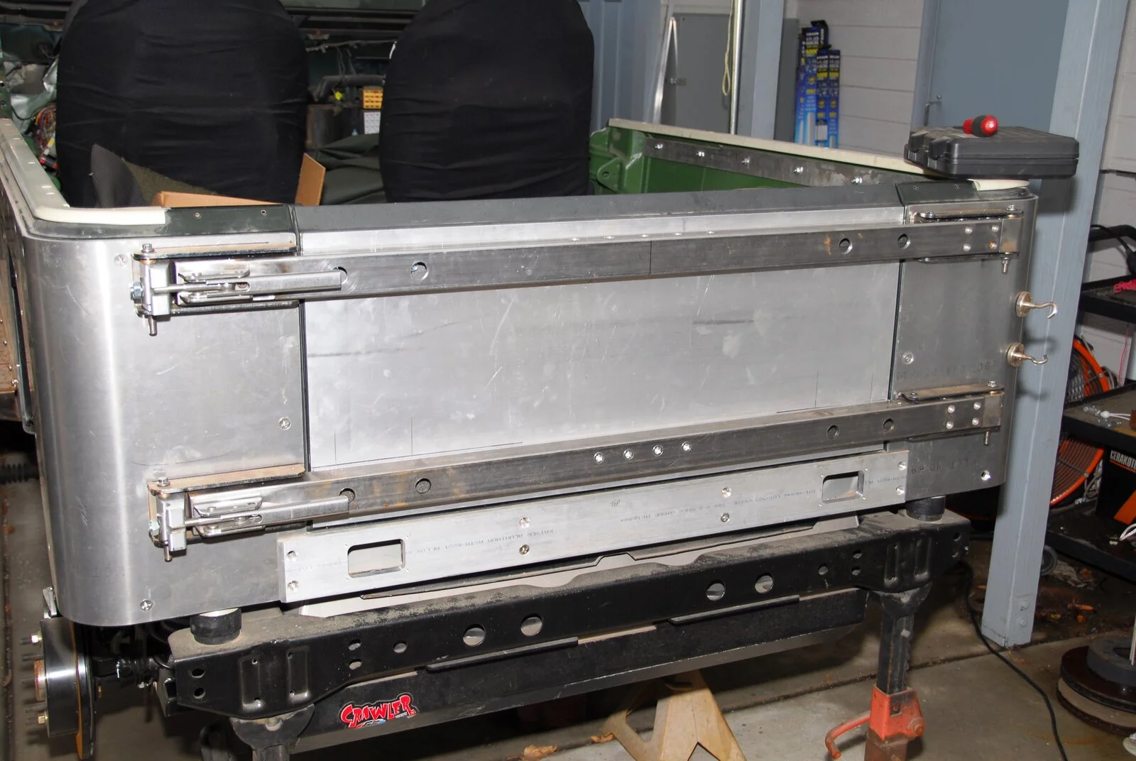

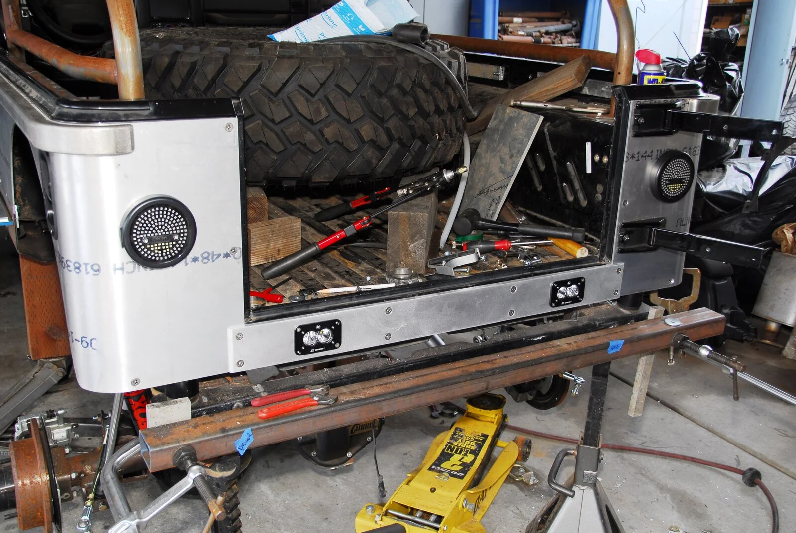

That looks really nice!! The back up lights would be a nice addition. I am not running any corner armor at the moment. That is a nice setup that looks like it extends past the valance seams a bit. Savvy makes an aluminum one for their dropdown tailgate I was considering. I also considered some 3.5 to 4 inch steel flat stock.
Thanks. That is the sorta nice looking one. This is the nice one.
I've dealt with far too many single latch point issues for it to be otherwise.
How thick is that aluminum on the valance? Or how think do you think it needs to be. Mine would just be distributing a smaller load. I am thinking 3/16. 1/8 may even work really.

With that said, the tailgate crack I have developed seems to have stemmed from closing the gate. I may have had my lower snubber adjusted out too far or latch was too tight previously which could have caused issues I am trying to fix now.. The gate is already cracked so I drilled the ends of the crack and plan to weld it up and see if it holds. The inner structure bar in the gate is not cracked. You can feel the crack spreading and see the gate flexing inward when you close it due to the tire weight. Trying to share the info for anyone following along.
