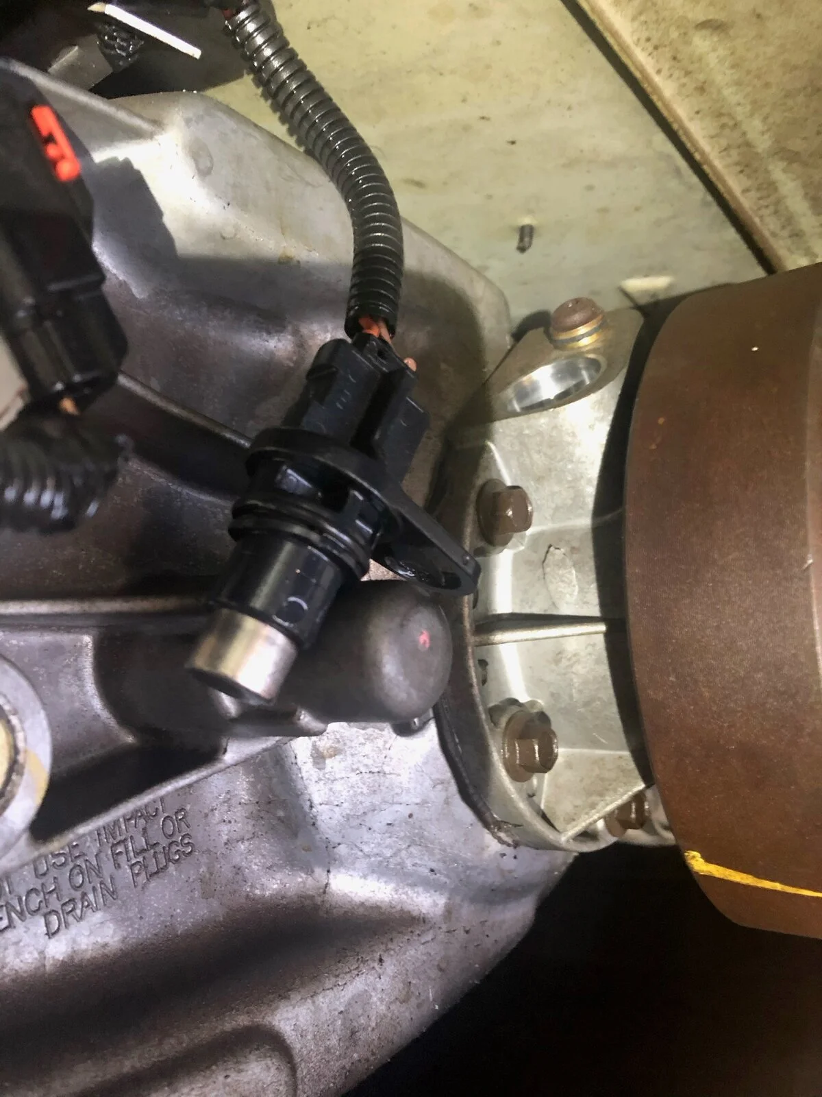

I didn't look at mine until yesterday, was thinking initially that maybe I had overheated the trans and it spewed out. No, found that I somehow puked the speed sensor and put a crack in the Transfer Case output housing. Has anyone seen this before?
It looks like both of these parts are discontinued, so repairs instead of replacements looks to be the order of the day. The bigger question is cause? TC still seems to work perfectly, shifts in and out as intended. Do you think I can pull just the rear flange and the rear output housing and repair it and reinstall and refill? Not sure, but if there was something in there to cause this, I should certainly find it, right?
