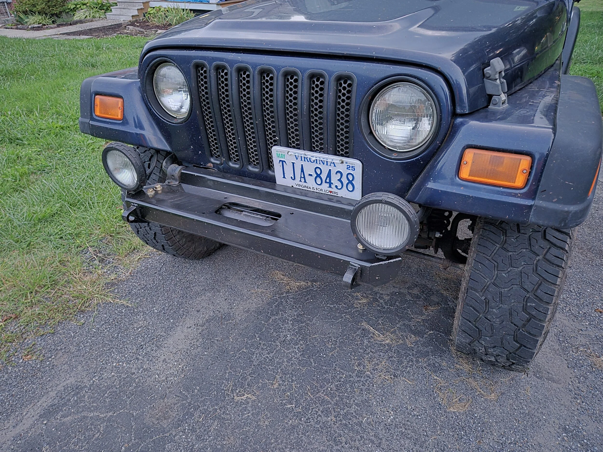

I sold the front bumper from my Xterra today and immediately ordered the DirtWorx rear bumper for the LJ.
Everything is moving slower than I hoped but I'm getting there.

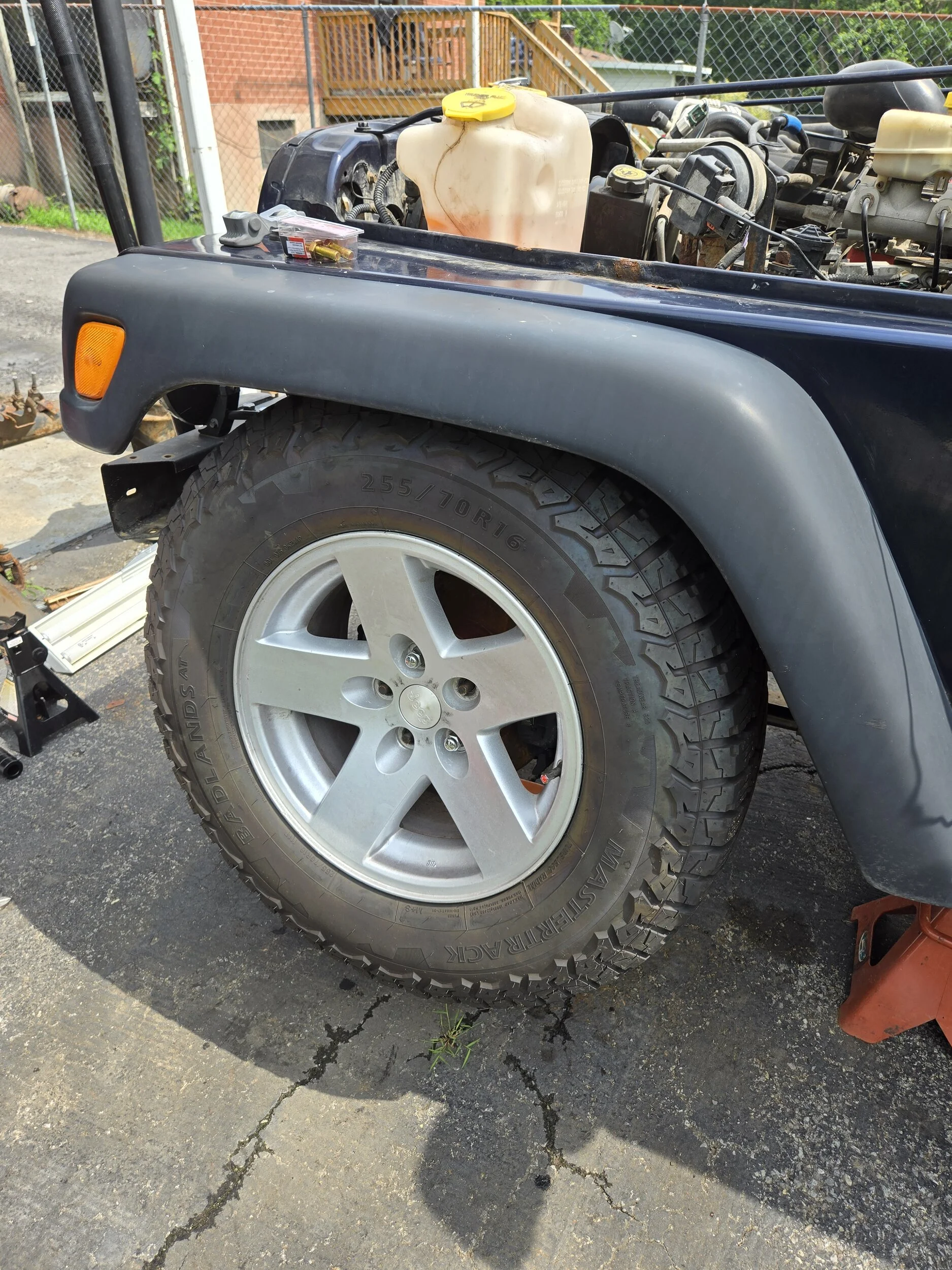

The new control arms and track bar made a huge difference in the front of the Jeep. I've still got to get the 265/75/16s on it and figure out the alignment.

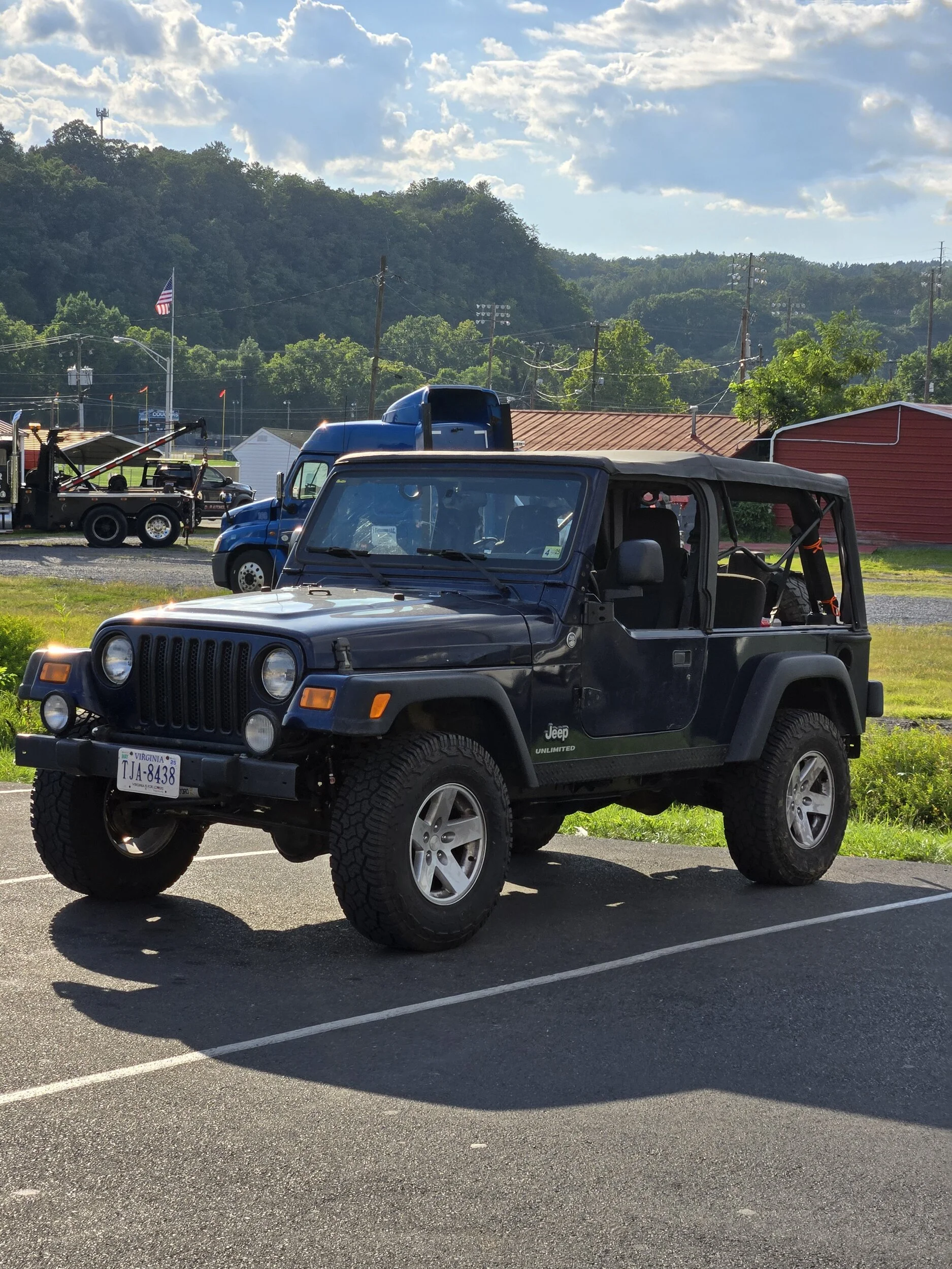

Got some used 265/75/16s installed today. Looks better than the other tires and properly balanced it no longer shakes on the highway.

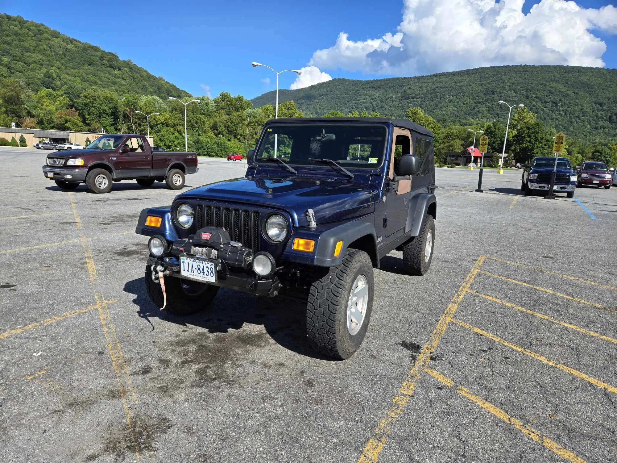

Finally got my GenRight bumper installed today. Hopefully I can get the winch put on soon. I've got to switch back to integrated controls from the remote setup on my Xterra.

That Zeon 10S looks HUGE on that bumper.
Now I'm considering a winch cover to help protect the rope. It was hidden on my Xterra so it wasn't an issue.
