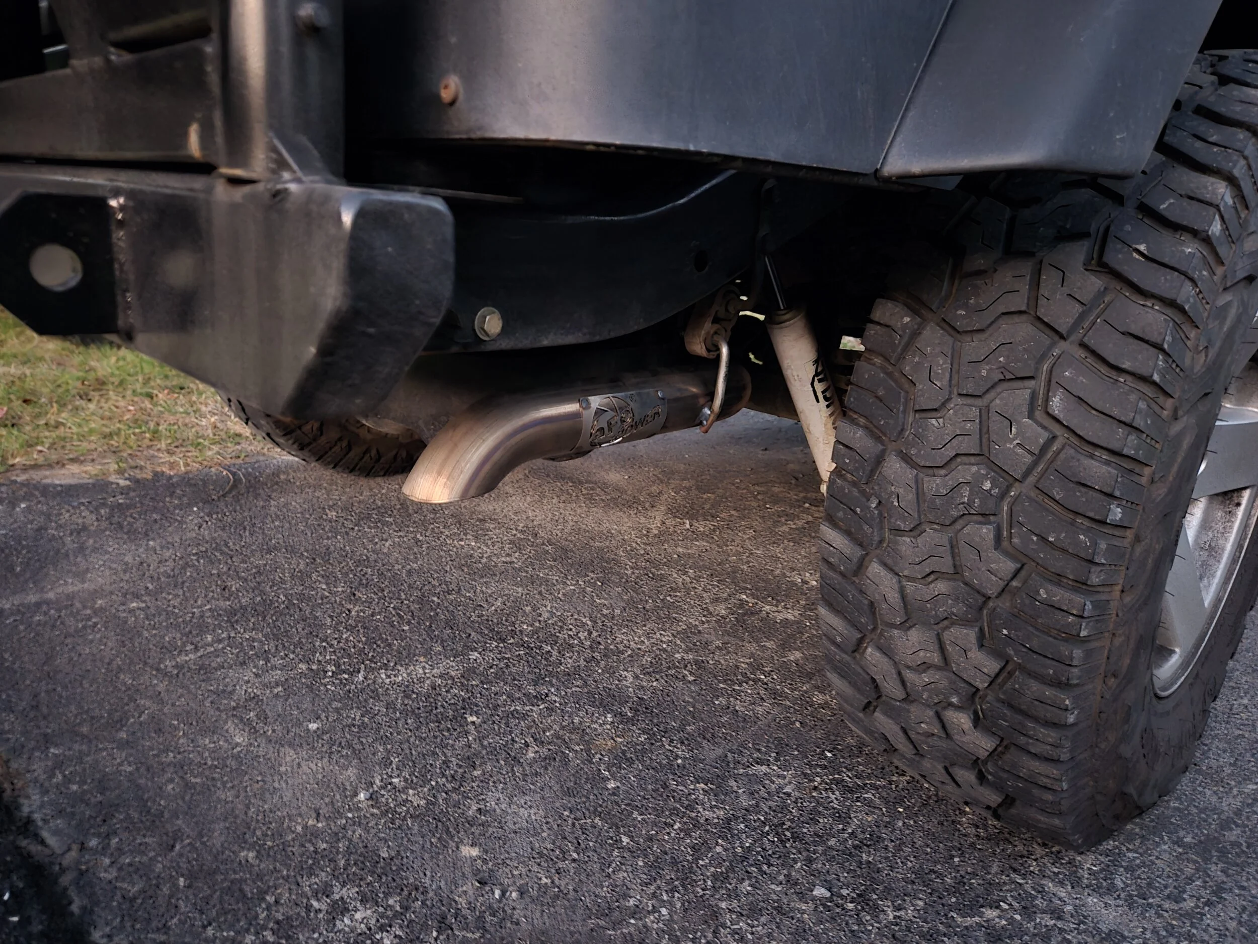

Shop got the aFe exhaust system installed today. Sounds nice!

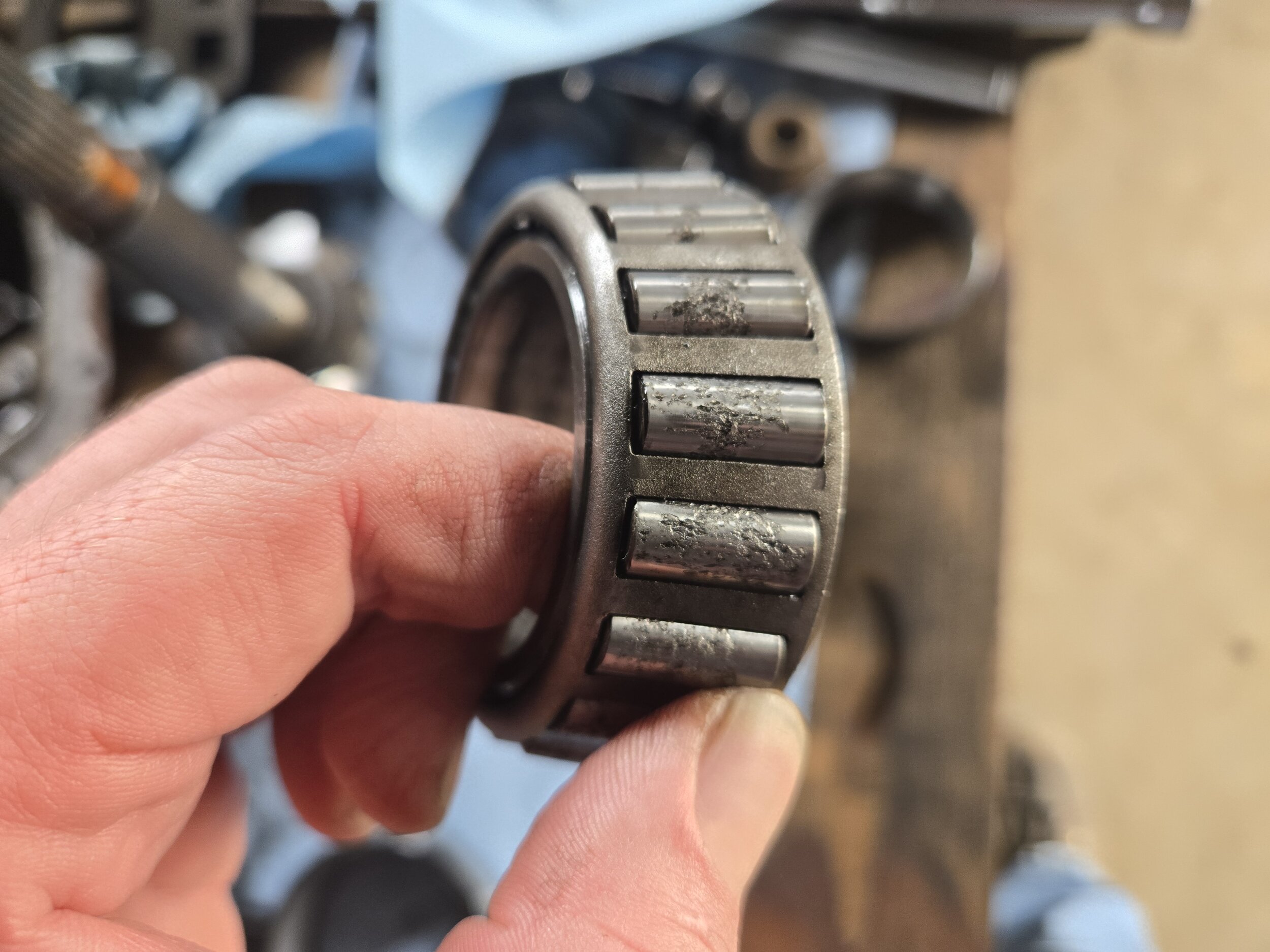

Original carrier bearings.
We found a slice across the seal surface on the driver's side rear shaft where someone haphazardly changed the wheel bearing in the past. It'll probably start leaking again but at least I know why.
The drivers side front u-joint has exploded too and it looks like the yoke ears wore away the edges of the wheel bearing bolts.

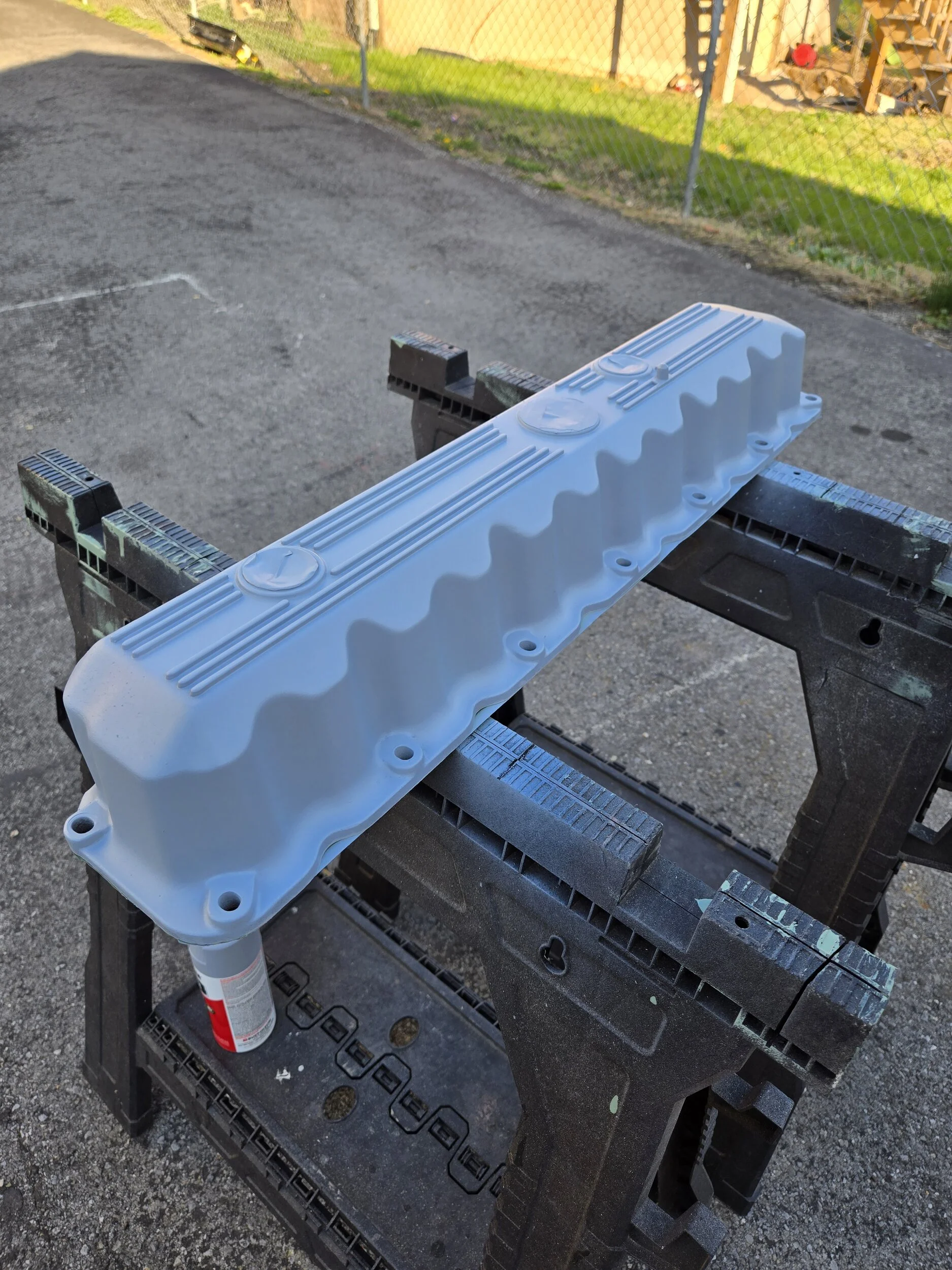

Maybe I'll get the aluminum valve cover out and clean it up this week and be ready for a full swap out once my parts arrive. Considering the Harlan-Sharp roller rockers to round out the "while I'm in there" list. Ugh.
While I'm waiting for the second coat of paint on my RENIX valve cover to dry, I opened my Bestop HOSS window storage roll. It works well with the LJ top. That'll be nice this summer on longer trips with the top down.

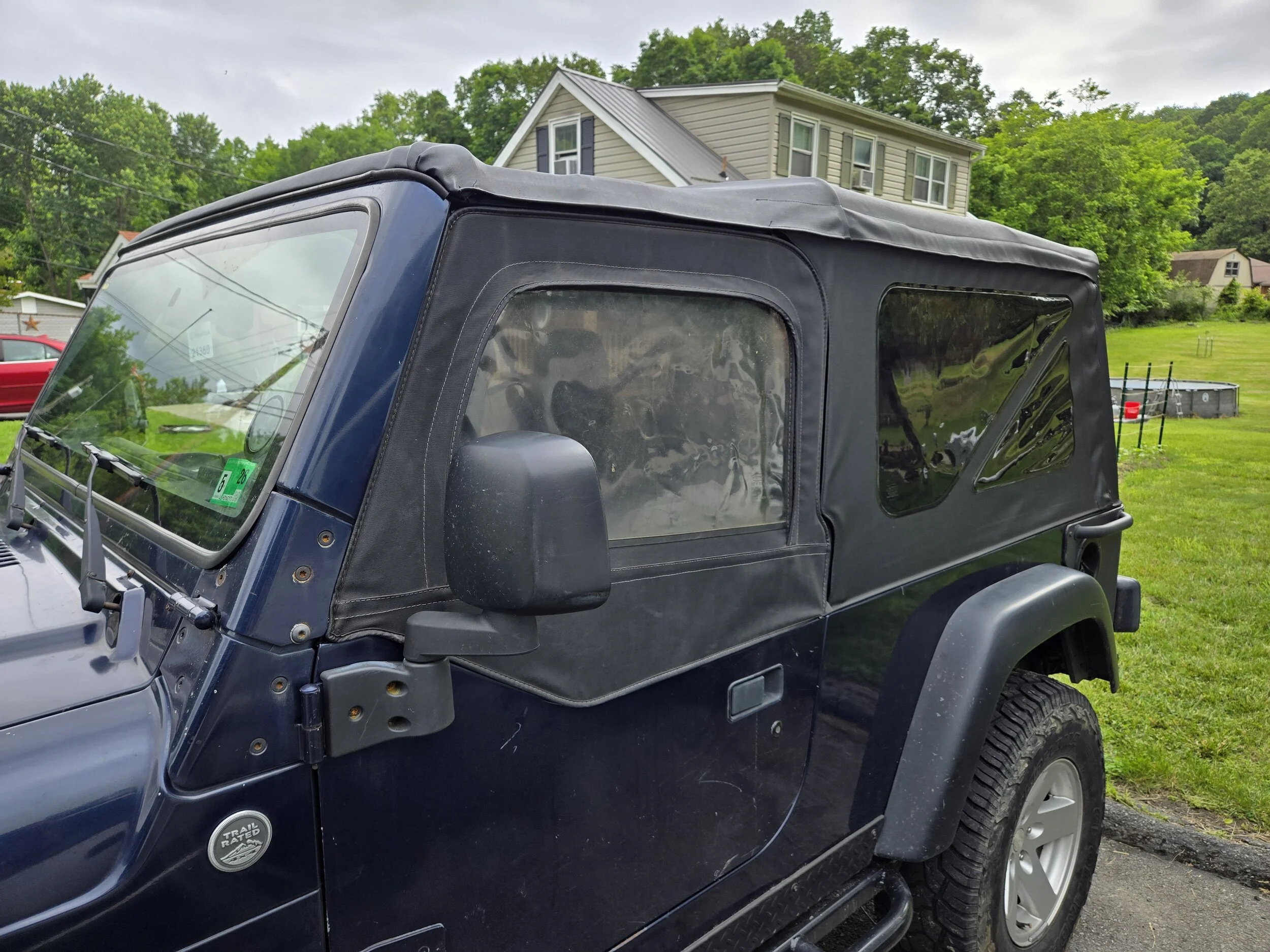

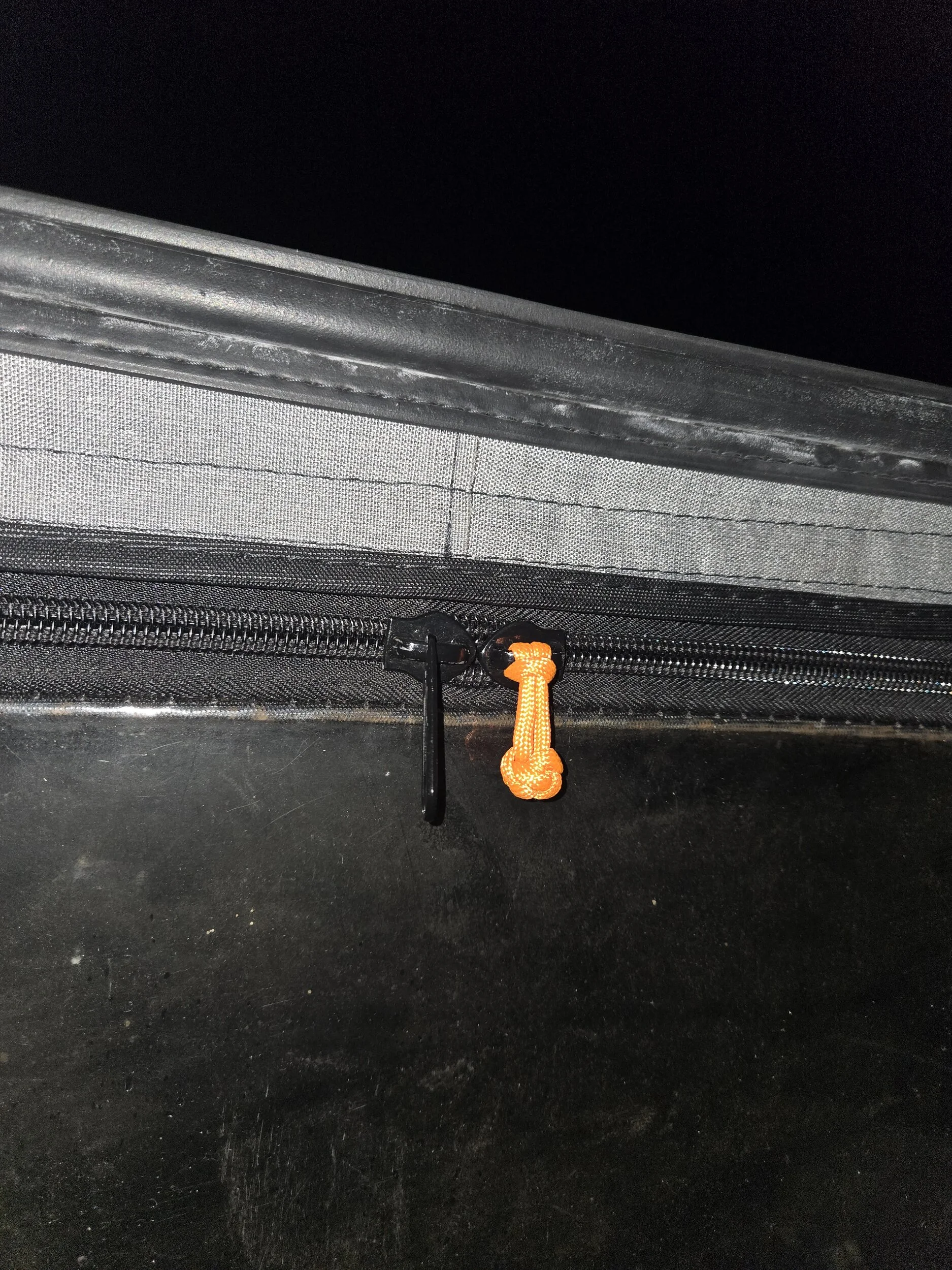

The spice door upper on the driver side was pretty trashed when I got the half doors but the window finally broke loose and the stitches were all failing. The passenger side was an OK original but was coming undone as well so yesterday I swapped on the Smittybilt upper skins I picked up last year.
