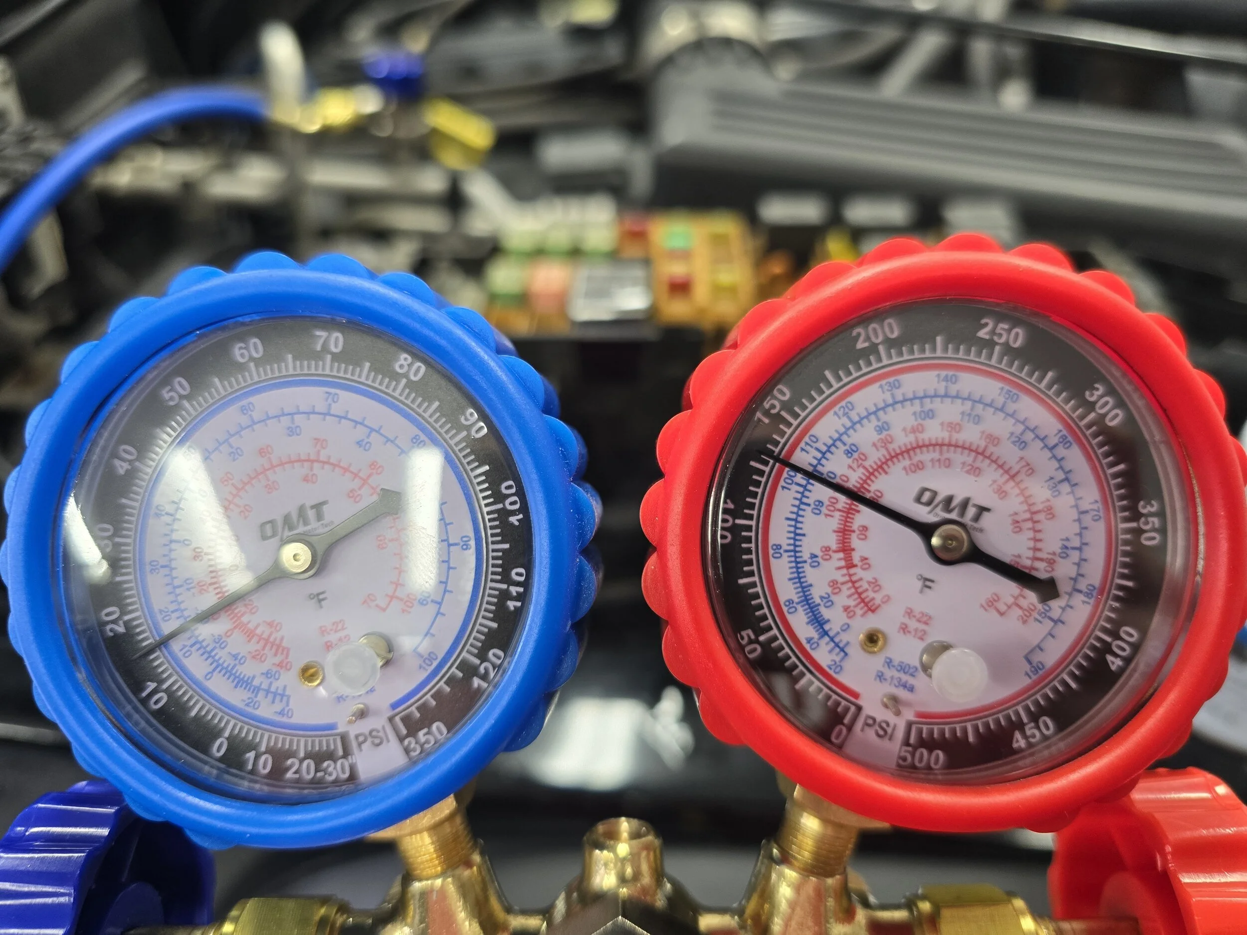

Jumping pin 87 & 30 pulls the clutch when the Jeep is running and it blows ice cold air inside. Here are the pressures on the system at idle and not moving.
