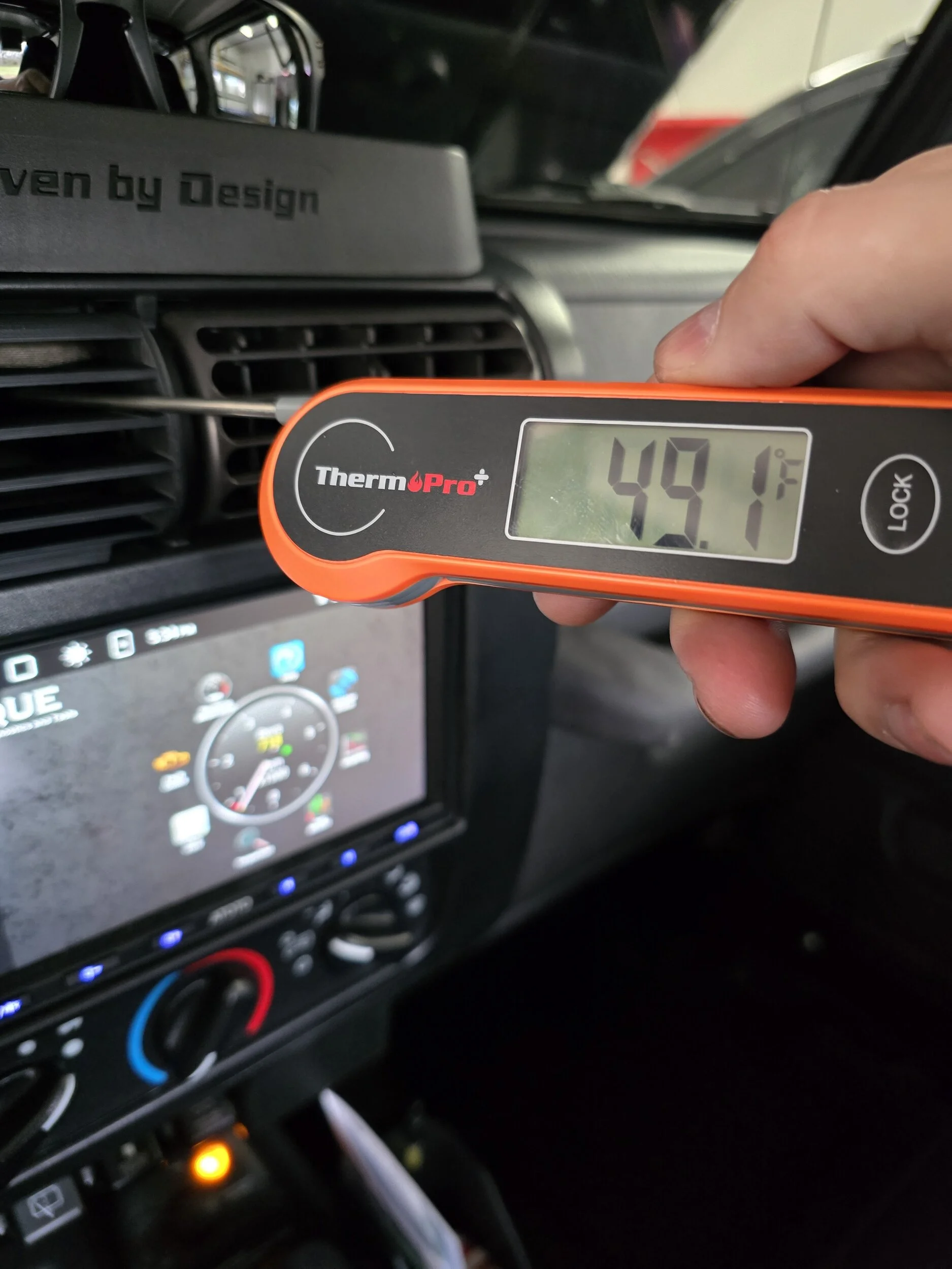

No clue what I did, but it works as it is supposed to now with the relay installed. It's blowing ice.
