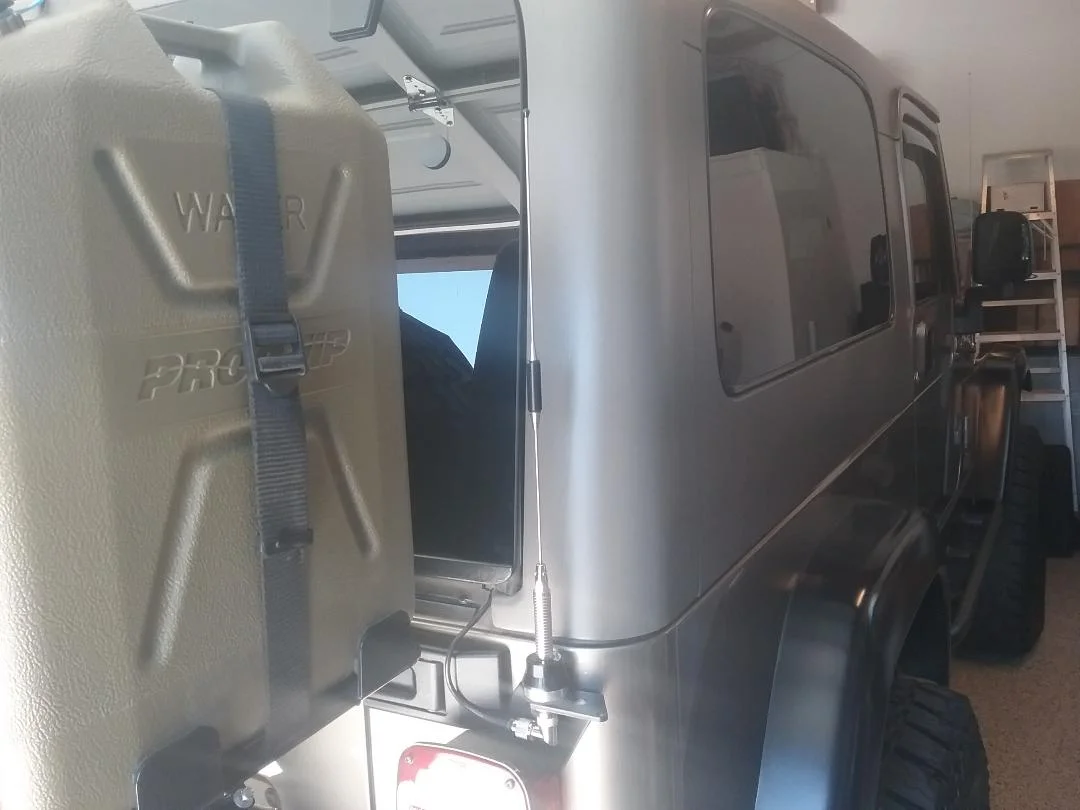

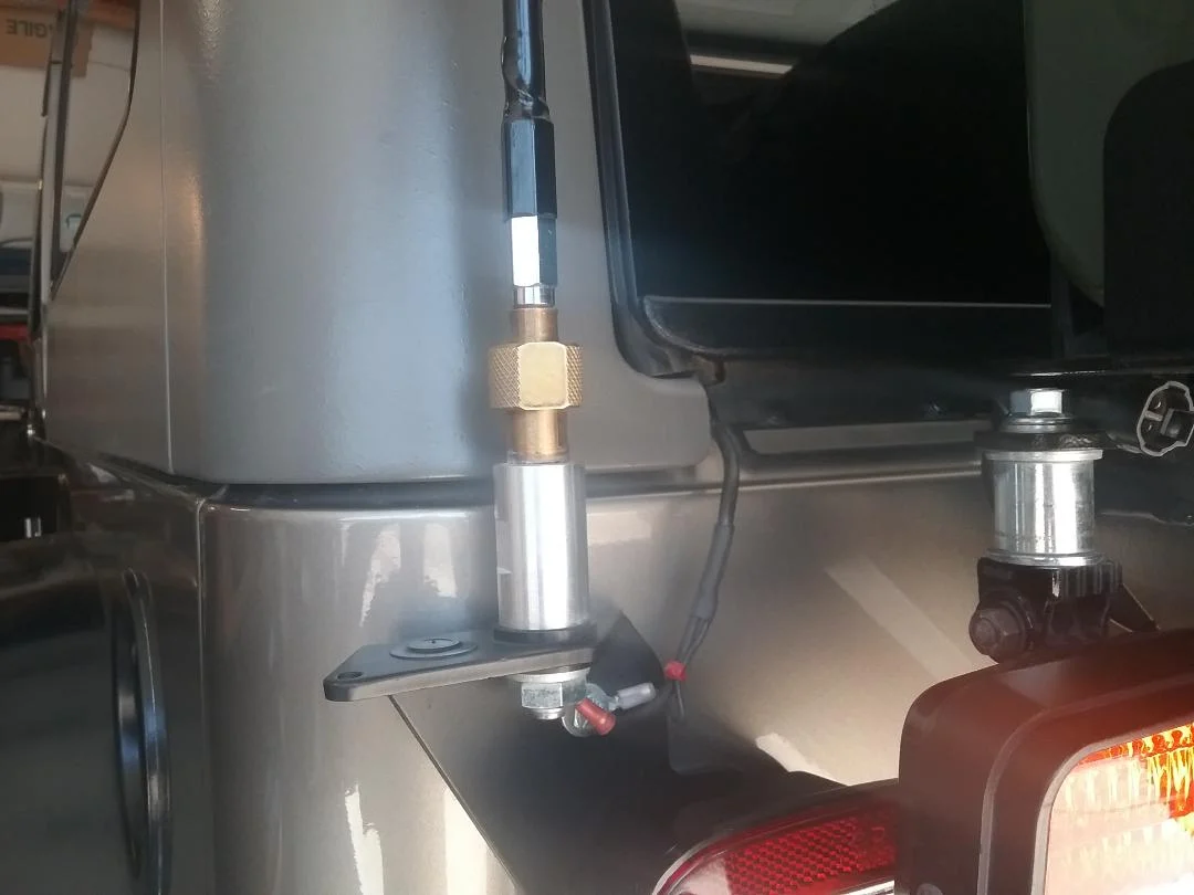

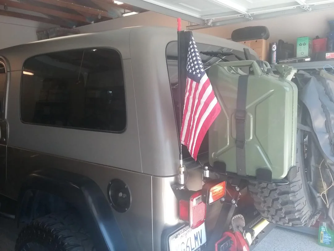

I briefly tried one of the antenna tabs welded into my Rock Hard 4x4 swing-away carrier. The RF ground was insufficient even with bare metal-to-metal contact at the antenna tab and from bumper to frame. The weak point was the carrier hinge - greased bearings don't make for a good RF ground connection. I put alligator clips on the ends of a short length of braided copper strap from carrier directly to frame as an experiment, which improved things, but as a general rule I don't like exposed cables or straps.
In the end I abandoned the idea of using the antenna tabs on my tire carrier in favor of left Teraflex tail light antenna mount for CB and corresponding right side Teraflex tail light mount for ham.

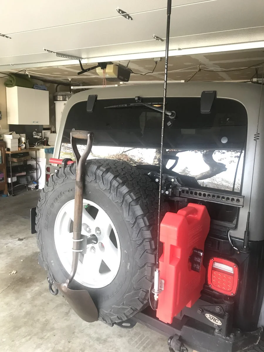

I’ll buck the trend here. I mounted my CB antenna on my tire carrier without any additional grounding straps. It is actually on my homemade Rotopax mount which is bolted to the tire carrier. The combination makes enough of a counterpoise to get a decent VSWR. It is 2.0:1 at the band edges and perfect at band center. This is with a 3 foot Firestik.

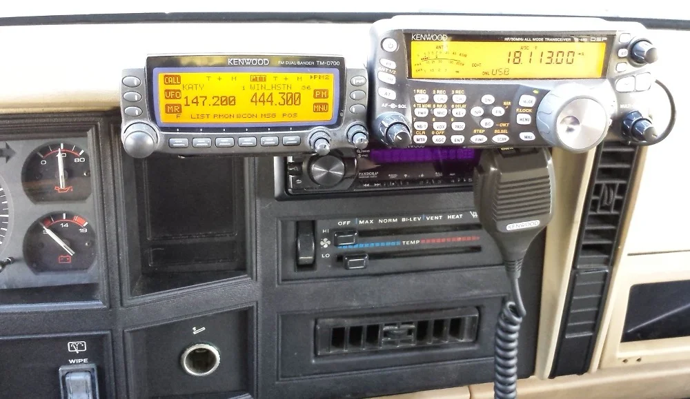

You can see mine bolted to the bottom of my 2m ham radio... I've used that model CB in two Jeeps over 23 years.
I have been a ham for 30 years...
Here is my mobiles I removed from the old jeep,
The radio on the left is a TM-D700A dual band 2M, 70cM
The radio on the right is a TS-480 SAT all the ham bands
from 1.8Mhz - 54Mhz, modes A1A (CW), J3E (SSB), A3E (AM), F3E (FM), F1D (FSK)
working out the mounts and antennas for the 2002 TJ.

I am an extra class... and my jeep,
will soon look like a Porcupine!
