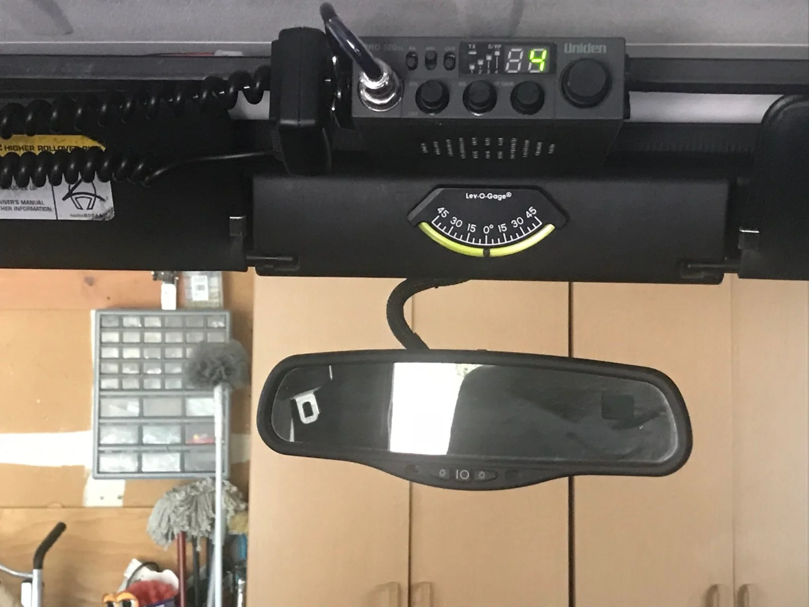

I made a mount similar to the Arizona Rocky Road but spaced up higher so I can see my inclinometer.
Do you have any specs?
It is made from 1 inch steel channel welded to blocks about 1.5 inches high that bolt to the rollbar. The channel is bowed up slightly in the center to follow the contour of the roof. I lost the mounting bracket for the radio so I just welded mounting tabs directly to the channel.

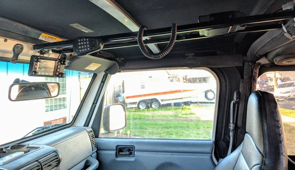

Here is one that I made for my HAM radio. I like this setup because it puts the main unit (speaker) closer to you. No need for external speaker.

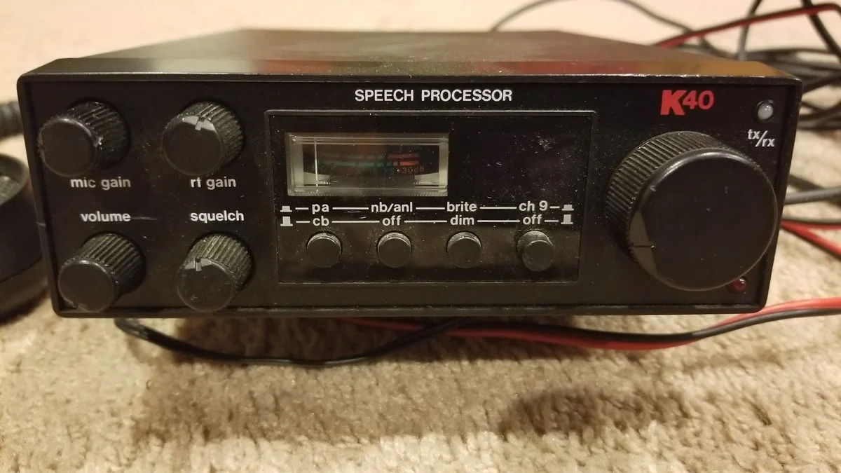

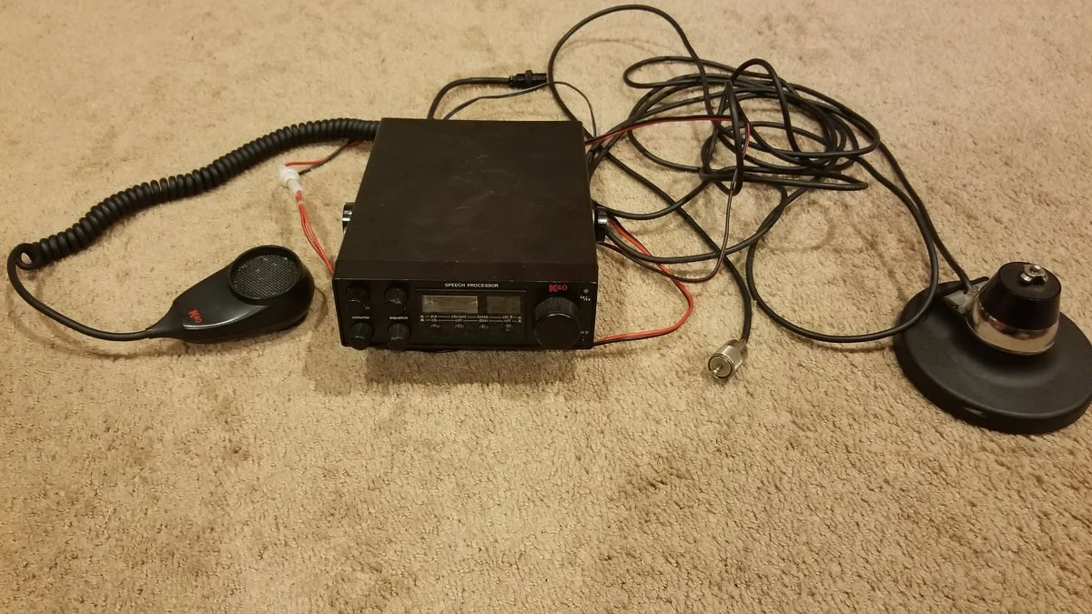

I remembered someone gave me a used radio (K40) about 20 years ago I never installed in my '94 YJ. I went through some boxes in my garage and found it (pics attached). It powers well and appears to be in great shape. All I know from online reading is that it's pretty old and it used to be considered a good choice by many. Lol.
My question is, should I try to buy the antenna (it seems that's all it's missing) and use this, or spend about $100 (radio + antenna + cable and mounting bracket) getting a whole new Uniden Pro-520XL setup?
Thank you in advance.
Heck I'd run that, it probably works fine. A good rugged antenna that flexes but isn't so whippy it'll bang into the Jeep is a Firestik 2' FS-2 or a 3' FS-3. Personally I run the FS-2 since it clears my garage door and low parking garage cellings. Not to mention it works great on my favorite canyon trails.

Thank you! I am excited about finding this cb radio after many years in a box. All buttons work and powers up without a hiccup. The more I read (there isn't much online), the more I think I will just install this. There is a K40 antenna being sold on OfferUp for $15 near by. I hope it works. Fingers crossed.
Run it!
When you're talking old, as long as it's not 50 years old with dried out capacitors, solid state shouldn't have a problem with it working. Add a dual band 2m/70cm ham transceiver and between both, you'll cover 99% of your Communications needs, that saves your money and use it on the ham side now.
