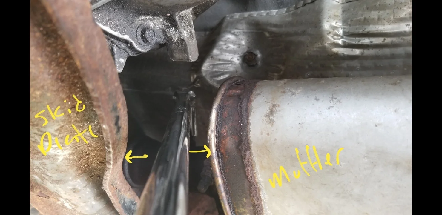

1999 TJ, been trying to get the downstream sensor out. I used a ton of PB Blaster and hit it with a propane torch with no luck using an open end wrench. I finally cut the wire and the top of the sensor (used a reciprocating saw) so I could get a socket on the flats. Was able to get a breaker bar on the socket, but it is so tight between the skid plate and the muffler that there is no way to turn it. Either the skid plate or the muffler has to come out and given the rust all around either job seems like trouble especially without a lift. Am I missing something?
Nope, you're not missing anything. Yours is just so corroded in there that it's not budging. I will say that PB Blaster is garbage when compared to Kroil (I've used them both and can attest to this), so I may give Kroil a try.
If that doesn't do it, you could always take it to an exhaust shop and have them cut that section of the pipe out and weld a new one (with a bung) in place of it.
Thanks. I picked-up a MAP torch today and hit the bung until red spraying with WD40 Penetrating oil — repeated a few times — wouldn't budge. I think if I had room to get some leverage I might get it, but I don't have a lift to take off the muffler or skid plate. I have a local shop that I can take it to. Sucks that something so simple is so hard.
You’re right about a lift and some leverage. I’ll bet that would do it. Sometimes you really need a lift to get that leverage.

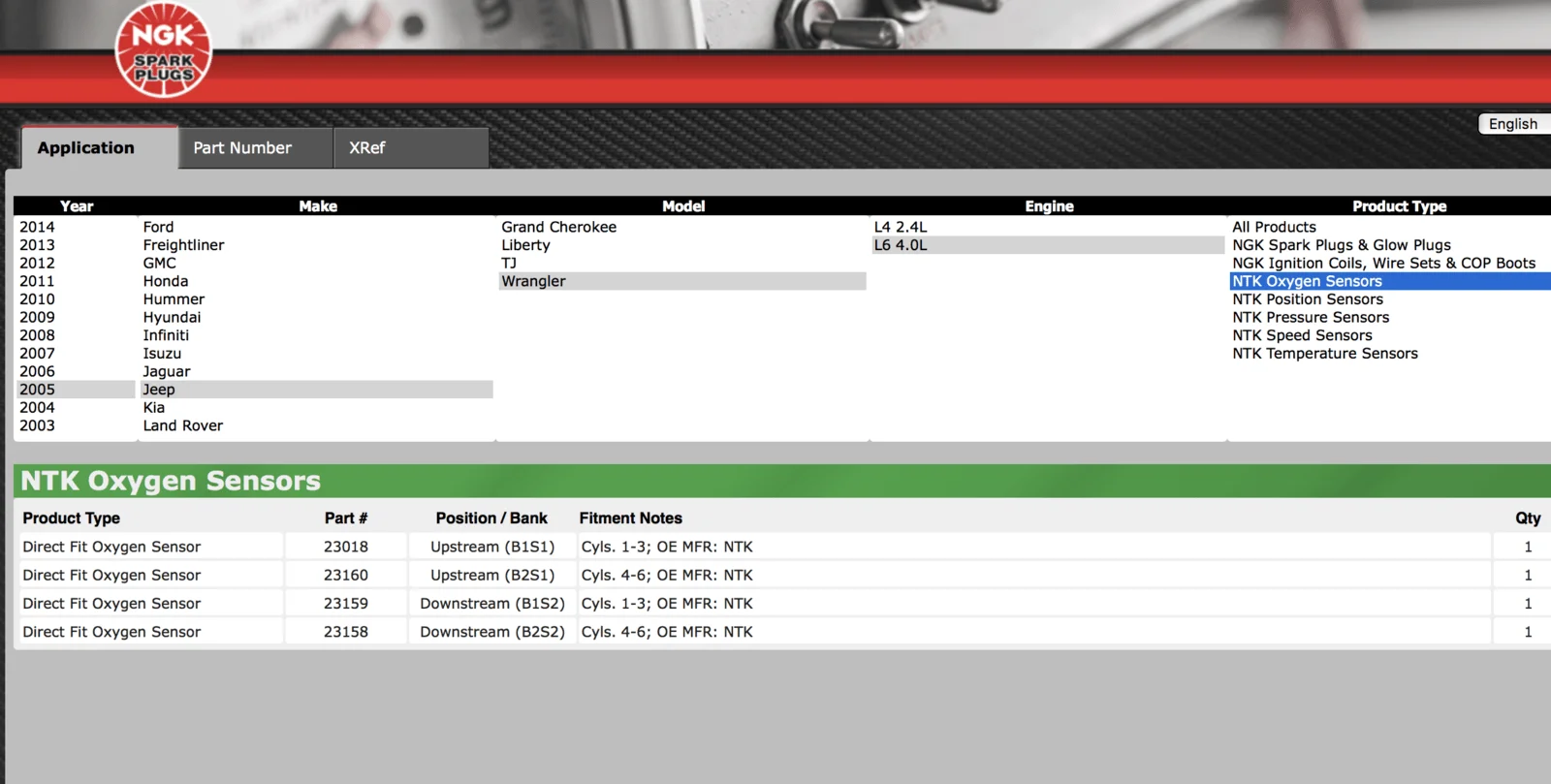

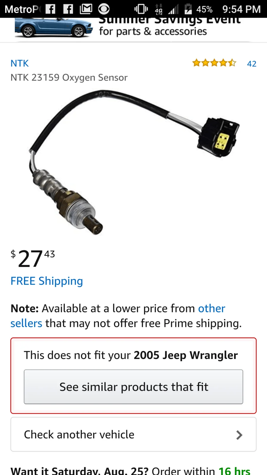

Chris thanks for all the info. I'm going to be ordering all 4 sensors. I have a 05 sport and when I went to the link you have for the bank 1 sensor 2 it says it don't fit. Is there another one I could use? Thanks.
That is the correct O2 sensor, Amazon just has an error on their end by saying it doesn't fit your 2005.
This is taken from the official NGK website just now:
As you can see, 23159 is indeed the correct O2 sensor.
Sometimes Amazon gets things wrong. Rarely, but it does happen.
Perfect. Thank you. I have a 05 with the 4.0 thanks again Chris.
