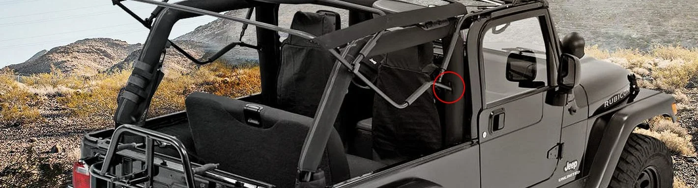

Does yours look like this?
Please tell me you can adapt the LJ model to the TJ by cutting that off? I just bought an LJ surround set off ebay and the guy said it was the same as TJ. Or maybe it's a TJ that he thought would fit both. I don't know.
Should not be a problem, the surrounds are otherwise 100% identical from what I can see. I'm not even sure you have to cut the connecter off, I'd suggest trying it and see if it interferes with anything.

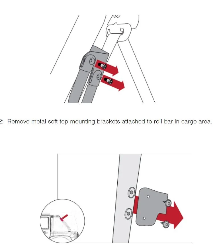

Trying to see if I have them. Because I need them. But not finding much. This is a diagram of a JK (IIRC). Just wondering if it's the same place? Brackets are very similar.
I'm not seeing or feeling any brackets thru the roll bar padding. I guess this means I need them. And will have to cut my roll bar padding to make them accessible?

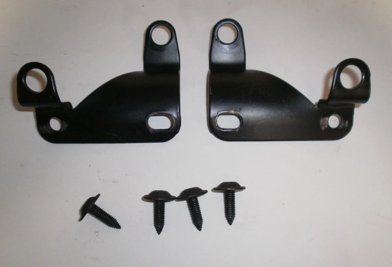

These are the brackets in question:
Yes, they go on the rollbar under the padding. The vertical part of the roll bar behind the driver and passenger seat should have a slit for it in the padding about mid-way between the top of the tub and the top of the roll bar. Peal off the padding and you should see two threaded holes. Mount the brackets, then replace the padding. They do not go on the slanted part of the roll bar, as illustrated in your picture. I found a picture of what it should look like, and circled where the brackets mount. (the picture is for an unlimited, which uses a different frame setup, but still illustrates where your brackets go)

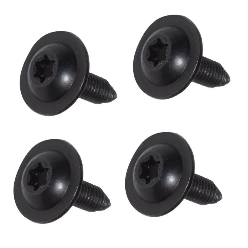

I found the brackets on Amazon prime for about $35 by saturday. No screws. The screws are not Prime and run $15 for 4 of them.
Does anybody know the specs on these screws?
So I can pick them up from McMaster-Carr or know of a place that you can buy small bulk quantity for less?
If I had the correct size I could probably find a working set at my local hardware store. They have a fittings section that's pretty well equipped. I see these being used on a few places on a Jeep. These must be standard sized screws.
Trying to do this on this upcoming "sunny" saturday. The screws are all that's holding me back.
Those bolts you have pictured look similar to bumper end cap bolts. If so, they are impossible to find OEM. I bought some off of ebay and they literally rusted in a day.
My gas surround uses regular screws that are not that robust. This bracket does take some constant pressure so that might be something to keep in mind.

Whatever bolts you use will get covered up by the roll bar padding.
I know. I'm just being a stickler. lol. I bought new 03-06 seats from my wrecking yard. They're gonna throw in some of those screws in the shipment. In the meantime I'll just swipe 4 of them from my gas cap surround.
