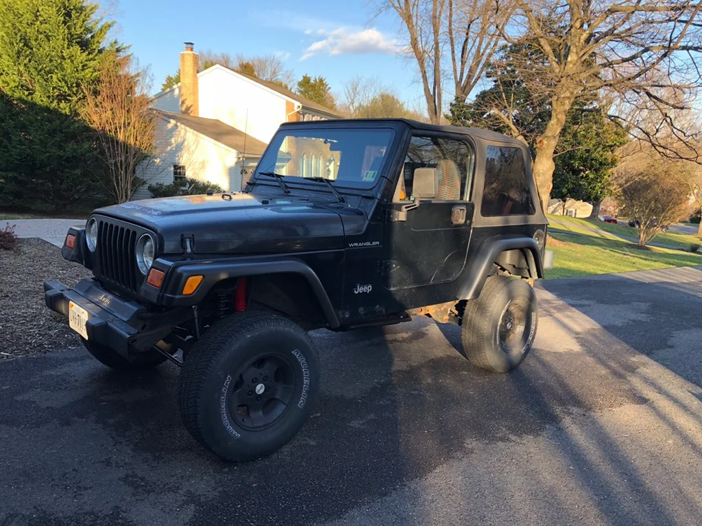

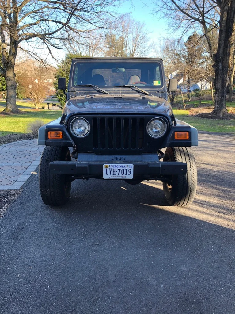

Not sure if this will help, but I have the Rampage header with the Rampage frameless top. From the front:
And from the side:
I put it on in about 50 degree weather. I pre-heated everything and ran an overhead heater. It was tight, but everything went on front to back and fully zipped.

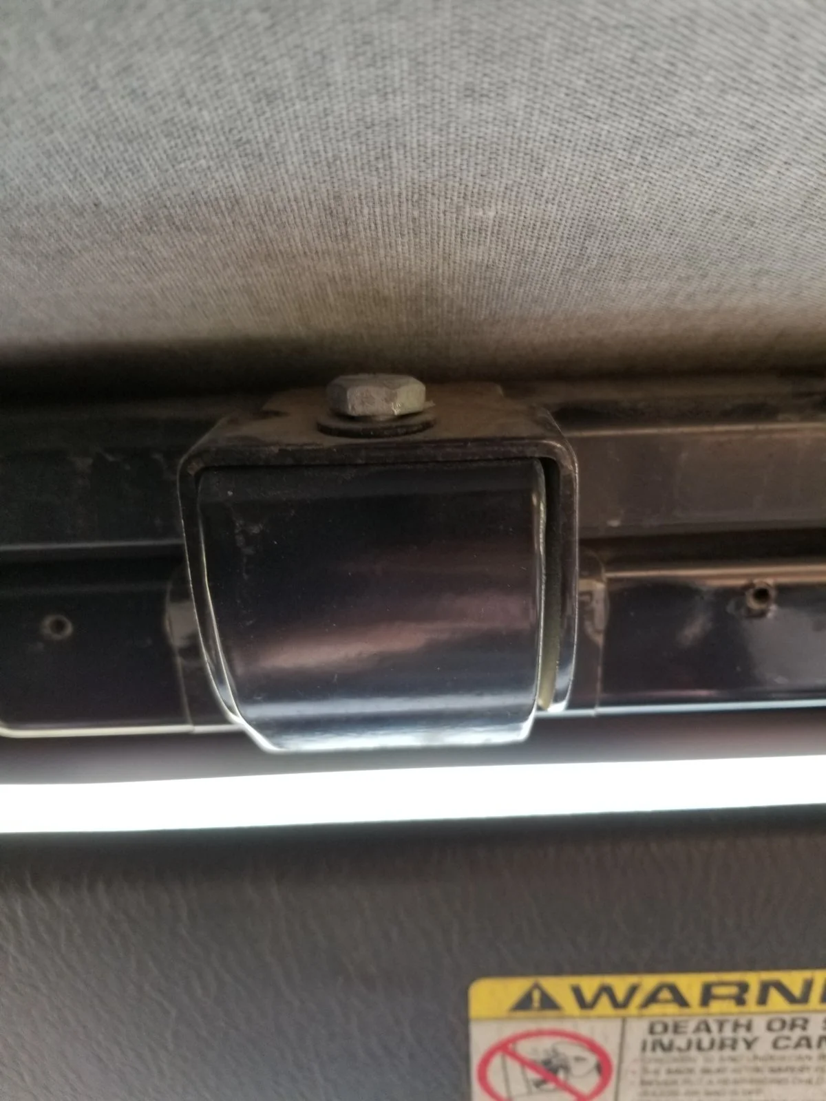

This is the clamp on my header. It has a bolt that tightens it. Does that tell us anything?
That's commonly called the No-Drill header. Tighten the bolts to get it to clamp into place. I had that style installed a few months for a bikini top and considered it enough of a PITA to install/re-install that I trashed it and the top that went with it.
As Jerry indicated - the only no-drill headers I’ve seen are intended for bikini or safari tops. These are much lighter and there is no support frame or bow needed as these tops don’t need to fold. A header for a full top should have the frame connected to it unless you have a frameless top (which you do not). I do not think you have the right header for the top and maybe not even the right frame. These tops are not necessarily interchangeable and more like an integrated system with differences due to patents. My current Bestop has minor differences from my original Mopar top even though they are made by the same people.
