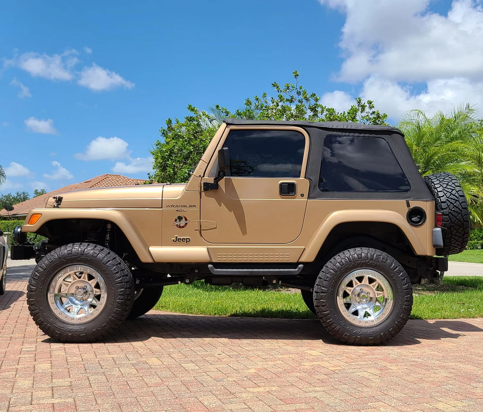

4" Rough Country X-Series lift with JKS F&R Track Bars, Fox shocks, adjustable upper and lower control arms (F&R), factory 3:73 gears, 5-speed trans, SYE with pinion angle set properly, 17" Dirty Life Roadkill (real) beadlocks with 285/70/17 Nitto Trail Grapplers (33").
After countless hours of reading, I decided to do a kit that had upper/lower adjustability in the front and rear. I knew the kit would only be as good as the shocks, so I went with Fox shocks and steering stabilizer.
After install was complete, an 80 mph drive revealed the SYE was a must.
Following the SYE installation and resetting the pinion angle, the Jeep drives like a dream.
I have a 2021 JLUR, and a 2001 TJ Sport, but this 1999 Sahara TJ is my daily. It's predictable, easy to drive, does NOT need re-geared, and will float down the interstate at 80 mph alongside every other Floridian. There are no acceleration issues (c'mon, it's a 4.0 TJ, I don't expect much more than to be able to keep up with the flow of traffic), no braking issues (brakes strong and predictable), nor are there any vibrations (if I want to take my hands off the wheel at a true 80 mph, it goes straight and true), nor is there any weird quirks.
I couldn't be happier about the rig, really.

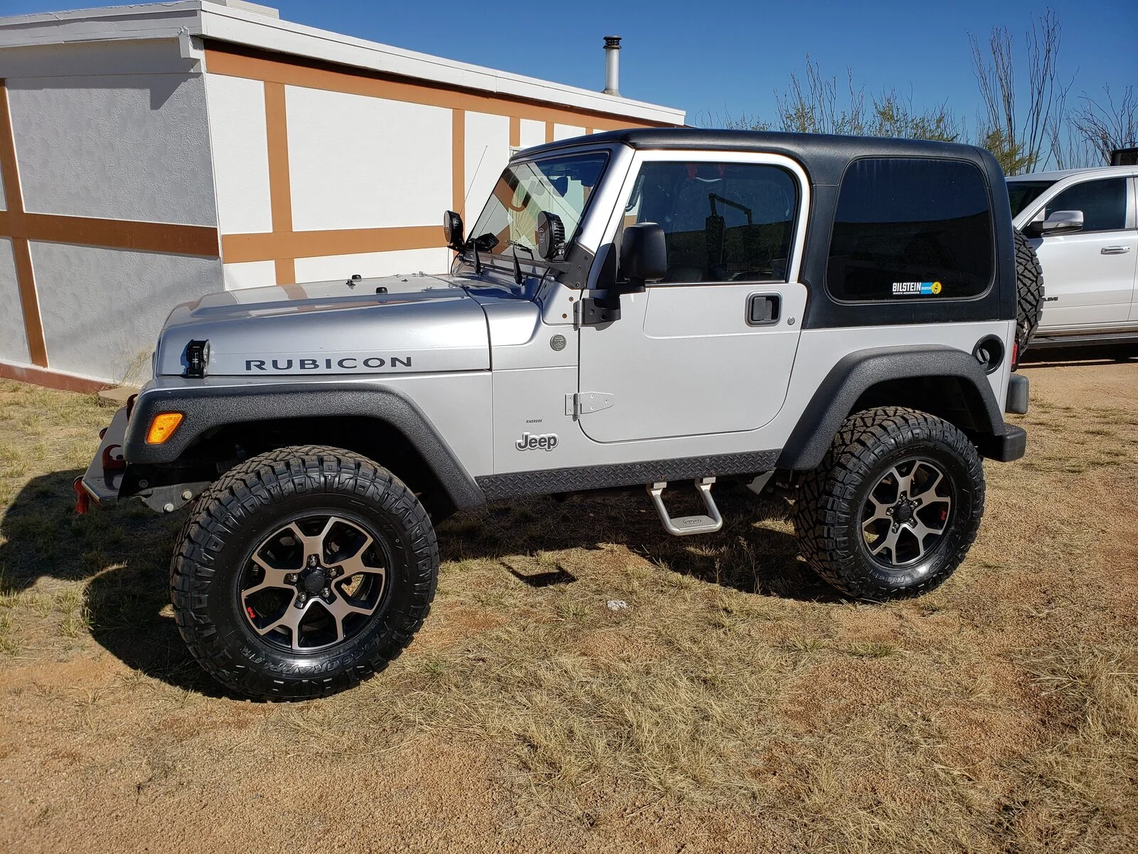

285s (33) on JK wheels. 3" lift with Bilstein's. Will slightly rub on extreme flexing, but I mostly do desert trails and such. I can do 80 MPH all day long on the highway.
