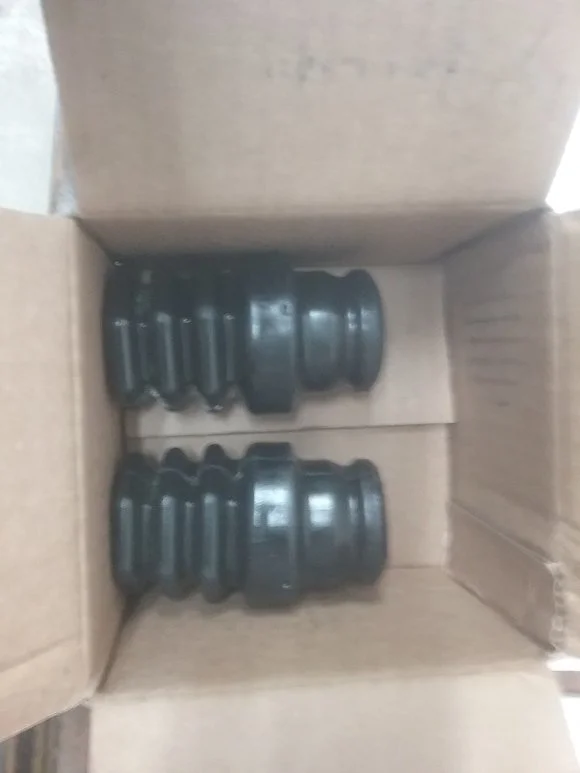

I don't want to add ride height, I solely want my bump stops to function like they should and have no arc. I'm probably jumping the gun way to fast, but my overall concern for all these questions is that the MC springs might be pain and i also might have too much lift..
A big reason I think Metalcloak coils are dumb is because they can be the cause needlessly limited up travel. :)
i'm starting to realize that. I am considering moving to a "standard" type coil so my bumps can simply be determined by my fenders eating my tires.
