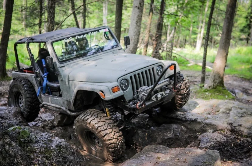

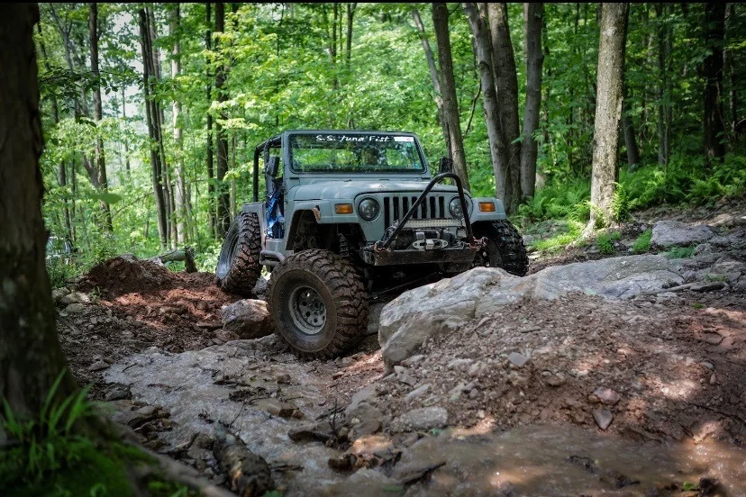

IMG-1661.jpgIMG-1654.jpg 37's with the 2.5SL and 1.25 BL and high lines
IMG-0185.JPGIMG-0177.JPG 37;s with cut and chop rear and front diy high lines.
So in my personal experience. The taller SL isn't required at all compared to a smaller SL, BL and MML,
IMG-0199.JPGIMG-0198.JPG This is the 2.5 SL and 1.25 BL on 33's and there was never a time I wish I had a Taller lift when I took the 33;s through the same trail as posted above when I ran the 37's and DIY high lines.
So in my opinion from daily driving my jeep and rock crawling with it, a Smaller lift with Highlines would be the same as a Larger SL. The larger SL all you are doing is raising up your Center of Gravity and improving your Break over angle. You aren't raising your catch points which is steering, diffs and brackets on the axle. If you keep getting high centered and catching your frame and skid on rocks. Means you probably just aren't picking the best line through whatever obstacle you are trying to get through.

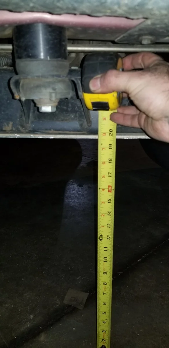

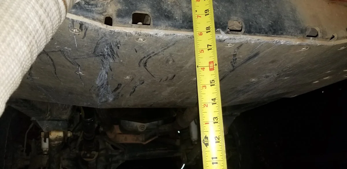

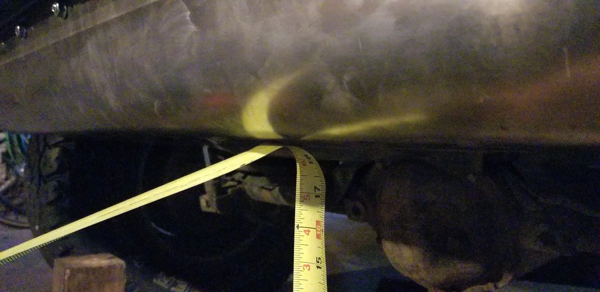

What is your frame and belly height?

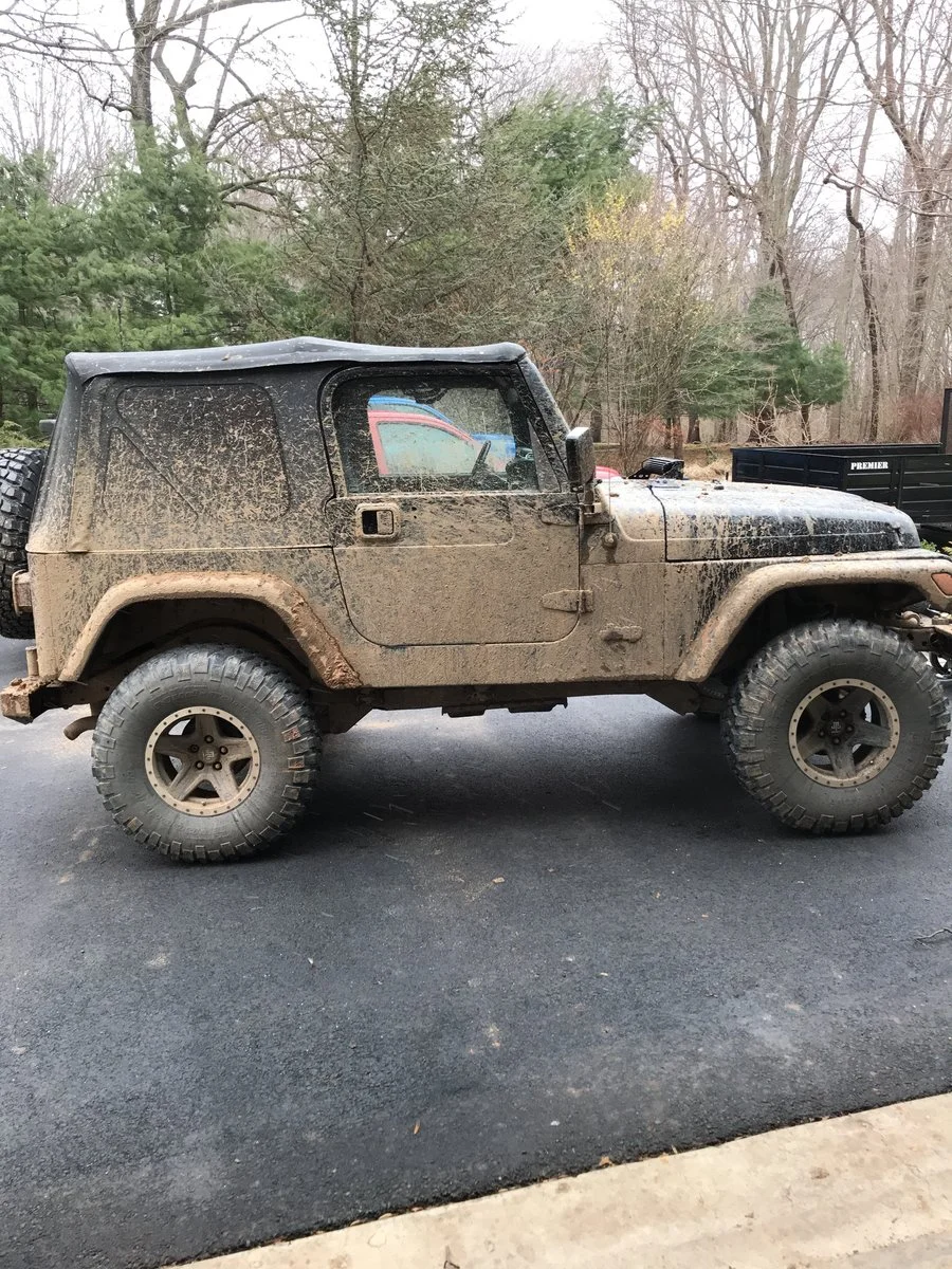

2004 Rubicon, auyo trans, 4" lift, Currie Control arms, Currie Steering, Currie front track bar, JKS rear track bar, 3/4 spacer on stock skid plate, double carden driveshafts - front and rear, 33x12.5r15 tires, American Racing 15x8 wheels, stock 4.10 axle gears. I've had my Jeep gor almost 3 years. Runs great on the highway, tows great behind my RV, works great on the trails east and west of the Mississippi.
