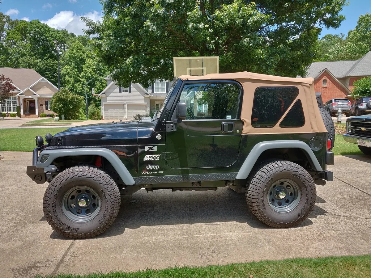

Somethin’ like this...I didn’t have it in me to post a TJ with that stance!
Now you got me rethinking my 3” coil swap I ordered to replace 2” + 0.75 spacer....argh
But this rake though....bleh
Reactions: JMT
I wouldn't be too concerned. Jeep in my PFP has the 3"/2" setup and it's damn near perfectly level, even with passengers or gear in the back. I have a relatively heavy front bumper and it looks like yours may be stock, I can't tell. That may make a small difference but I wouldn't be too concerned.
It will be interesting to see what happens with the 3" springs. What brand did you go with? JKS? Savvy? Procomp? Are you planning to replace the fronts first and then take a look at the rake? I think that would be interesting. Also, what's your true lift now up front? Rear?
Are you running a back seat? It's hard to tell with the soft top window.
Love the Jeep color and wheel combo. I can see what you mean with the rake though.

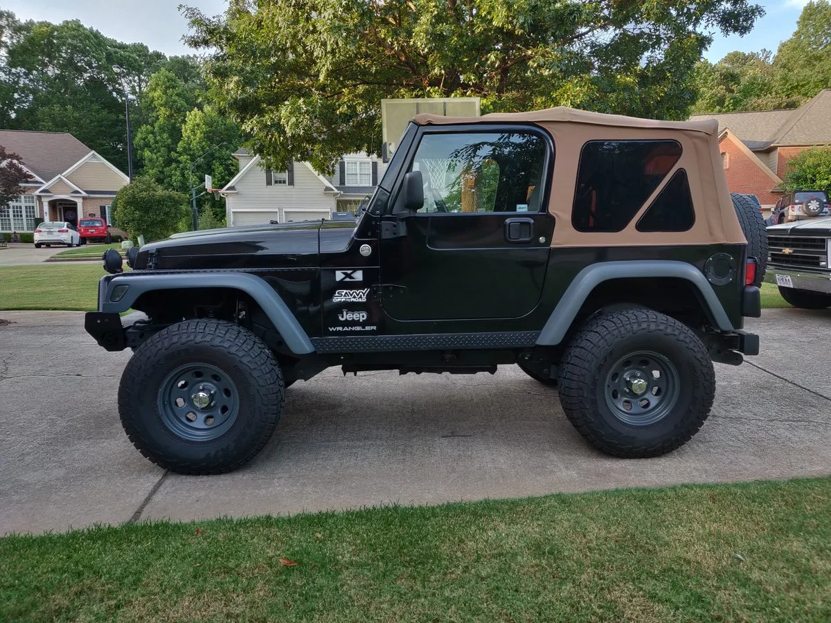

Thanks! Currently 2” BDS springs. 0.75” spacer in the front. Winch with stock bumper. To be fair, I believe that pic was taken when I got back from tire mount and I didn’t have the back seat in. I also don’t plan to run my hardtop anymore as I’m currently trying to sell it. The 3” front BDS springs should be here Thursday. Apparently some of those who run BDS springs do the 3”/2” combo and it levels it out nicely. I just finished installing my Savvy BL just now so I’m curious to see what it looks like prior to the front springs swap.

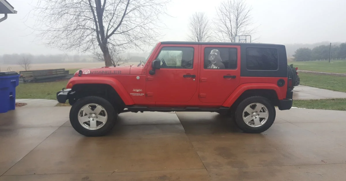

In reference to my comment earlier about running the 3"/2" combo in my own Jeep, they are in fact BDS coils.
Steel stubby front bumper, no winch, full sized spare, rear seat, soft top.
That was right after I put the springs in, they settled a little but the settling was about even front and rear, so no change in rake.
Reactions: jazngab
Steel stubby front bumper, no winch, full sized spare, rear seat, soft top. View attachment 127534

No spacers. I was on a 2" budget boost from the PO previously. I already had put in longer RS5000X because I couldn't handle the shitty Skyjackers from the PO, but I wasn't sure what I wanted to do for springs yet. After doing some research and talking to some people here, I decided to just go for it.
My philosophy that if I ever want to up the lift an inch or so, I can probably just get away with spacers front and rear, for a while at least. With shorter springs up front I would be stacking spacers or the like which I want to avoid.

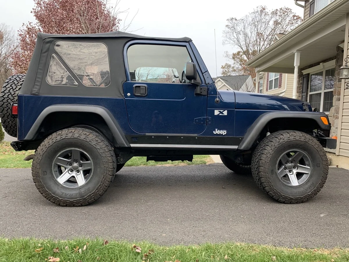

Here is a picture of the Jeep on the 2" budget boost on top of super saggy stock springs. In both pictures a Savvy 1.25" body lift is also already installed.
