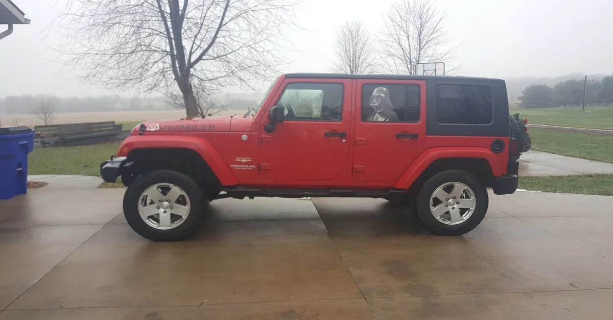

Rake is when the body sits higher than the front. It is there to compensate for occasional added cargo weight.
The guys who work to make their empty Jeep or truck sit level in the driveway end up with a goofy Carolina Squat when they add additional weight.

Somethin’ like this...I didn’t have it in me to post a TJ with that stance!
