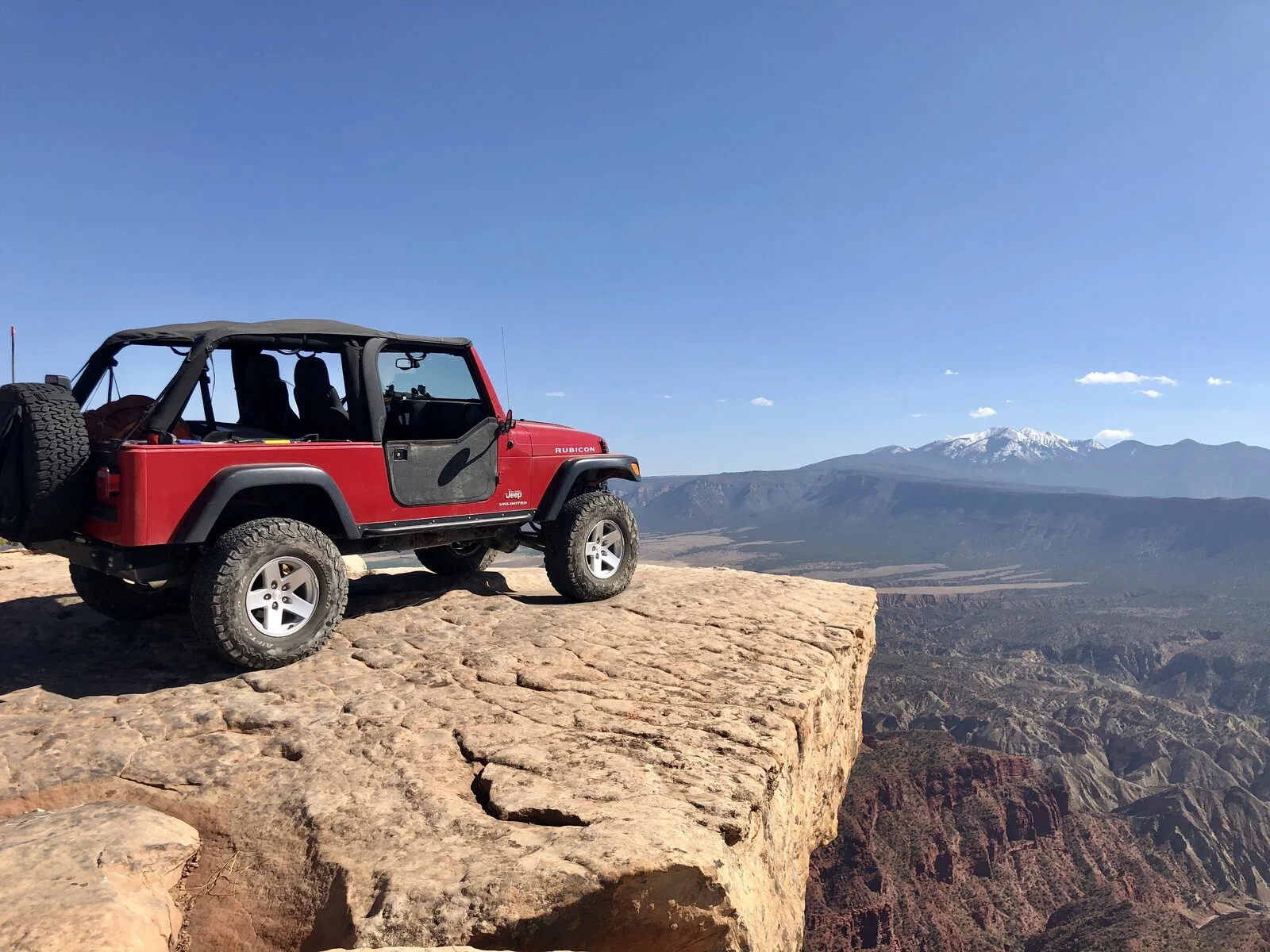

4” Currie Springs, 1.25” BL, 33” KO2. I think it looks fine, but I’m looking forward to 35s.

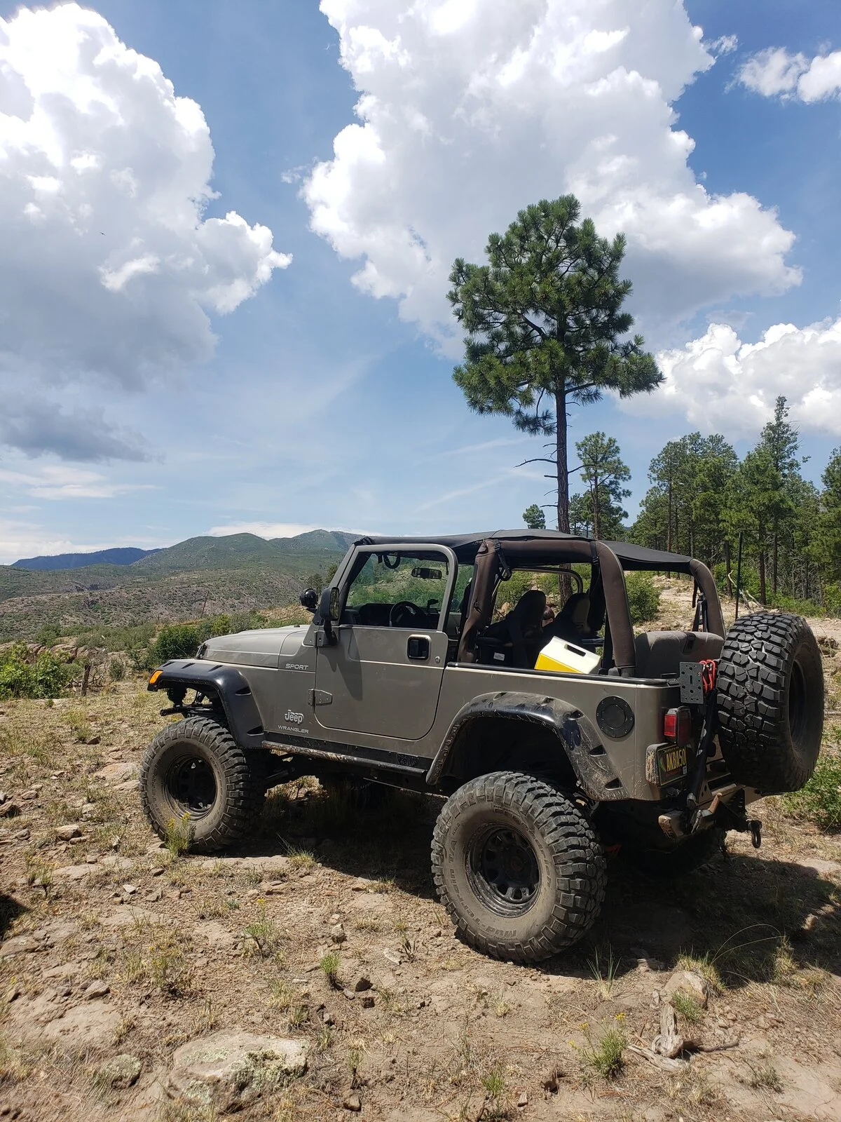

Obviously not an lj but - 4" Currie springs front, 4.5 " Currie LJ in back, 1.25" savvy bl, 33" km2s.
