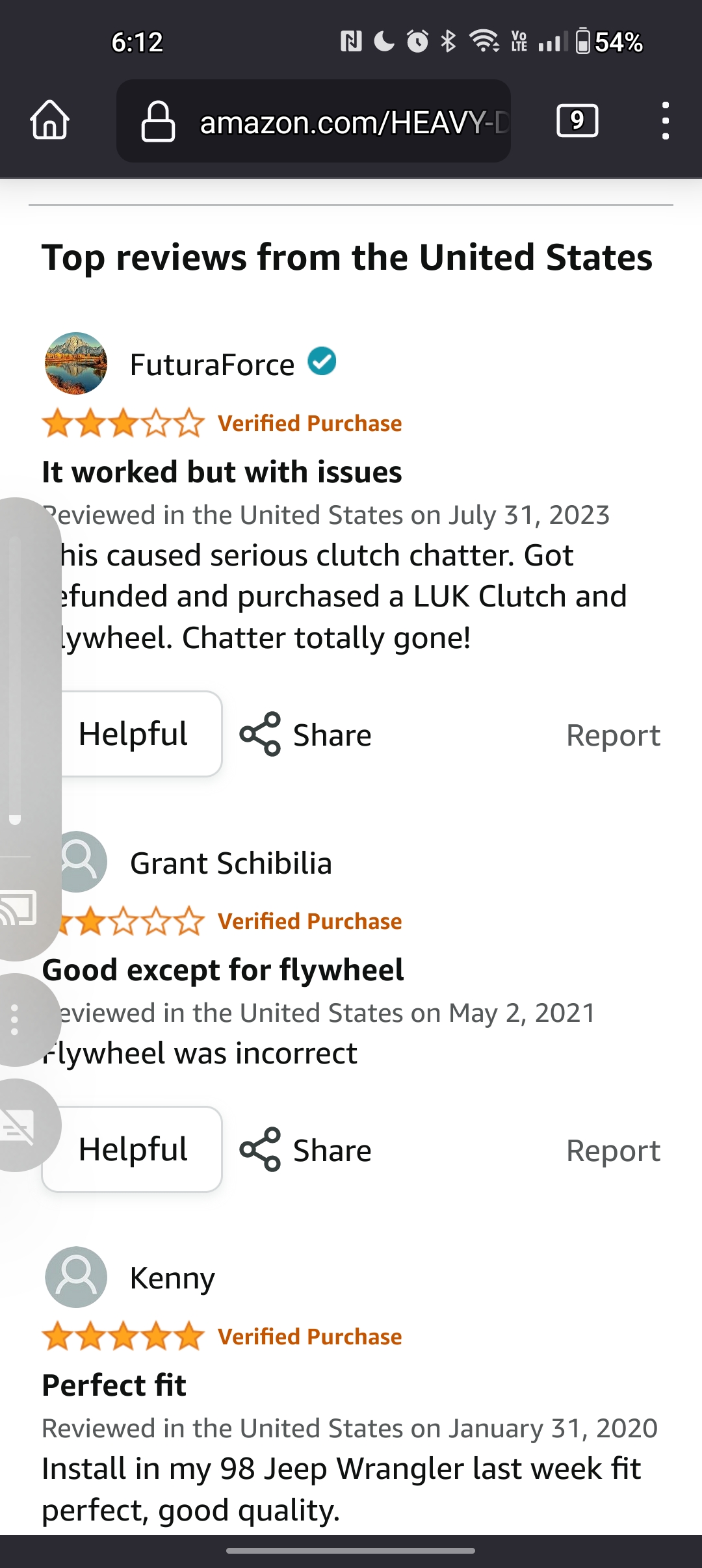

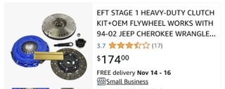

Brands of parts? We typically recommend Luk.
