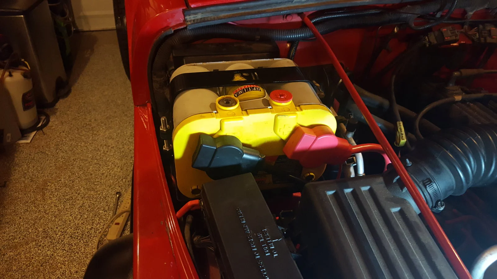

I am running Dual Optima yellows in my Jeep. I have them in a Rugged Ridge battery hold down made for the Optimas. I have had way better luck with my Optimas than others on this forum. I am also running dual Yellows in my GMC too. No issues with either of those either.
I do have a blue top in my tent trailer, and it decharges rather quickly, and takes longer to charge than normal in my opinion, but it is still kicking it. I am assuming my blue top will die before my yellows do. I have read others have had issues with theirs, but mine have been rock solid so far. Both my duals in both my rigs are over 2 years old each.
I also have a optima batter charger and the clamps broke on it. They are a plug in type module. I emailed optima and told them, and they responded that they will send me out new clamps, but I have never heard or seen from them since, so their customer service is yet to be desired.
76512
the other battery is mounted the same direction directly below this battery.
