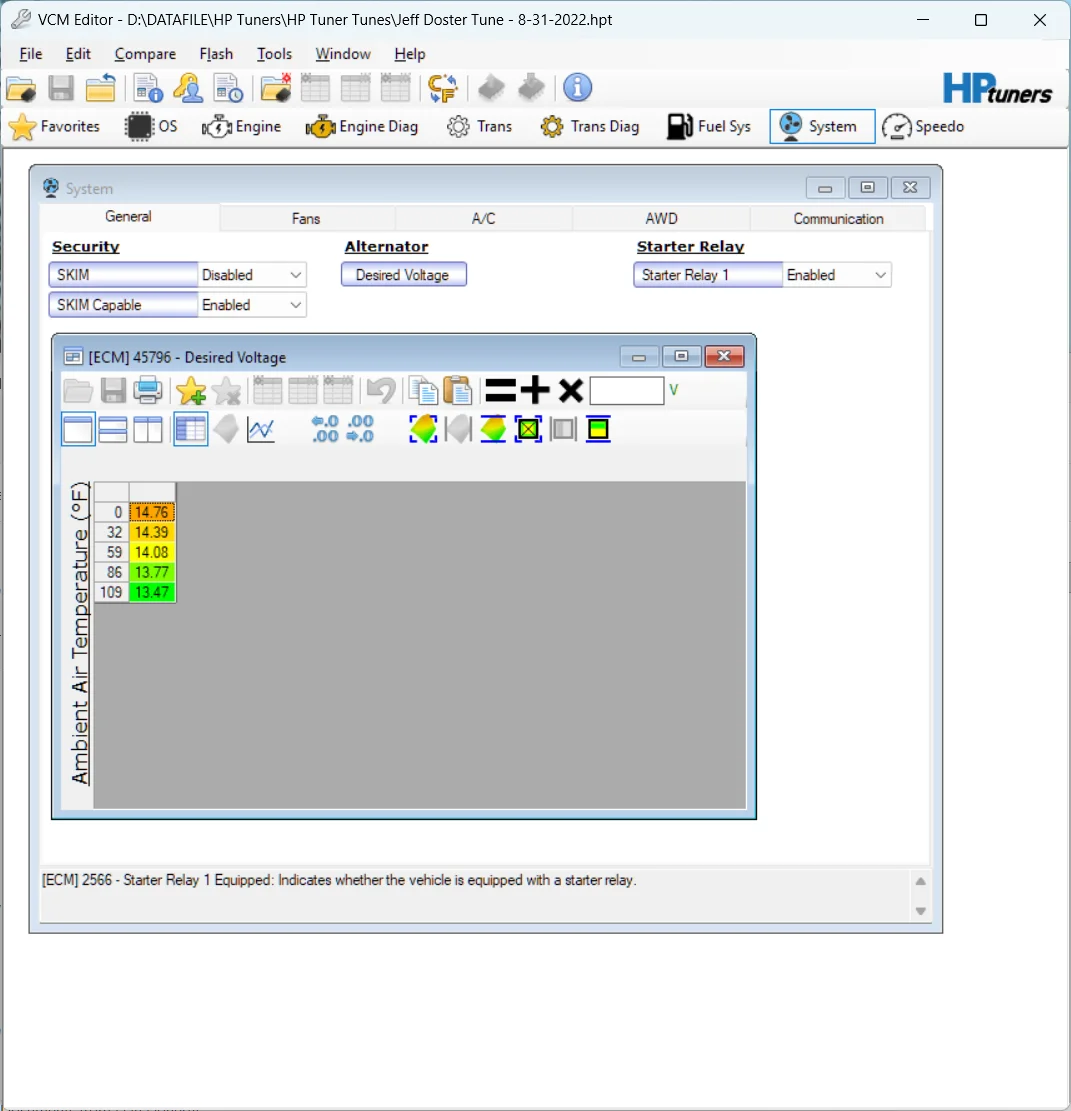

Can you post a screenshot in HP Tuners where you changed the charge voltage? I would like to bump mine up a bit in the 2000.
Here is the HP Tuners view for my Hemi, but I think the location is the same for the 4.0. Someone can check me there.
Under SYSTEM / GENERAL / Alternator: Desired Voltage:
I've been considering this change as well. I do run a battery temperature sensor, so the table should be relevant.
@Steel City 06 : Given your research here, can you suggest recommended voltages for my AGM?

I would start by setting the 109°F setting to about 13.9-14.0V and then interpolating in between that and the 14.76V at 0°F setting. (Just be sure to actually measure the output after changing it to make sure it's actually doing what you think it should be doing.)

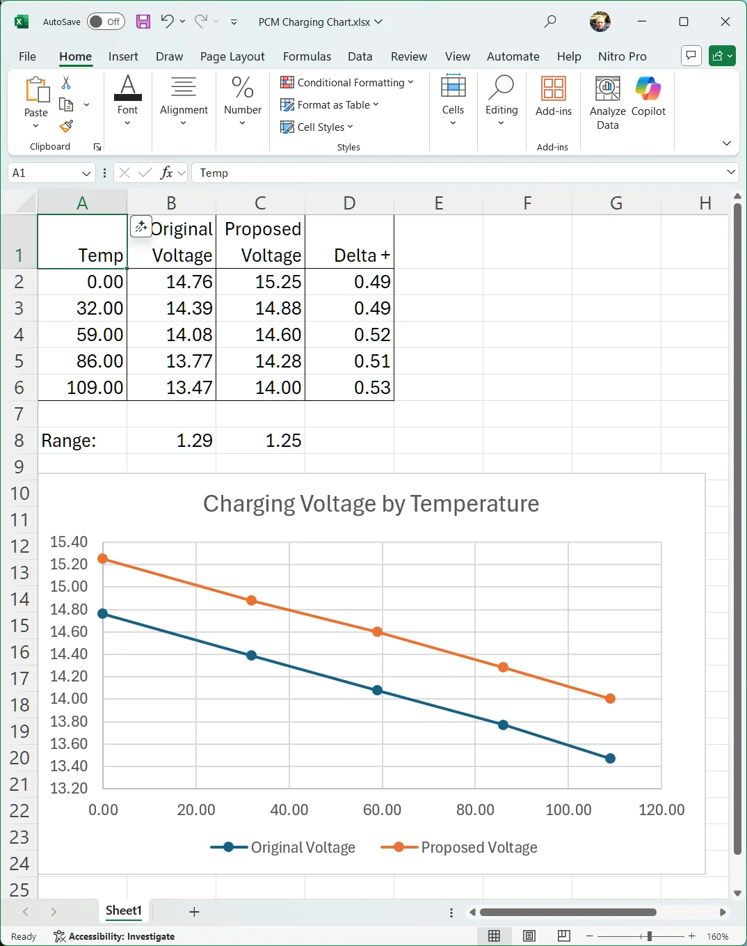

OK, this is fascinating. Doing a little research on this, Google's AI gave me this information on charging voltages for AGM batteries at a given temperature:

According to this info, for these PCM charging levels 77 degrees F is the reference point - meaning the point at which the target voltage is raised or lowered according to temperature. The values indicated are certainly more aggressive than the standard values in the PCM table on my Hemi.
From this information, I developed the following estimated voltage levels by temperature in the PCM table. The voltage for 32 degrees and 86 degrees come directly from the AI chart. The other 3 voltage levels I interpolated to get the charted line for the proposed voltages flat. The result is approximately a .5 volt increase at every temperature.
I have no idea yet if the PCM will accept these exact proposed voltages, but I may give it a try.
Does this sound reasonable? My question would be: Is the "Absorbtion Voltage" referenced in the AI information the proper target?
