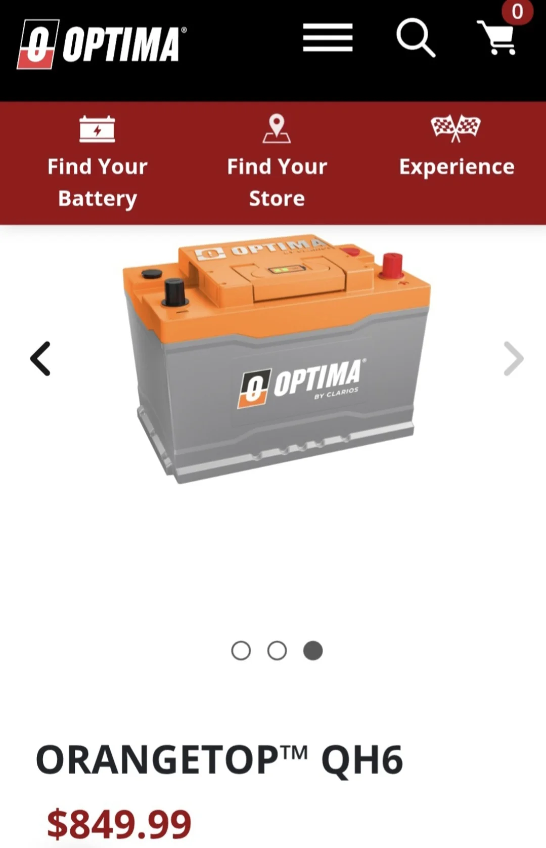

Or, at the rate things are going, lithium might be an affordable option.
"Built-in jump start (OPTIMA CPR) automatically disconnects your battery when it's being drained and reserves enough power to start your vehicle, and can be automatically activated with the OPTIMA Bluetooth app."
See @Zorba? If the battery dies you can give yourself a jump without leaving your seat! Just use the app on your phooooone....
Good idea, stupid implementation.
The other important part is it only weighs 20 lbs.

$850, are they high?
