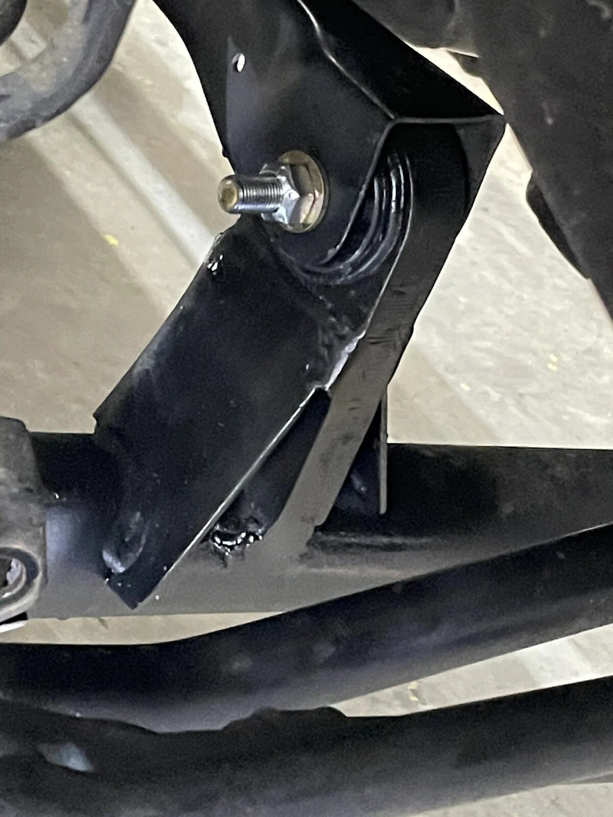

If the steering joints don't have obvious play skip right to the front uppers. Trust me, it'll make a big difference. Not suggesting you ignore play but if you can't find any I'd move on to the arms.
(sudden wobble is normally tire damage or throwing weights, the loose suspension just allows that minor damage to let things get out of control)
He is right.
I fixed one tonight with this-
Night and day difference.
