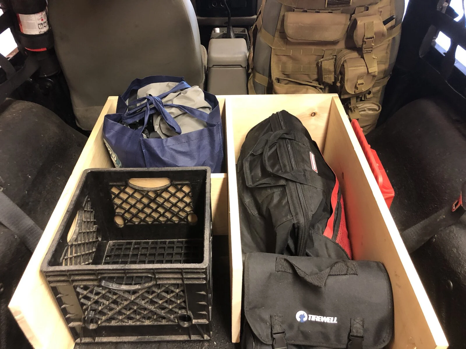

I'm working on a DIY rear storage system now. Same situation with the 2 dogs (45lb shepherd mix/60lb hound mix) so it needs to be solid. I've been looking for something that would work for them but didn't see anything that would work. I didn't really want to use wood, but I don't have the tools to fabricate a solid metal system. I built it to fit in between the rear seat brackets and level with the wheel wells to get the most area for them and storage needs. I also wanted the ability to remove it and put the seat in at times.
I have a 3/4" plywood deck cut for the top. It will extend to the tailgate so it can be "locked" with the tailgate along with some slide locks underneath. I'm going to try and hinge it and use a prop rod for when its open, along with trucked liner coating. Then I'll just throw some kind of large all-weather dog bed on top. I'll keep it updated as I build it.
