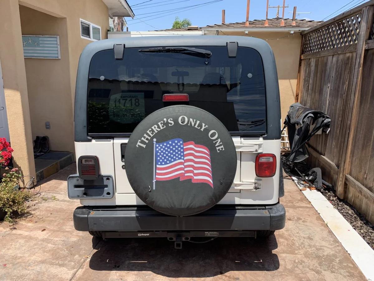

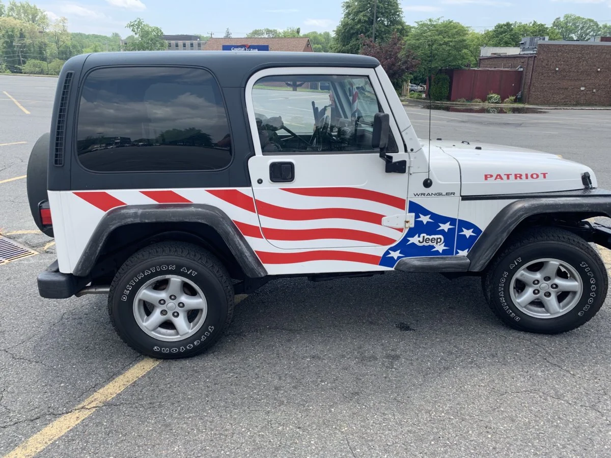

Photo 1- Bought in Conneticut
Photo 2-Transport
Photo 3- She is home in San Diego.
Don't ask why, it is a long story.

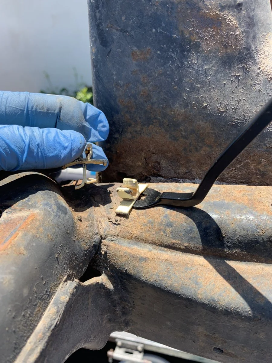

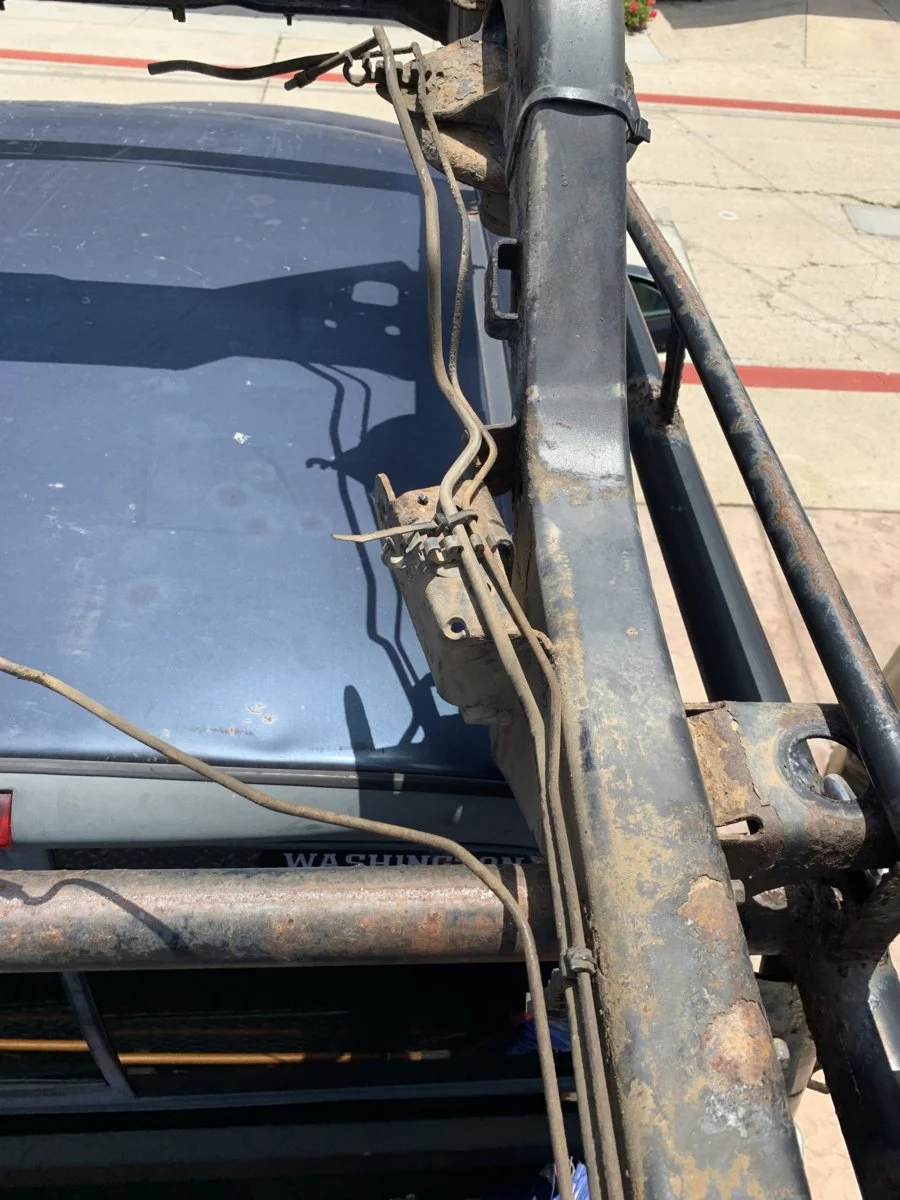

Phase 1- New frame bought in Long Beach and I am prepping for powder coat. Waiting on a few decision from the Wizard to decide if I will be doing any welding. Frame will be coated red and axles blue or vice versa. Old brakes lines, Bumpstops and exhaust hangers and any misc. bolts, that I am not sure what they were for, were all removed. Everything tagged and bagged and photos taken for reassembly. Only one snapped off bolt, not by me, needs to be drilled out.
I have no garage at my house so work was performed on the lumber rack of my truck.
Photo 1-3, Frame before removal of brake lines
Photo 4, Used a interior trim tool to remove the plastic brake retainer clamps

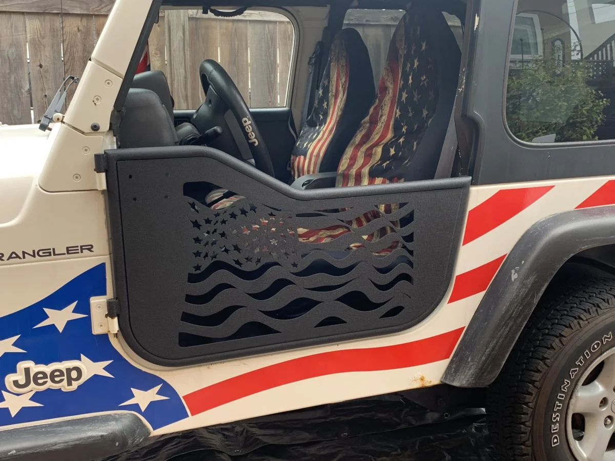

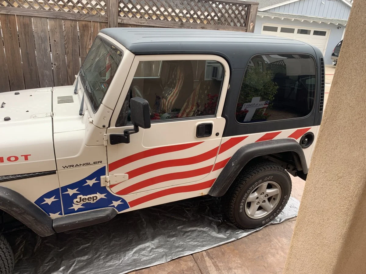

Phase 2- EAG American Flag half doors arrived and installed.
Photo 5-6, Before and after door install.
