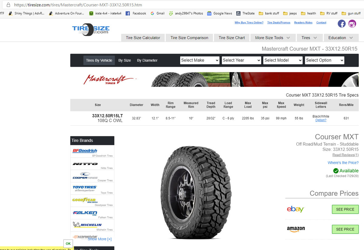

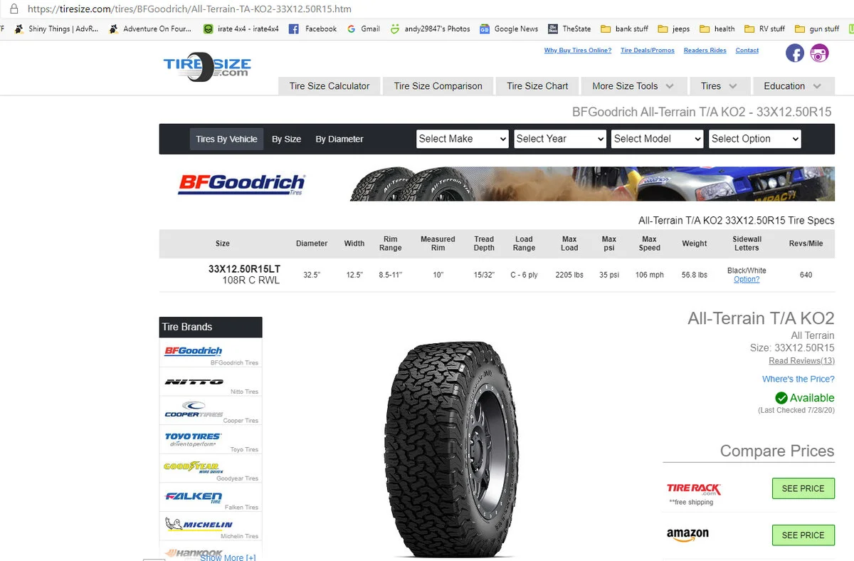

The most accurate way to measure actual tire size is revolutions per miles. I use this site to compare tires:
Here are 2 tires I have used on my Jeep.
That number from Tire Rack doesn't work with the Grimmjeeper.

Obviously the numbers they quote aren't exactly right, they list 32.5" which is 621 rev/mile and 640 rev/mile which would be 31.5" and it obviously ain't both.
Maybe they test it loaded. Regardless, if they do them all the same, then it is a valid comparison. IIRC, the 621 revolutions per mile that equals 31.5" is what started the closed thread yesterday. :)
