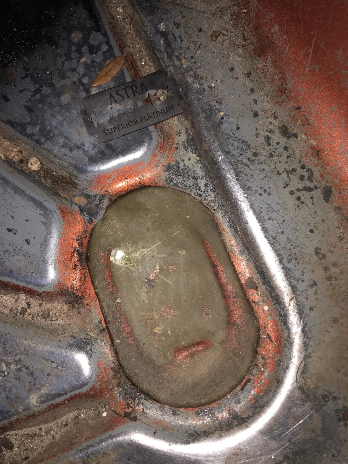

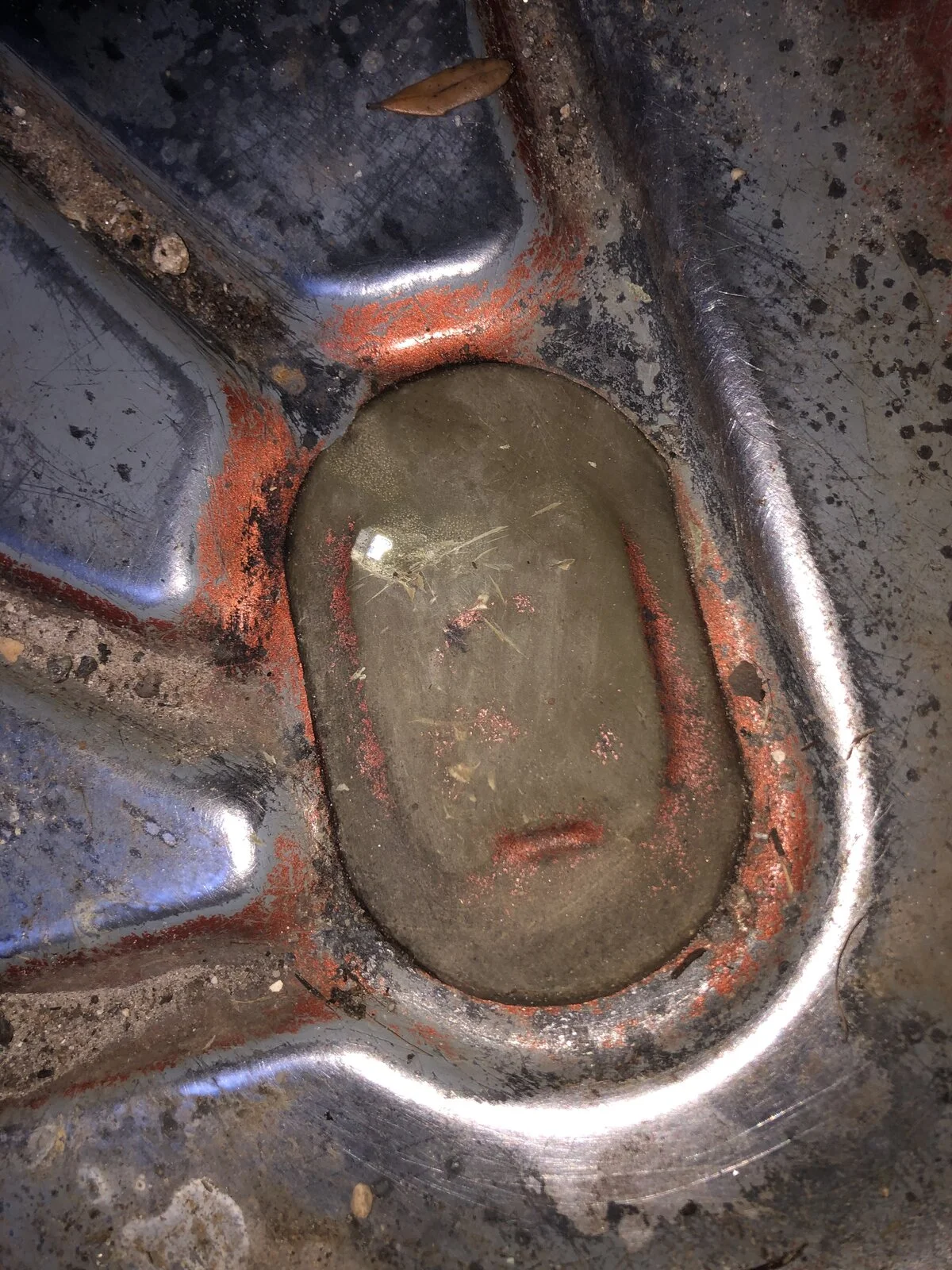

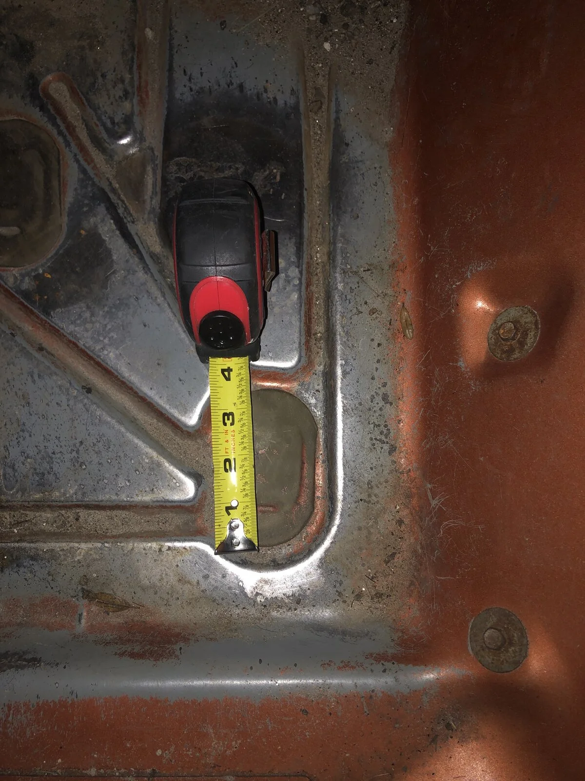

Are there any? Por15? Or what about fillet with primer? I’v attached a picture

Back to your original question about the plug. Is it possible the original floor is rusted out and you have a replacement floor pan over the old rusted out one? What does it look like from the bottom in that plug area?
I’ll check what under looks like but I highly doubt it rusted out given the shape of the rest of the jeep and the paint that was there looks real original. As long as I’ve had it there has been no carpet but getting in and out has rubbed the paint off that one section and I’m starting to see minor surface rust.
