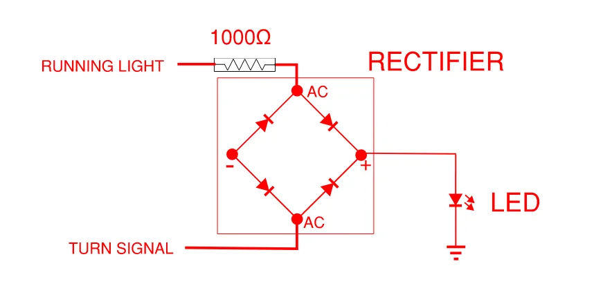

If they can't follow this diagram, then they probably shouldn't be touching their wiring at all, including adding rectifiers, and should probably stick to incandescent bulbs.
I don't see how a rectifier fixes the flasher relay issue. The LED is still very small load and the stock flasher wants to see the load of a normal bulb. If they have changed their tail lamps to LED already then yes, they are good to go, but for anyone just changing the front markers out they should need the LED flasher.
I understand how the rectifier works. As I said though, I like to use a bright LED so that it's bright for turn signals and not bright (dimmed via the resistor) as a running lamp. If you use the rectifier method, you are stuck at one level of brightness that is comfortable as a running light and not all that bright for turn signaling, or vice versa.
A full wave rectifier chip is just 4 diodes in one package. The 2 extra diodes aren't really required in this application since we're working with DC power as input. But you can just wire in the resistor into the running light input to achieve the dimming of the running light.

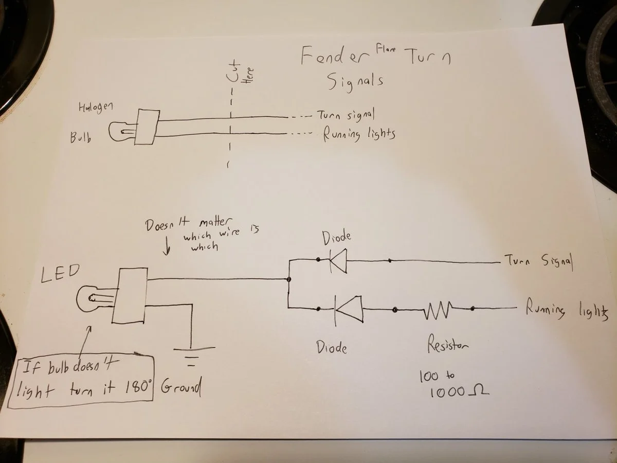

Do you have this bridge and resistor fully working on your Jeep?
of course, but not using a bridge. I have done the blinker mod to my Jeep and previous truck and helped a few others do it to their TJs and YJs.
It is really quite simple. All you’re doing is running the side marker at an artificial lower brightness using the resistor and letting the turn signal override it at full brightness. The diodes keep the two circuits from back feeding each other.

Electrically speaking that's a terrible way off doing it. A bridge rectifier is the best way to do this. No big inefficient heat generating resistors are needed or even a good idea.
Reactions: WestCoastDan
Electrically speaking that's a terrible way off doing it. A bridge is the best way to do this. No big inefficient heat generating resistors needed or even a good idea.
If you tried the resistors I use (tested for hours) they are room temp at the end of the test.
You might be confused on the types of resistors I am using.

I spent way too many years working in the electrical/electronics industry to go along with your method involving resistors.
You certainly have that choice. I will side with my personal experience because I KNOW for a fact it works. Using 2W resistors at 470 ohms, ZERO heat is generated after hours of use. It doesn’t get simpler than that.
Frankly this thread is ridiculous at this point. Like taking to a brick fucking wall. The guy asked for help and I gave 100% personal experience that has worked perfectly in different scenarios, vehicles, and for at least over a year and a half in one vehicle. Whether it’s personally worth it to you or not is one thing but refuting my suggestion when it for sure works is just nuts.
