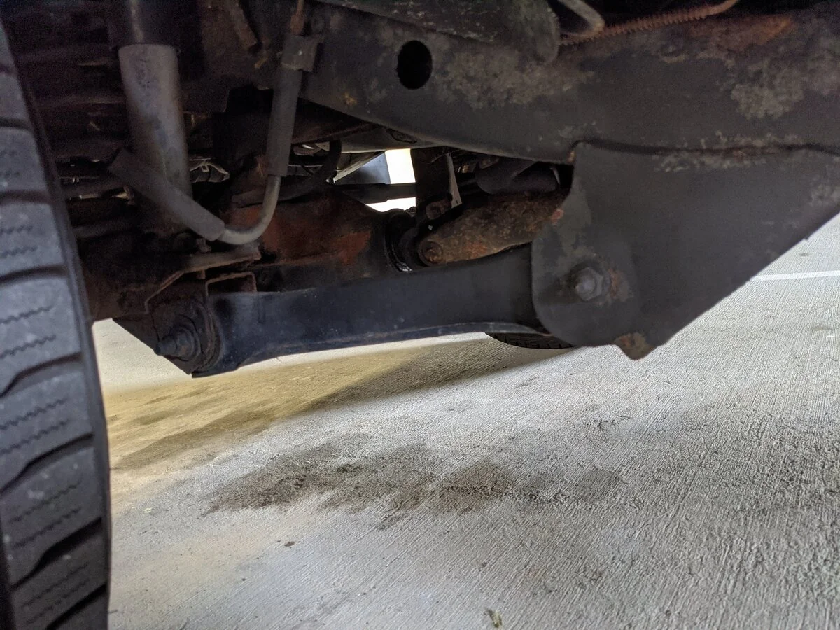

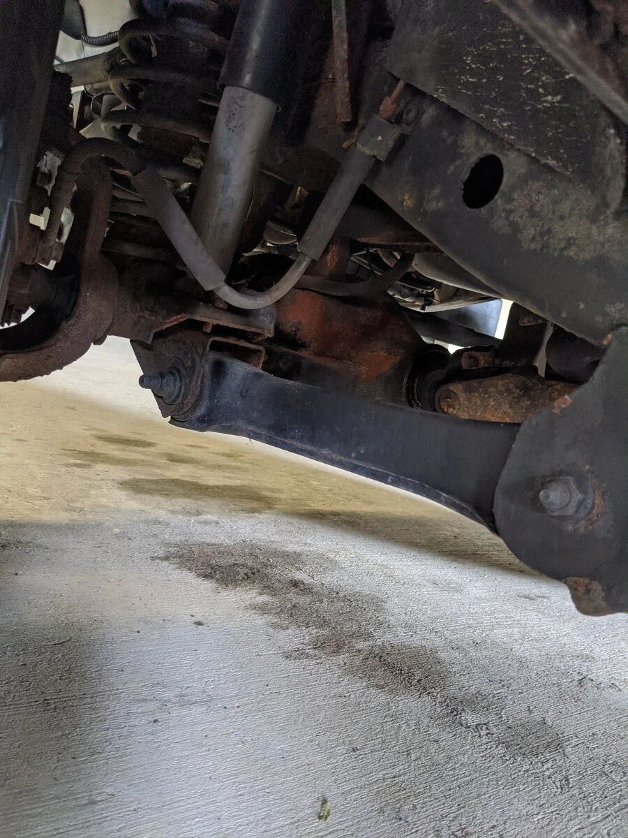

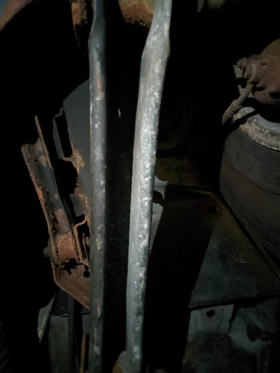

Post some photos of the control arm you jacked it up by.
Hey Chris, thanks for the quick response! Attached are some pics I took. I can def get some more
I don't see anything wrong with the control arm visually. Maybe a shot from the underside of it (looking up). That way we can see if it's slightly bent.
It's pretty crusty and may be binding and somehow affecting the steering but I can't think of how ... I'd spray it with penetrant good and see if acts right and also turn the steering with both wheels lifted and see if anything is obvious.
Thanks I'll try that!

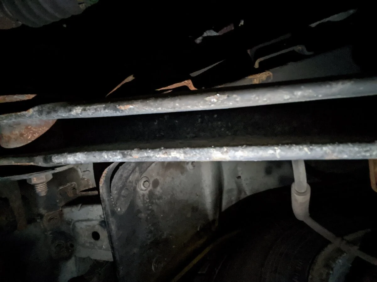

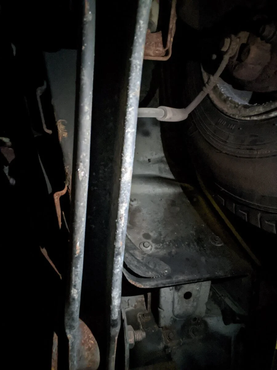

Here are some pics underneath of the control arm.
I'll def hit it with penerant and get it up to turn the wheels. To see if I notice anything.

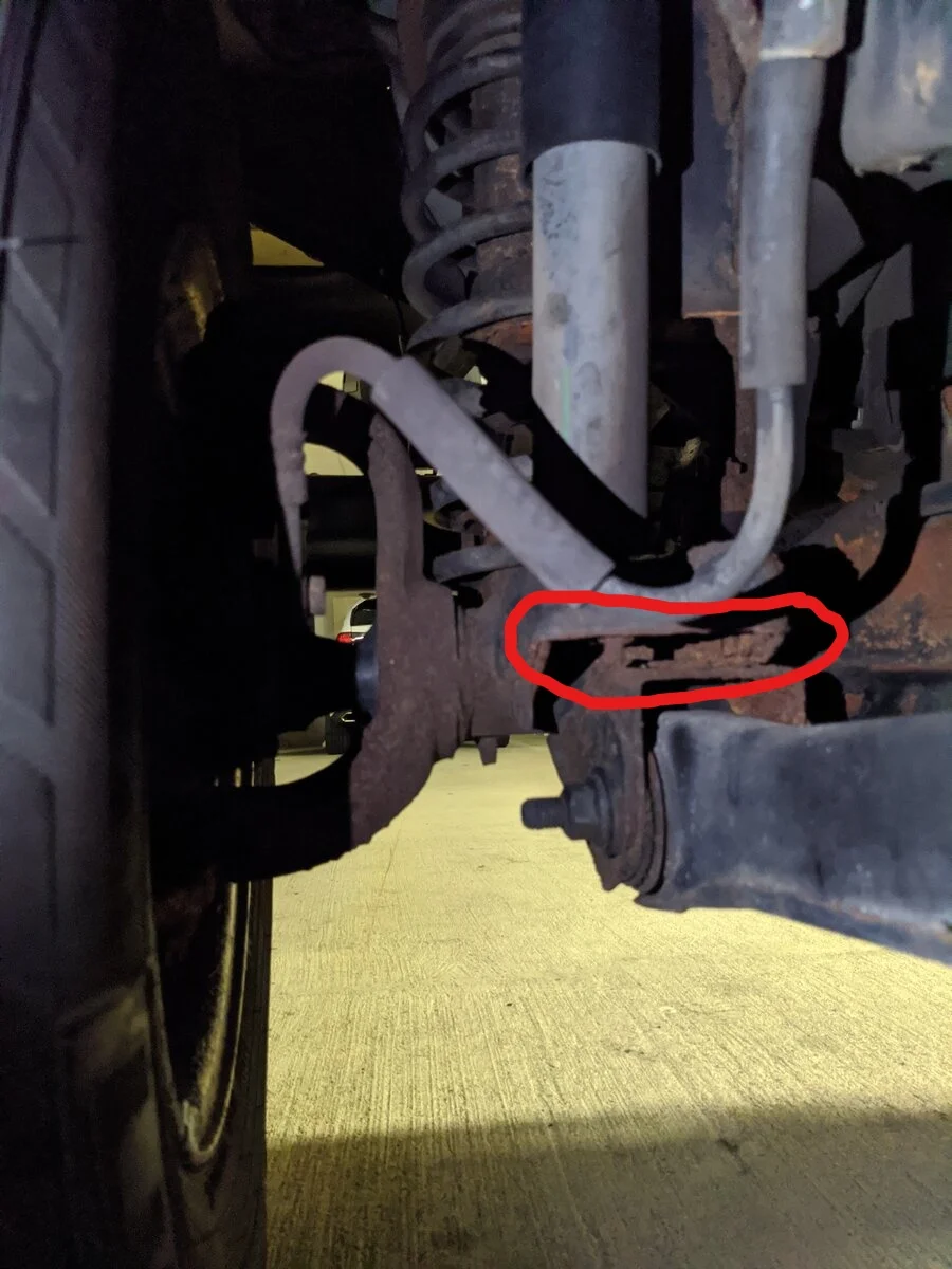

I can't tell for sure, but is this secure? It almost looks rusted/broken. I'd go look at mine but it's pouring rain and my Jeep is out in my workshop.

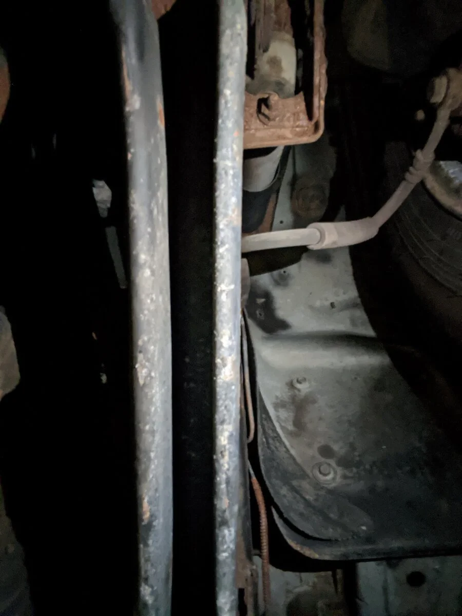

In your 4th photo within post #6, it looks like your UCA is broken off. Or is that just the shadow?
