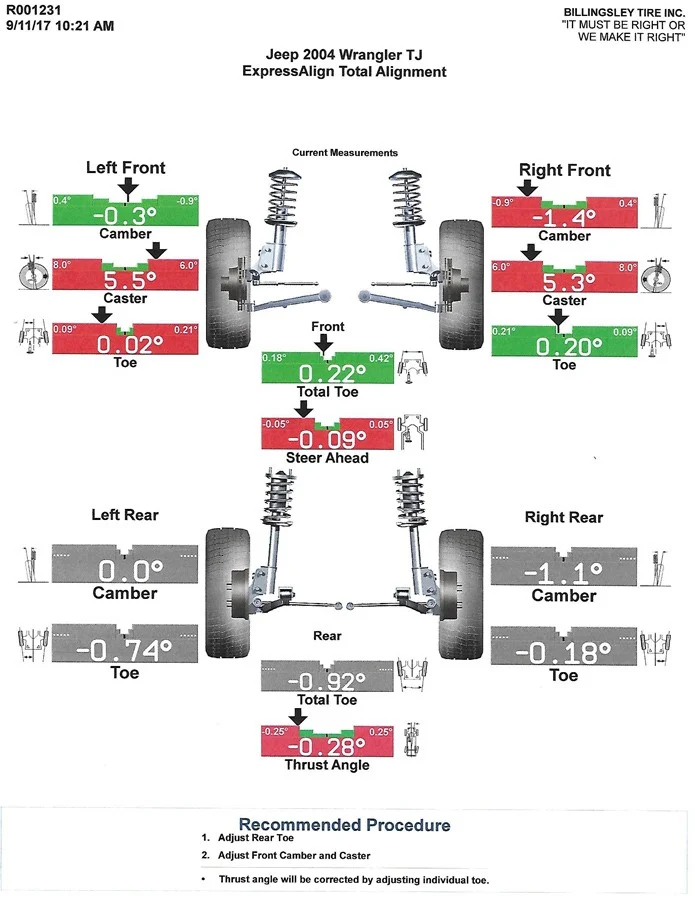

The results from the alignment check. What does everyone think?
