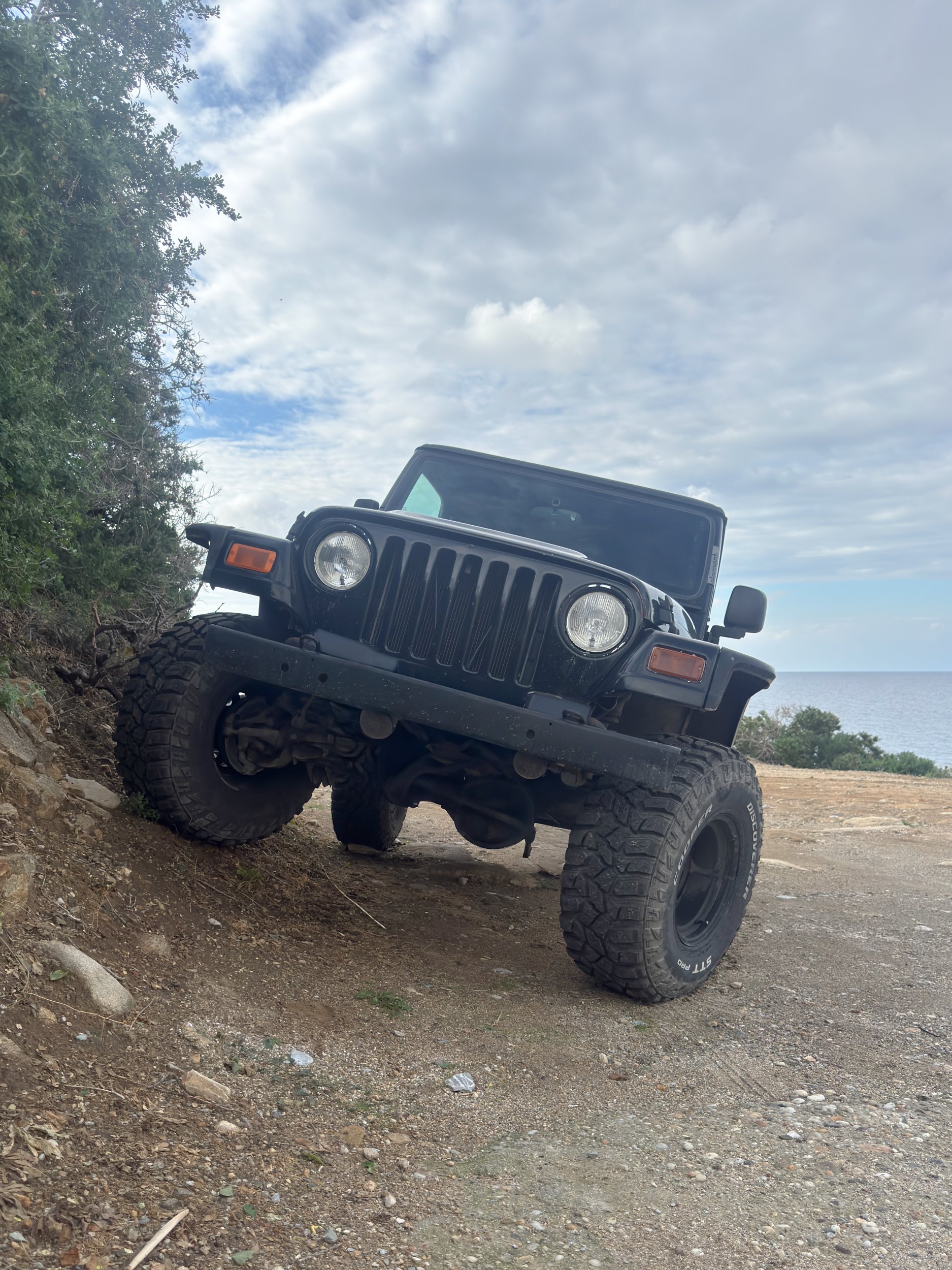

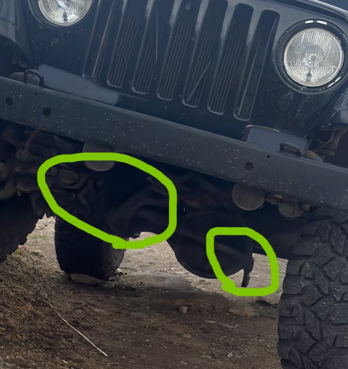

Post pictures of the front shocks. I'd replace all the shocks with better, correct length ones and go from there.

1) you need the proper length shock for your suspension lift amount. Spacers affect lift amount. Usually a small spacer to dial in your lift amount is fine. Unsure if it will help to remove the spacer. EDIT: after posting I saw your pic. That’s not a small spacer. You should get some springs that get you close to the specs below for 33’s).

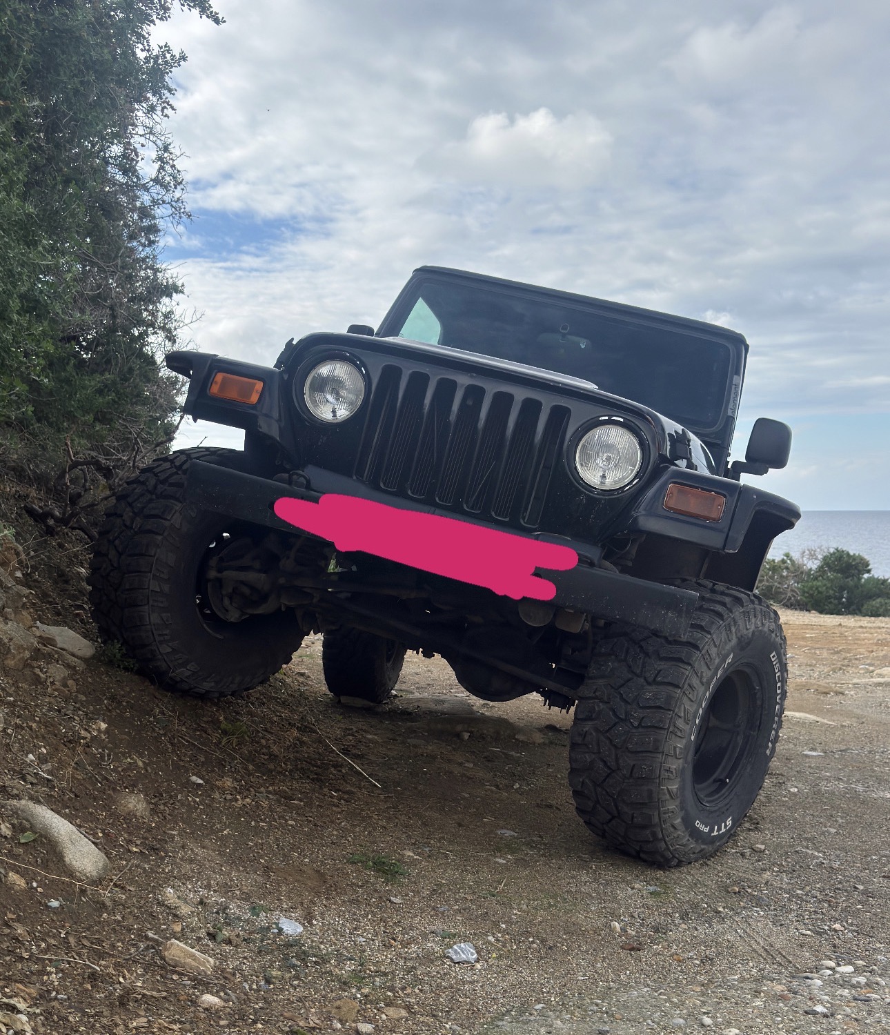

PS. The photo is actually this, but I don’t want my license plate to go around in the internet haha
