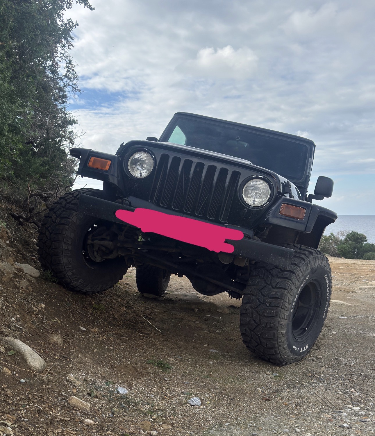

Right now, the front suspension barely moves up or down, even at low speeds. Based on how it behaves, I strongly suspect the front springs are already preloaded because of the spacers, which leaves almost no usable uptravel. It feels like the suspension is sitting too high in its travel and is constantly topped out, which would explain why the front end feels so harsh and unresponsive. That’s why I’m wondering if temporarily removing the front spacers would help restore some suspension movement and make the Jeep more drivable until I receive proper springs from the US (shipping usually takes 30–45 days for me).
For reference, I’m running 33” tires at about 24 psi. I’ve already experimented with tire pressure and higher PSI definitely makes things worse, so I don’t think tire pressure is the main issue here.

PS. The photo is actually this, but I don’t want my license plate to go around in the internet haha
Read the responses. The ride quality is not effected by the springs or spacers, stop. Measure and replace all four shocks. A set of Rancho 5000 will suffice for quite some time but I believe they don’t last long enough with what I do to them. That said I do not have another shock recommendation.
