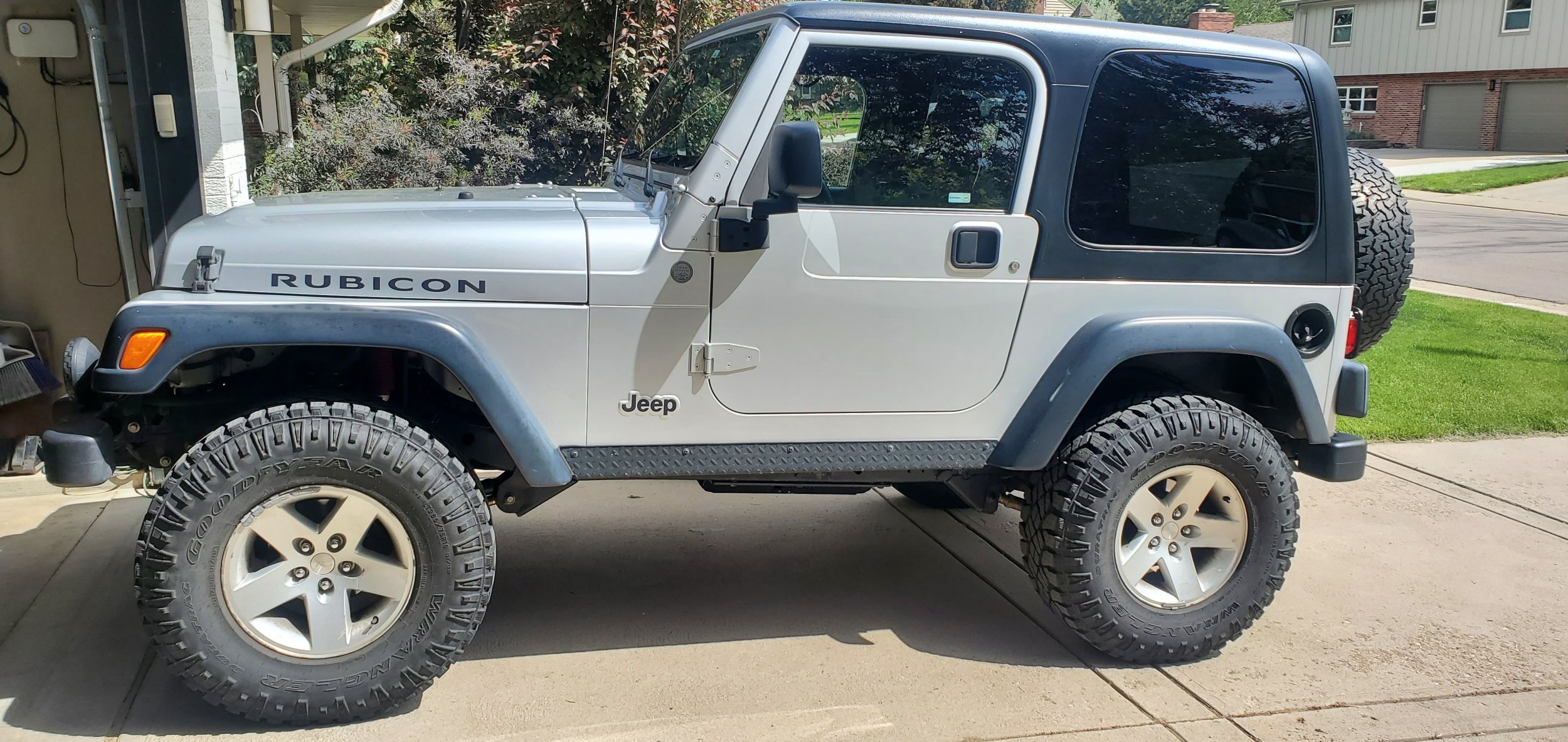

Thanks a lot for taking the time to write such a detailed response — I really appreciate it. We’re definitely on the same page. I also don’t quite understand why spring rate tends to get dismissed so easily. In various project cars I’ve worked on over the years (from drift-oriented builds to off-road setups), spring rate has always played a meaningful role in the overall balance together with damping. That said, your explanation about the TJ’s packaging constraints and how that naturally shifts the focus toward shock travel and valving makes total sense. Solid perspective, thank you.
PS nice ride by the way 😁
