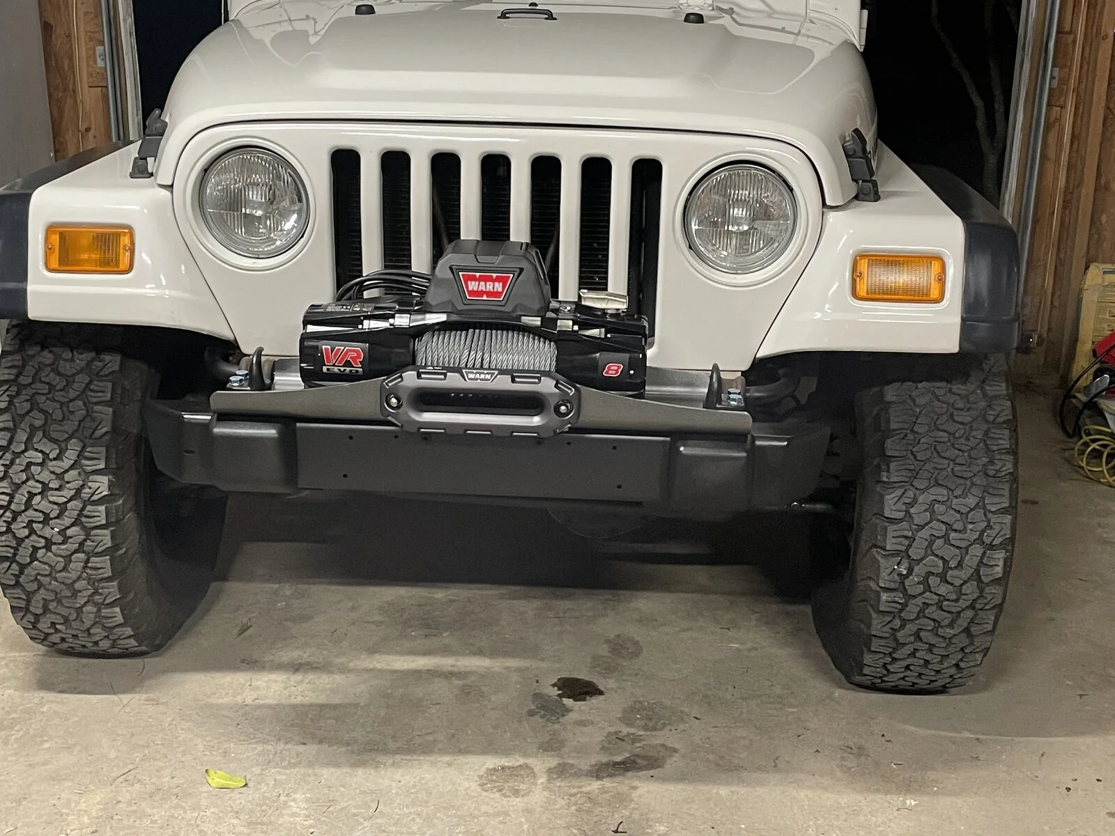

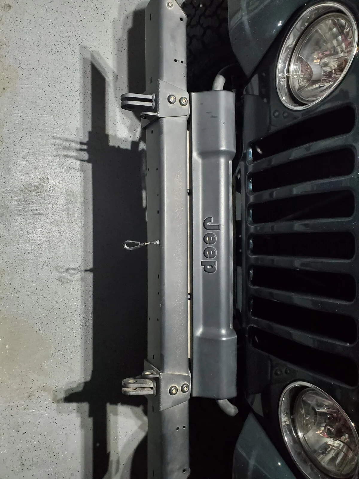

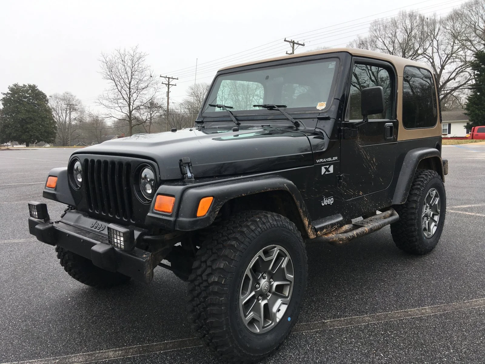

I see a lot of TJ's with this stubby front bumper, it looks like the stock one just with the edges removed
Am I correct in assuming I can turn my current stock bumper into this, do the edges just bolt on/off or will I need to cut them away? Ideally I want to keep the original parts in stock form for resale one day.

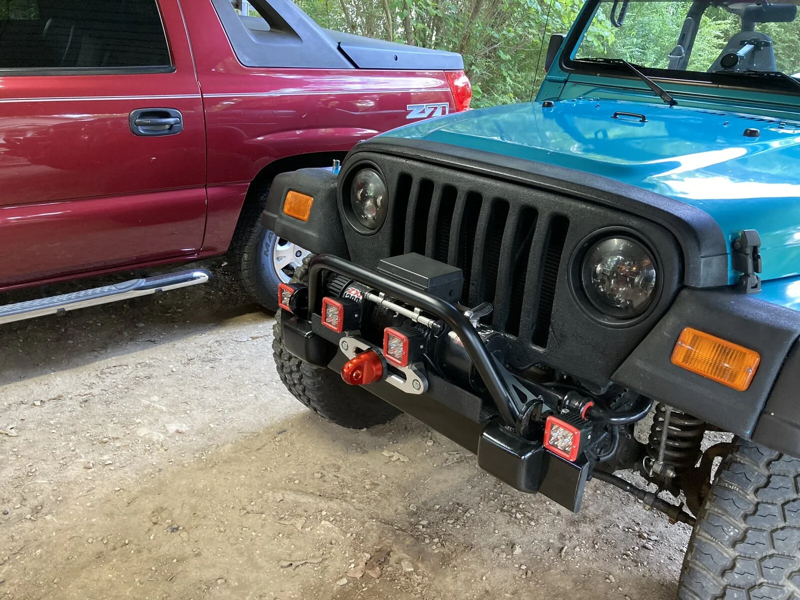

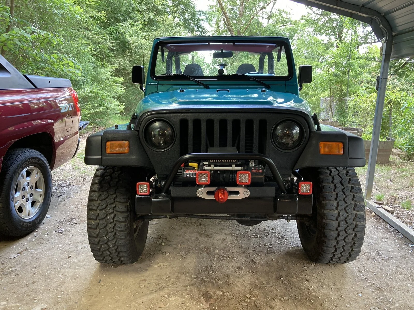

state side we have the "milk" jugs as the end caps first pic- second pick is what it looks like with out. I wonder if under your cosmetic plastic if that bumper is not the same? you might just need to do a little exploration.
Reactions: RINC

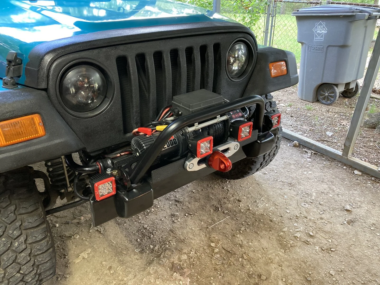

That looks good, it looks like the front was folded back and welded with some good technique and skills.
Thanks Jerry coming from you that means a lot- That’s exactly how it was done- And it was done by a guy that has just been a dear friend for decades, One of those people that you’re so glad you have in your life.
I really love the look of the aluminum bumpers but I’m not as crazy about aluminum with a white vehicle I think it looks so much better with the darker colors and reds.
Do you know if you have a similar stock bumper behind the those front fairings?
If so, you can leave it as is.
Or add flat plastic end caps for a more finished look.
Or modify it more by cutting it shorter, the stubby look.

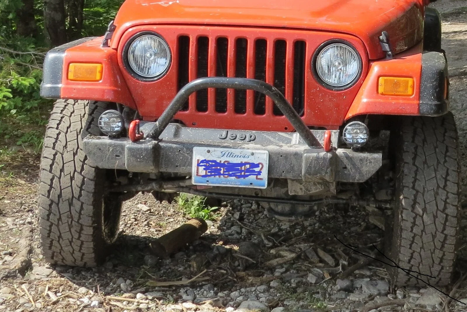

True. Trying to achieve the stubby/ mid width without buying a new bumper only up have to rethink my flat tow setup that's worked so well.
May just cut the ends down 3-4", replicate the OEM angles and reuse the angled end caps. That (and a fresh coat of paint) should do the trick. 🤞

I’m in the house now and the Jeeps in the shed at my in laws- glad to measure in the a.m. - the angle starts at 1.5” from the pads if I remember right, those little factory oblong holes are a giveaway too- it 45’s back (I used a carpenters speed square) and the slant at the ends was due to the the bumpers stock dimensions- it was all done in a couple of hours- angle grinder and welder, while on the Jeep.
