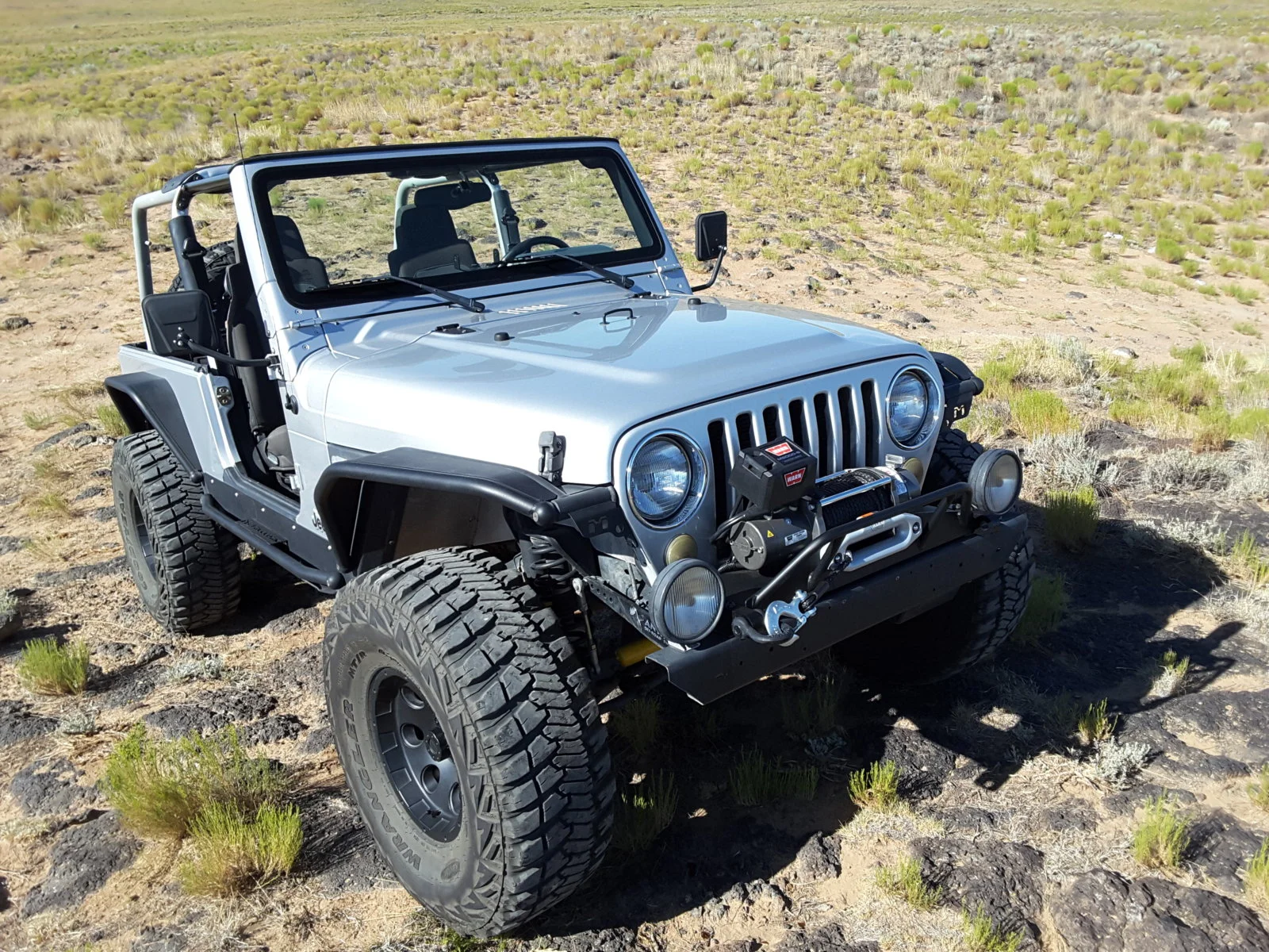

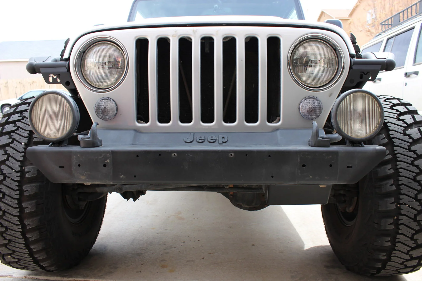

I cut my stock front bumper down to 46" when I went to 35's. There are plenty of places in the Southwest where I can stick my front tires up against rocks and, while my bumper is a little long to be considered a true stubby, cutting a bit off the ends has allowed me to take lines I might otherwise have had to pass up to avoid damage to the bumper (I'm not too worried about damaging the MC Overline fenders, aside from scraping off some paint every once in a while).

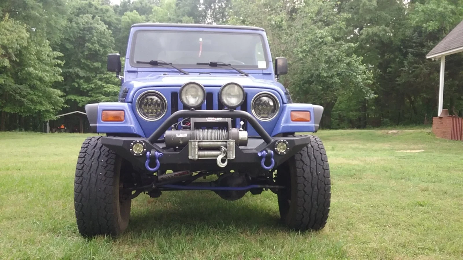

Here is a pic of my front bumper. So I am wondering is there is a benefit to a stubby bumper. I was thinking about cutting this bumper down to make a stubby bumper. Is there are real benefits to a stubby bumper. I'm not really a fan of the long bumpers but if the benefits don't outweigh the current setup i will leave it as is. View attachment 28360
