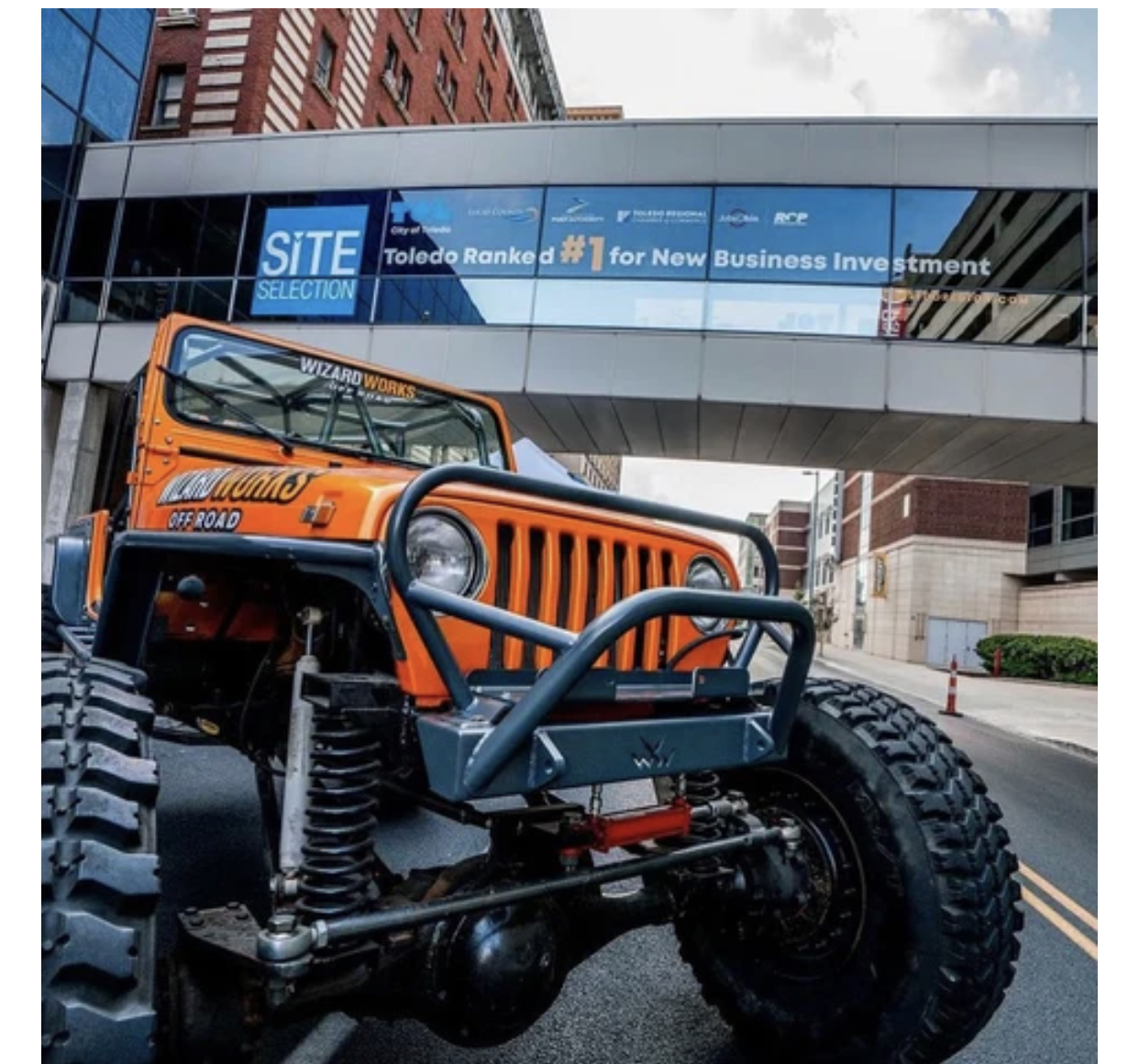

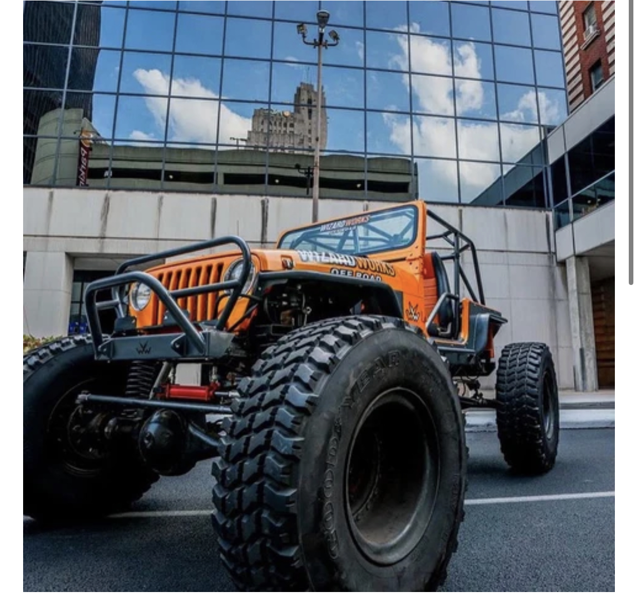

Actually just found this one by wizard works which looks pretty good
https://wizardworksoffroad.com/products/stubby-bumper-with-grill-hoop

The Wizard Works bumper is ugly.

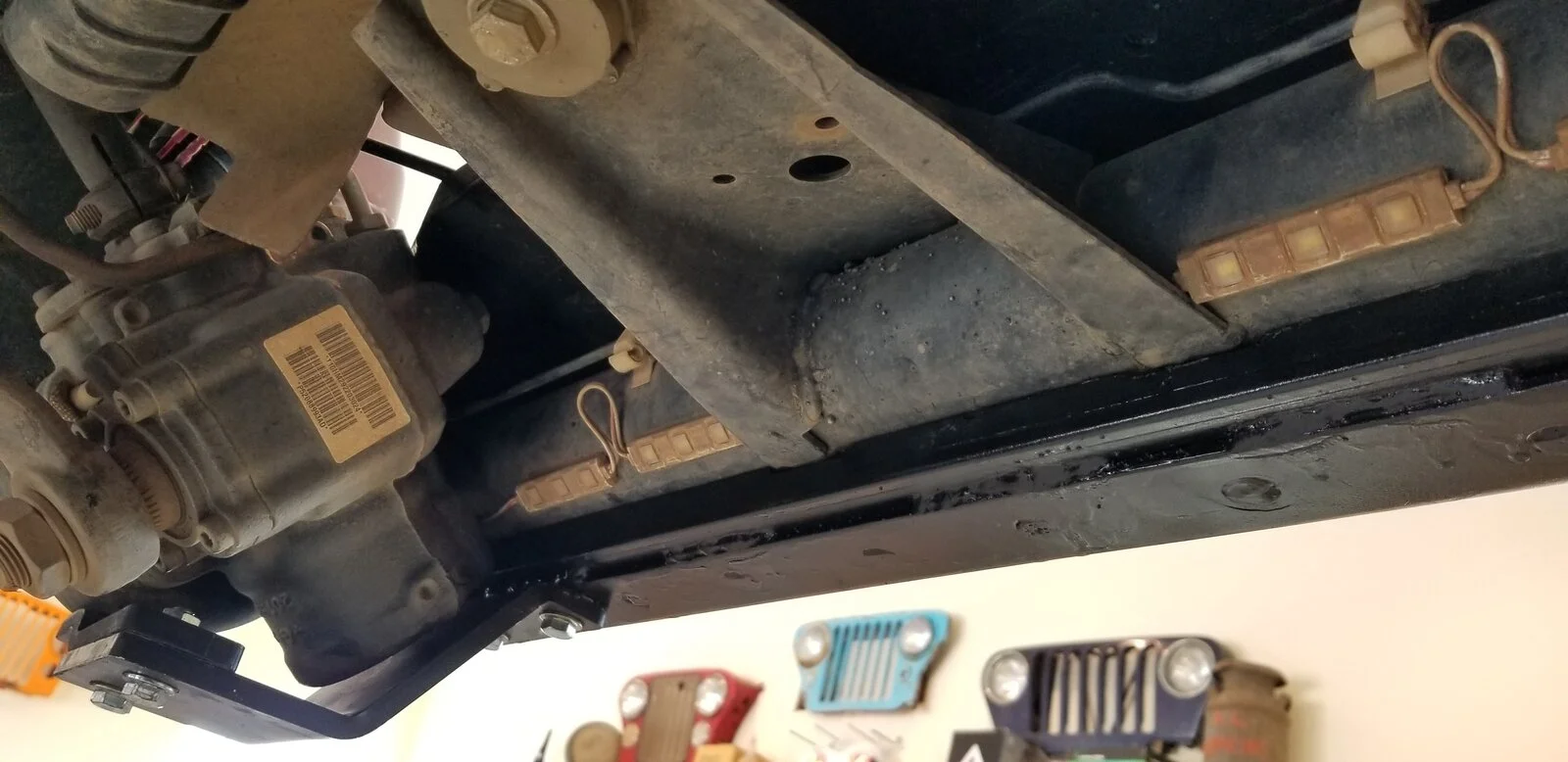

As was said, the UCF high clearance bumper wouldn't be one of my choices either. It lacks a number of desirable features, including not taking advantage of all the available mounting bolts. As seen here, you get two up top on each side.

All those exposed welded sharp corners at the sides of the UCF lost the heat treat. The Savvy design was formed the way it is to reduce the amount of welds. Then the hardcore corners are there to reinforce the welded corners. The corners were intended to be a non-optional part of the bumper, not an extra add on.

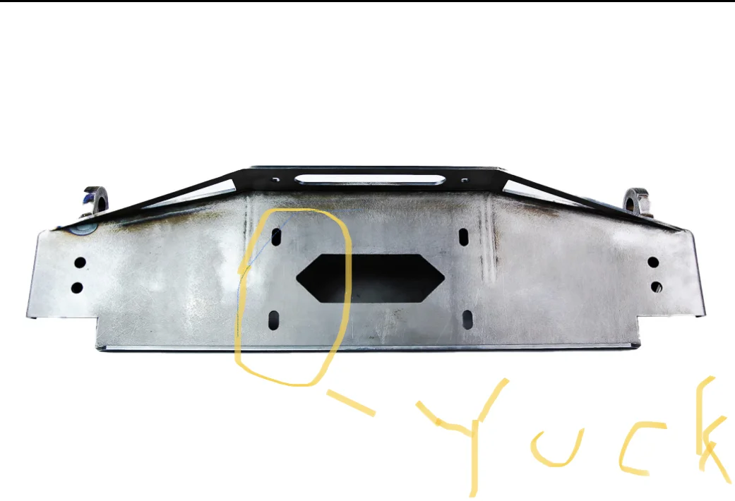

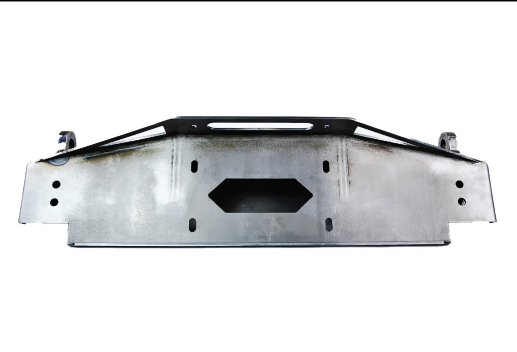

So is a hole stronger that a slotted hole ? Would the reason be since a slotted hole is bigger and leave wiggle room for it to slide around and make itself bigger ?
Anyways, gotta go to bed take care you guys✌🏼
Pretty much every winch uses the same bolt pattern so there is no reason to make the mount adjustable allowing the possibility of the winch moving under load or flex in the deck which is very bad. As long as the bumper manufacturer makes sure a Warn Zeon fits (they are one of the portliest winches out there) every other winch out there will be fine.
