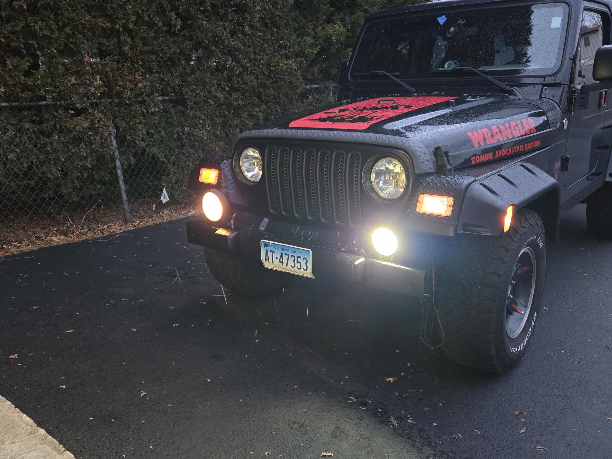

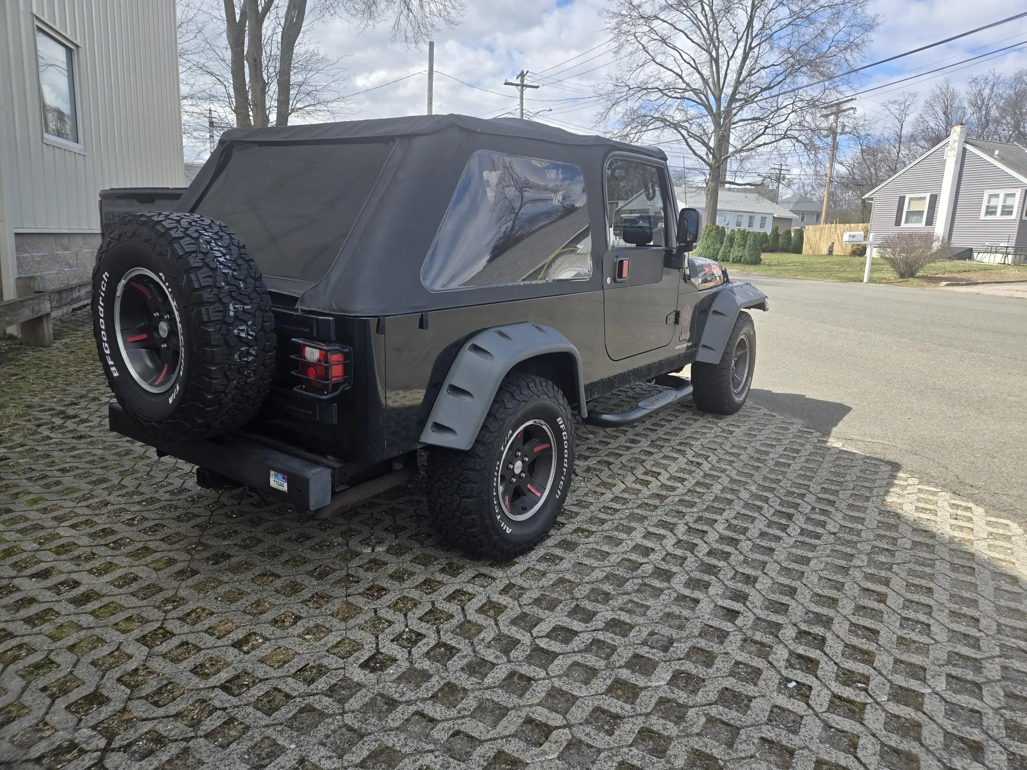

I run 31's on my stock ravine rims, 15", JK springs up front, and a 3/4" leveler in the rear. Had to slightly adjust the turning bump stop, as the tire would rub the front sway bar on turns. Street driven LJ. It has good street manners, even on the highway. Low cost as well.
You live in my home state. I was in Enfield. Do they require full tire coverage in CT?
