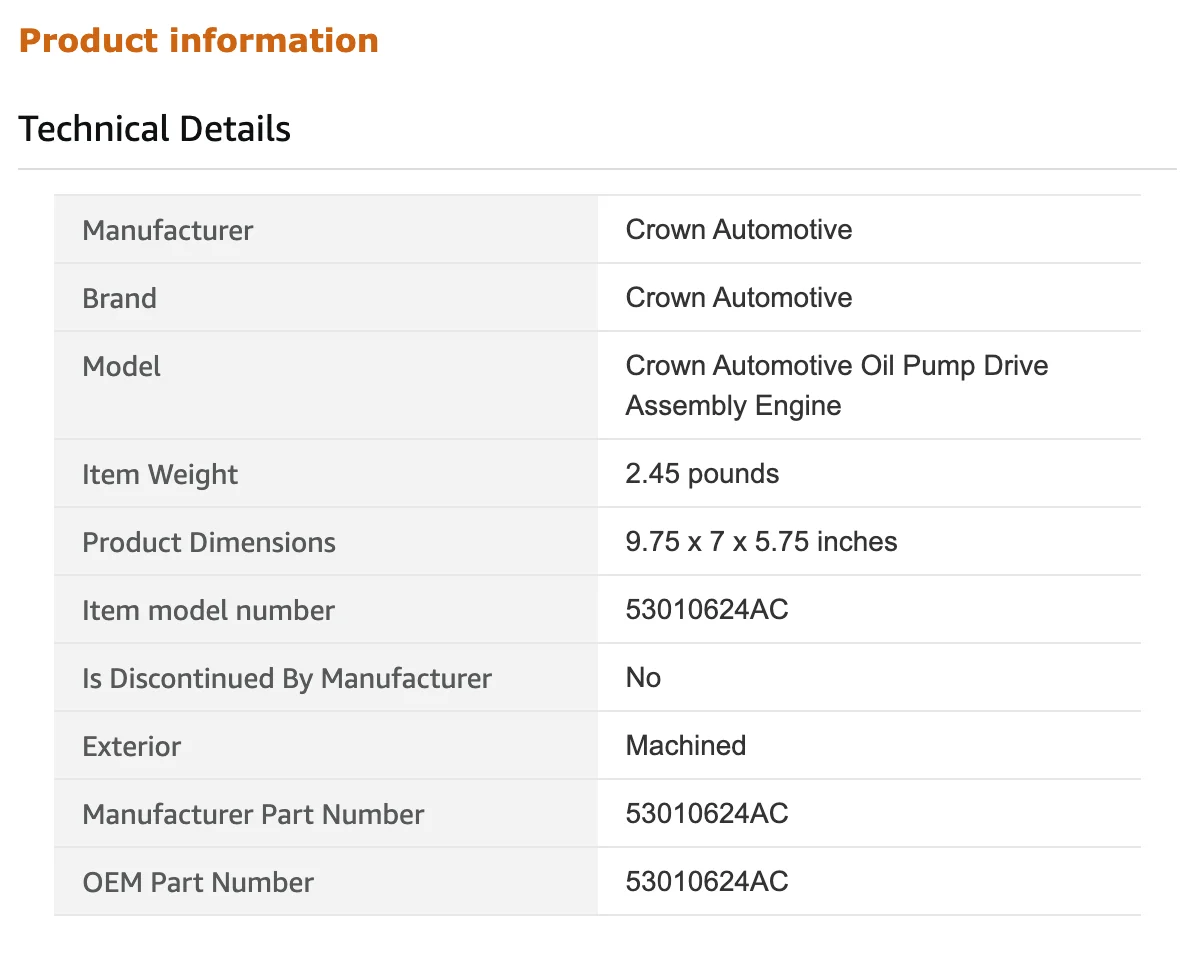

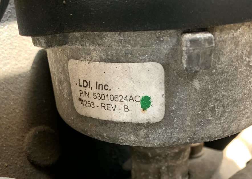

Sorry for any redundancy, I am getting ready to do the same preventive maintenance on my '05 LJ. I just want to verify I am ordering the correct item. I currently have the "LDI 53010624AC-4253-Rev B" OPDA installed. (picture below) As I understand, this is the original (faulty) unit.
The Crown ‎53010624AC (specs below) is the correct replacement for my '05 LJ. It is a little confusing since they both have the same base part number. (53010624AC)
TIA for any clarification!
The crown unit is the one you want. I wouldn't worry about the parts number.
Thanks for the response! Definitely keeping the old sensor.

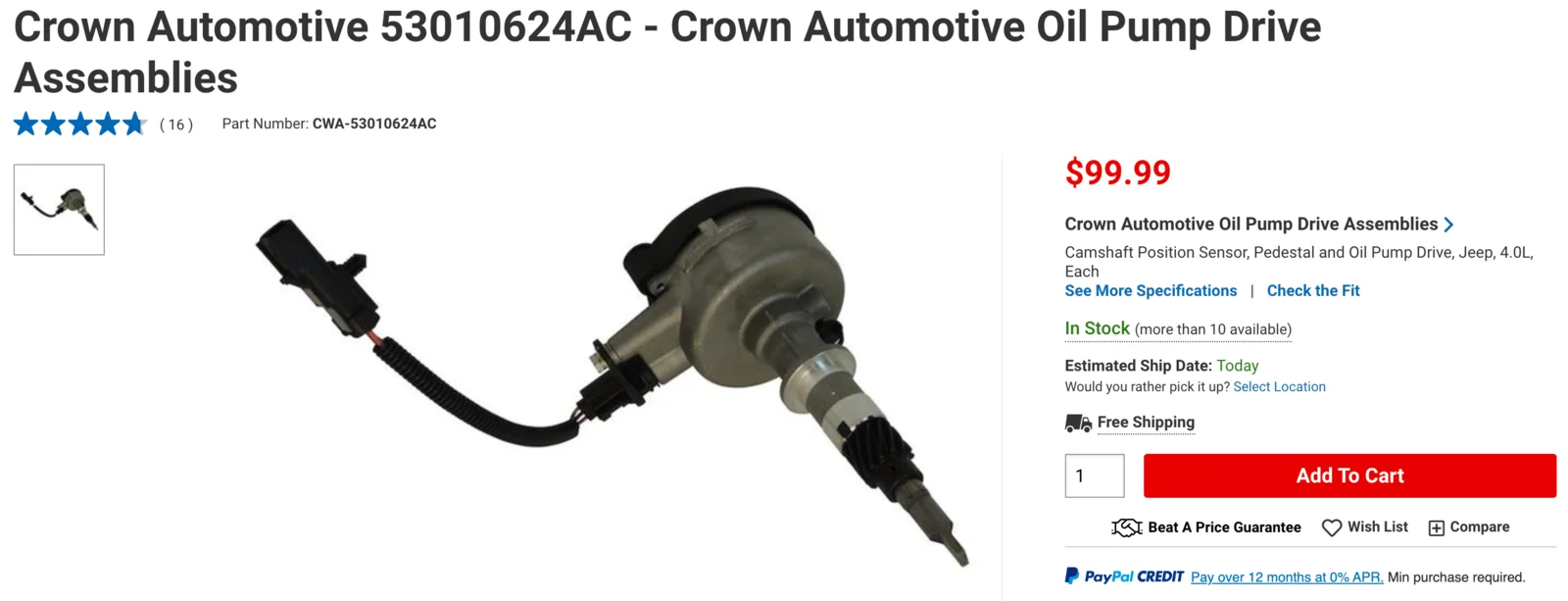

Getting ready to order from Summit Racing. Seems like they have the best price at the moment. Any experience with Summit, good or bad?
