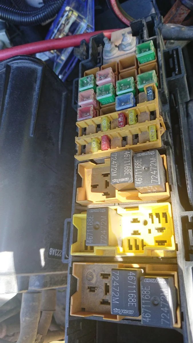

My fuse relay box looks different

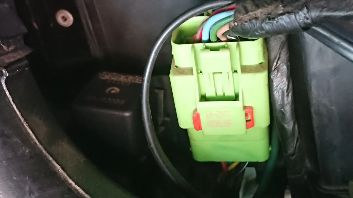

The relay clicking away is behind glove box in picture and the main relay/fuse box under the bonnet is different to the pictured one in the attached thread?
